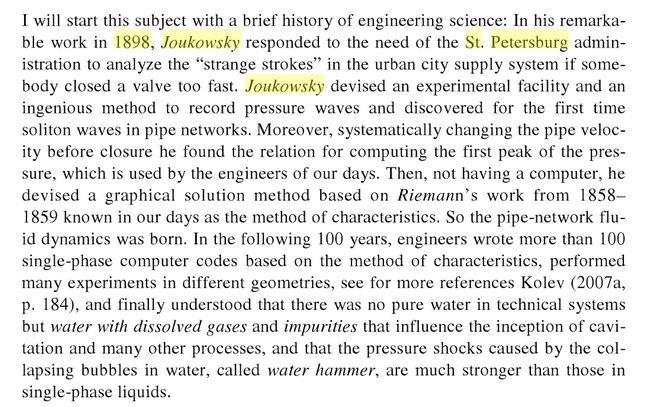

        I never had an equation for calculating the hammer pressure, AND it's a really simple one. Thanks.
          One source attributes the discovery to
