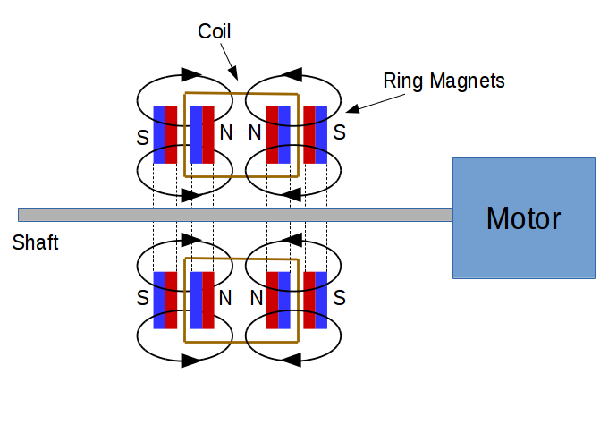

    Hi Guys,
    When reading https://en.wikipedia.org/wiki/Homopolar_generator
    Homopolar generator
    Originally posted by madMAx4 View Post
    Hi Max,
    If I read your diagram correctly, the net flux cutting the coil is zero. Therefore zero voltage.
      Yes, according to Faraday's own law of induction there should be zero voltage.

        Hi Max,
        You missed my point. Even if you could somehow keep the magnet rings stationary, you would still have a net zero flux cutting the rotating disc (can you still call the rotor a disc?). In other words, an equal amount of flux cuts the conductor in both directions therefore cancelling induction. There needs to be a flux return path around or outside the armature (conductor or disc). This has nothing to do with Faraday's paradox.
        {edit}
        Notice the back iron in this diagram from your wikipedia reference.
        The magnetic path or circuit is completed outside of the rotor space. I think (but not sure) that would be the case with the Faraday paradox also.

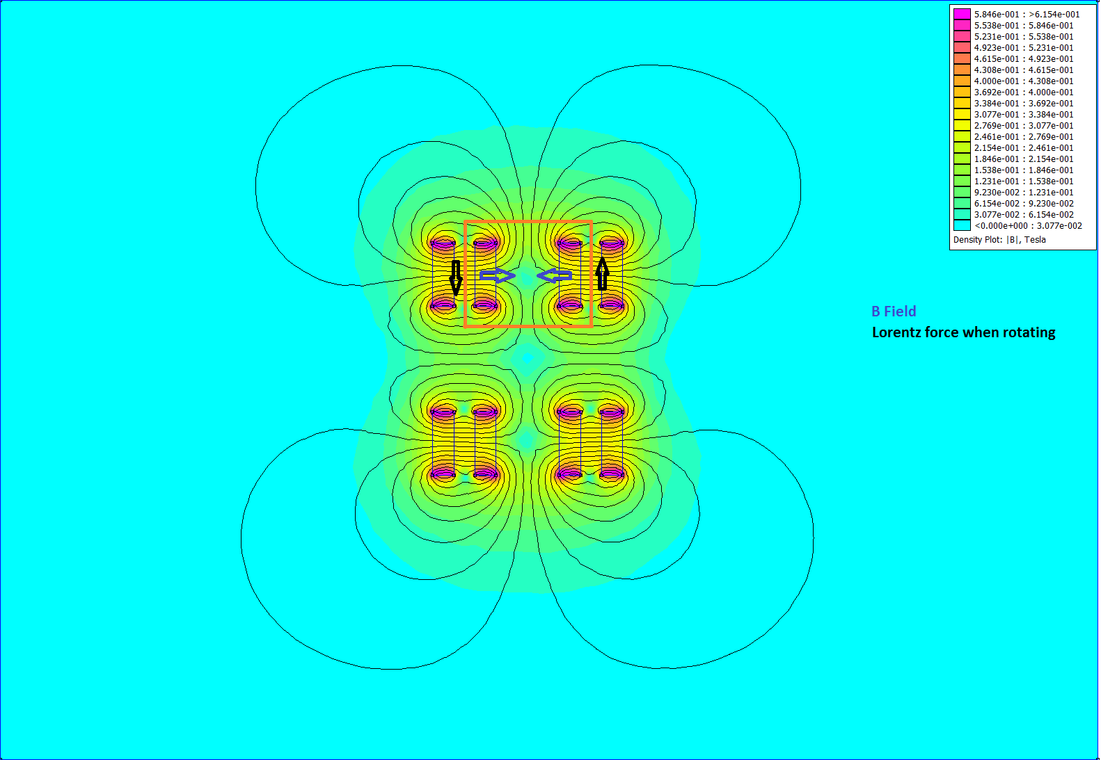

              Hi Max,
              I was talking about your diagram above. You've drawn the flux paths and they cut the coil twice. That is the problem I am attempting to convey.
                I don't see the problem, see attached picture.
                Try to think in terms of Lorentz force, not flux lines cutting.
                EDIT: Ah dang, I see it now, in the horizontal paths it is opposing. So I'll have to find a way to return the flux without cutting twice.
                Max
                  Bingo! Glad you can see it.
                  {edit}
                  The way around that problem is to use multiple poles.
