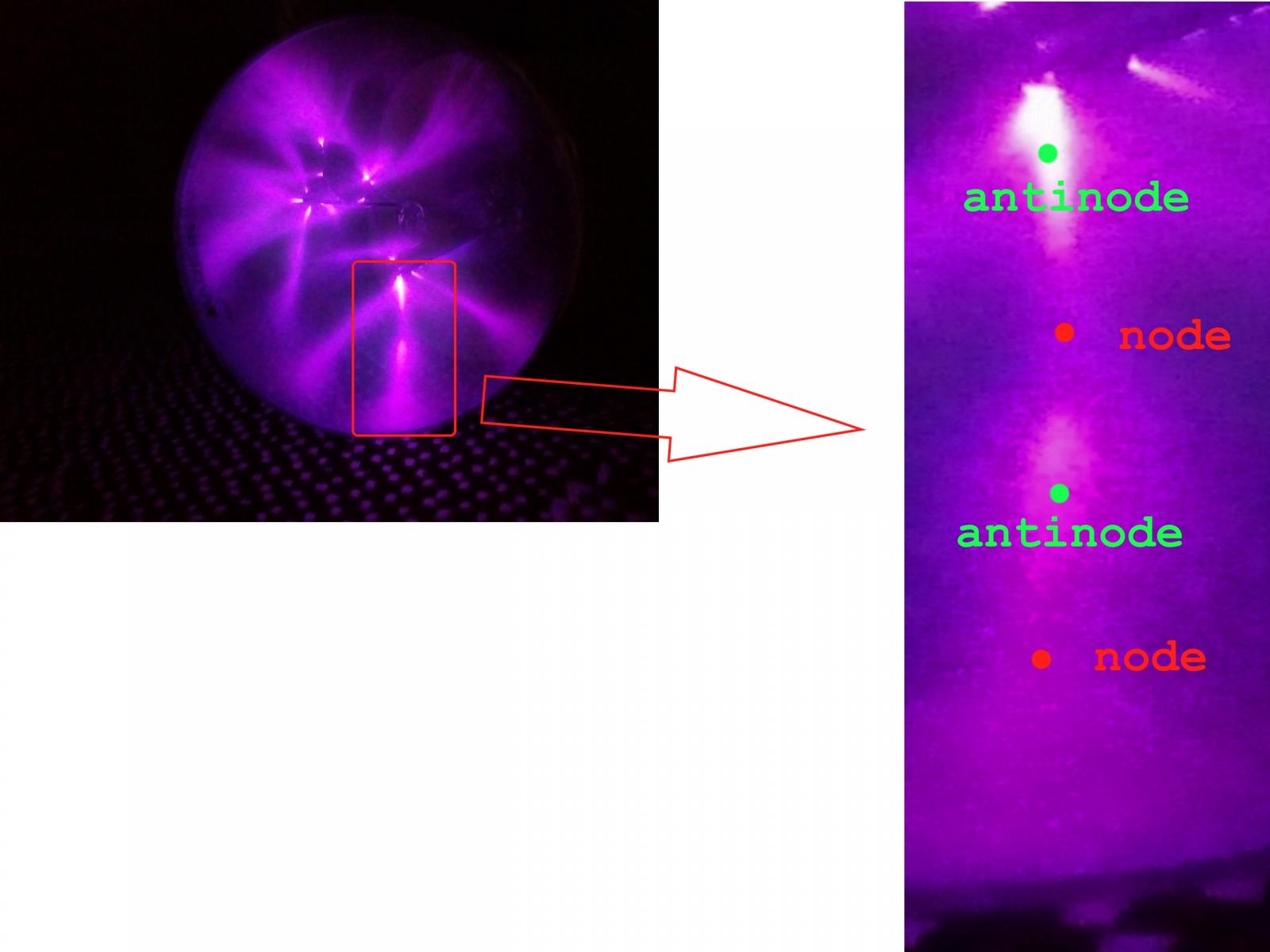

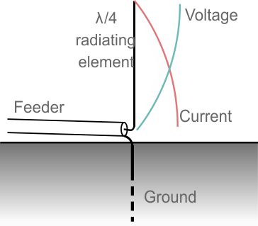

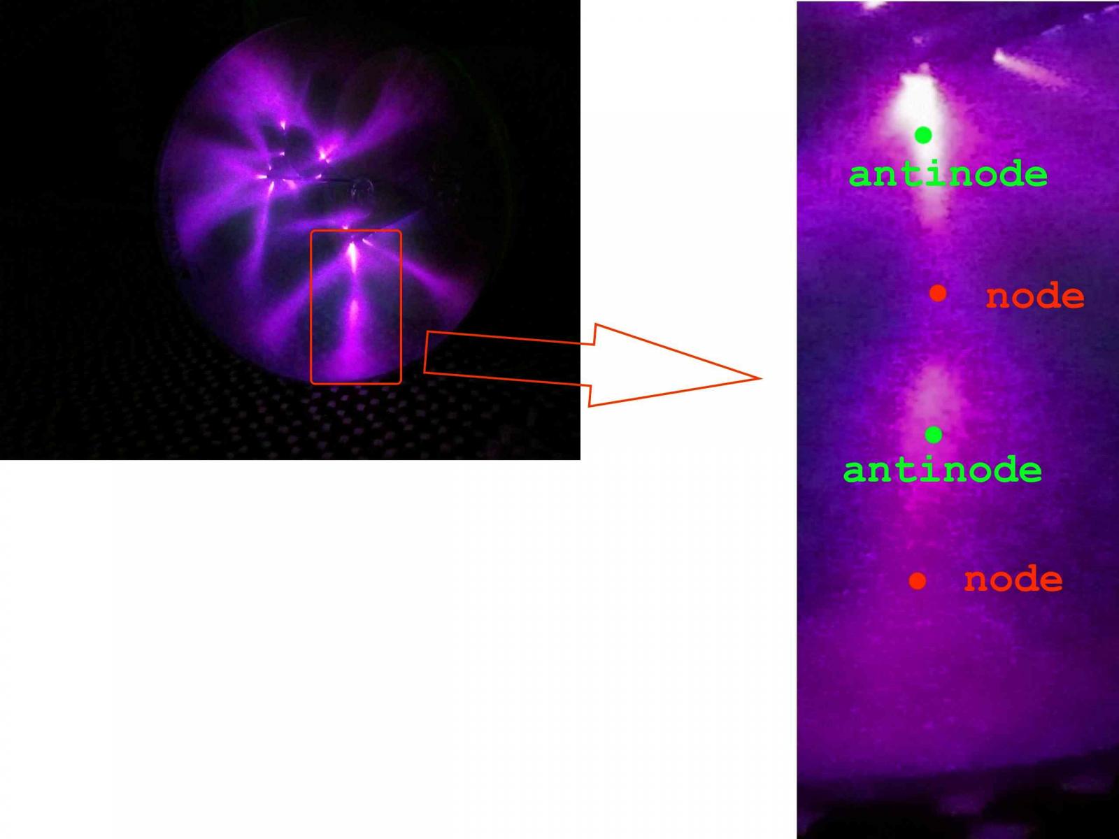

On a Tesla Coil Secondary It can exhibit Stationary waves.. why is that?..
based on what I have learned so far.. It is because of the presence of a REAL and PHYSICAL WAVE, a Displacement of something in the wire or along the wire... and when that WAVE reaches the End of the wire (I am not actually sure If its the end of the wire nor can find any reference to where exactly it bounces, but that is where its most likely to be)It will Reflect and Travel back Into Its Origin.. now If there are series of these WAVES being pulsed continuously, the reflected WAVES will superposition with the incoming WAVE generating another wave, a STATIONARY WAVE.
https://en.wikipedia.org/wiki/Standi...nding_wave.gif
this WAVE has been found to be traveling at the speed of light (299,792,000 m/s or anywhere near this) by knowing this and knowing that this WAVE is traveling ALONG the wire, we can determine WHERE the STATIONARY WAVES WILL OCCUR.. in FACT we can manipulate its wave length by changing the frequency, and PHYSICALLY TAP where it is located .
