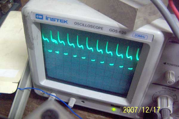

No, the neon is needed to protect the transistor. Also you should not leave the motor running with no charging battery attached longer than a few seconds, because so you will damage your tansistor. The neon will protect it for a while, nut not for long. The battery does an excellent job in absorbing those spikes, thats why you do not see them on the scope when the charging battery is attached, but if you disconnect it for a short time, all the spike energy goes through the neon and you can see that on the scope.

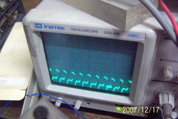

The "h" wave form
Wow, I love seeing this h !
Did you add a circuit for the sound card oscilloscope to protect the sound card before doing this? If so, I would like to know what you used!
Originally posted by elias View PostHere is my H wave form
Enjoy ...
EliasSee my experiments here...
Drive and trigger coil wave
Hi guys,

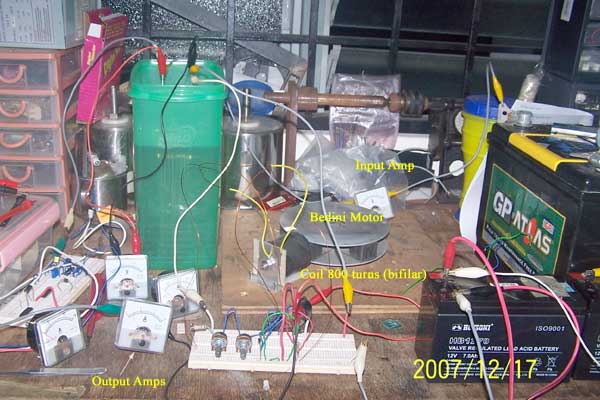

I was testing Bedini Motor SSG circuit for electrolysis. Yesterday, I took some photos on drive and trigger coil during load (Two 3W bulbs in series with electrolyser). I'm not sure if this "h" you are talking about.

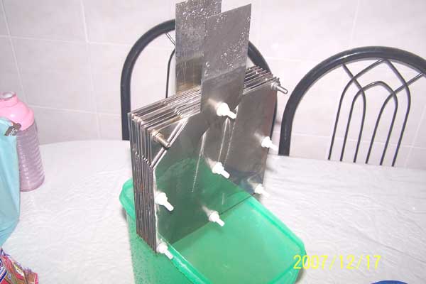

Hello,

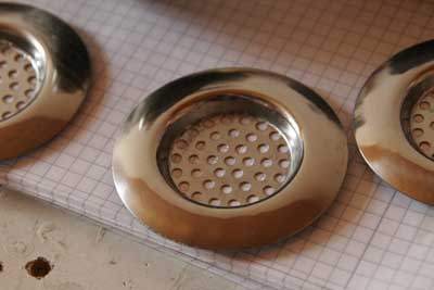

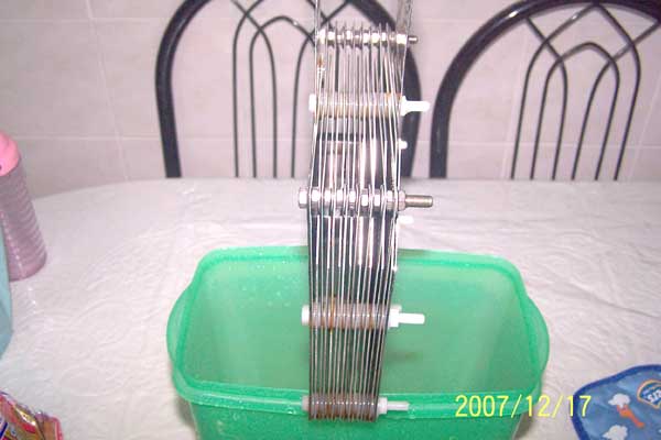

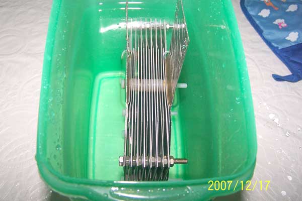

I also tried to do electrolysis with this process. Could you tell us more about your results? with my 5 coil machine I seem to get more gas than normal. the waves pretty much look like this . can you say more about the plates used and how many you have? I use stainless steel kitchen sink filters readily available here. Up to 10 plates sandwiched together with a PVC bolt and individually connected. Note the grey coating on the negative plates, too.

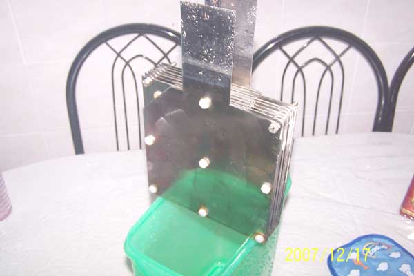

Hi Albert,
That is very clever idea for using SS kitchen sink filters for electrodes. I'm using 16 pieces of 6" x 6" SS 304 plates to make 8 cells. The gap between plates is 1.2mm (used 1.2mm nylon washer as cell spacer). Until today, I find amps is the one doing work to generate hydroxy and not high voltage. Cell needs just 2V to produce gas and above than that is just waste of power. Using 10A@12V and 10A@2V will produce same amount of gas.
Since I'm using only single stator to drive the motor, I can't expect much gas. I have connected ammeter to measure input draw (battery -> ammeter -> circuit) and output draw (collector -> diode -> ammeter -> cell).
I find input and output amps are almost same (0.1A) using 12VDC as source. For 24VDC as source, input amps still 0.1A but output is 0.2A. For 36VDC as source, input amps still 0.1A but output is 0.3A. I use analog meter to measure the amps so can't measure accurately but can see the differences. When power of the circuit, magnetic rotor still produce power to cell until the rotor fully stop. This is one great advantage using Bedini SSG as battery charger or for electrolysis.
Never ever apply high VDC without load. By doing this, 2N3055 will get fried. I have even tried motorbike spark coil to induce high voltage for electrolysis. I got poor results and that is why I said the amps are the one doing work for electrolysis and not the voltage.
I am using a PC based oscilloscope
I was about to buy an oscilloscope so I decided to buy one that is capable of more functions on the PC, so I bought a PC-based one. It works fine although I burnt out one of the channels by connecting it to a high voltage (about 1000v) mistakenly!!Originally posted by theremart View PostWow, I love seeing this h !

Re: H
Cool.Originally posted by elias View PostI was about to buy an oscilloscope so I decided to buy one that is capable of more functions on the PC, so I bought a PC-based one. It works fine although I burnt out one of the channels by connecting it to a high voltage (about 1000v) mistakenly!!
