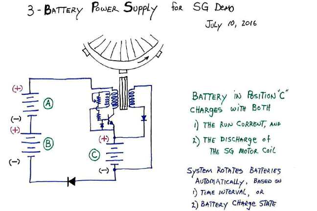

                              the high speed switching diode
                              Jim,
                              Where does Dr. Lindemann talk or show the high speed "flyback" switching diode ? I'm looking at digikey and mouser but don't know which one.
                              Thanks,
                              wantomake
                              Hey Wanto,
                              Dr. Lindemann showed this in his 3BSTP version in his last presentation in 2016 before retirement. See attached. It's from the Beyond SG Advanced video/PDF.
                              He discusses it here:
                              I think this fills the bill as he laid it out in that post:
                              I used a smaller axial lead one in my LiMn 3BSTP version. In the automated big battery version I'm putting together now, I plan to put the above one in the negative rail with a high current SPST switch shunting it so I can manually switch it in and out of the circuit.
                              Jim

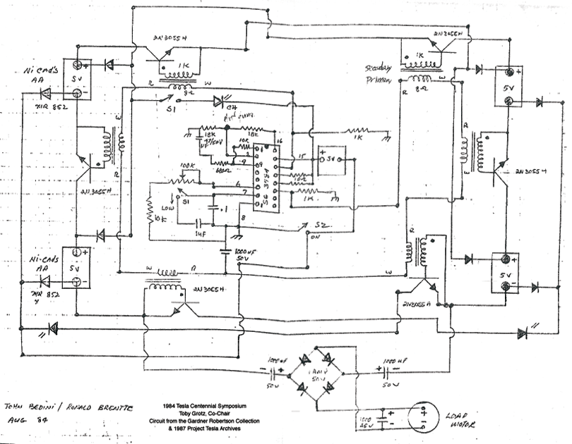

                                John Bedini's Schematic from '84 Tesla Centennial
                                Toby Grotz found this and sent it to me today. So a bit more complete picture emerges and verifies that it wasn't really a 3BSTP - it was a Tesla Switch, and it wasn't in a cigar box. So the question naturally occurs, did JB ever build the 3BSTP system shown at the top of this thread? Interesting that so much has come from that.
                                Jim
