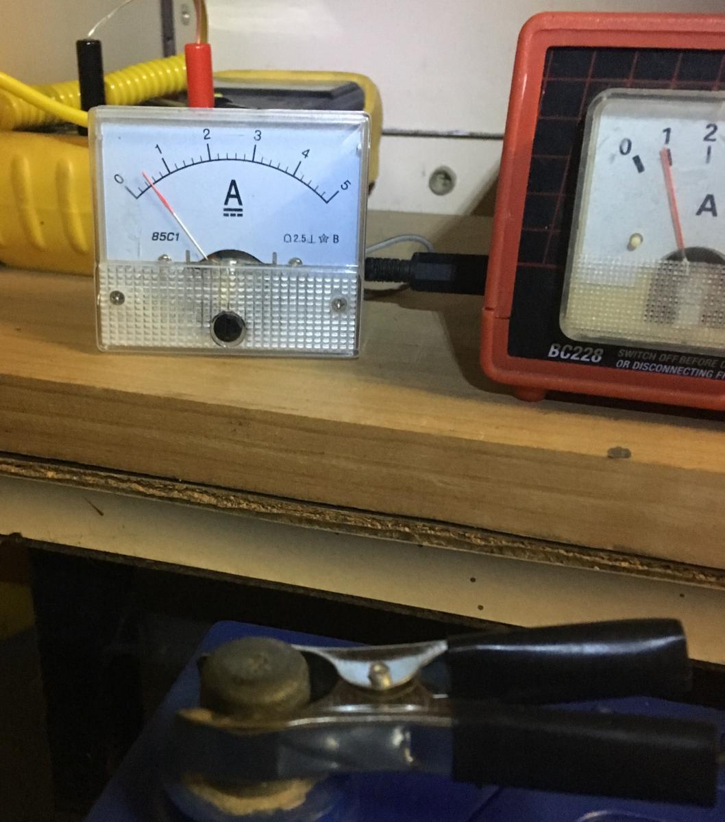

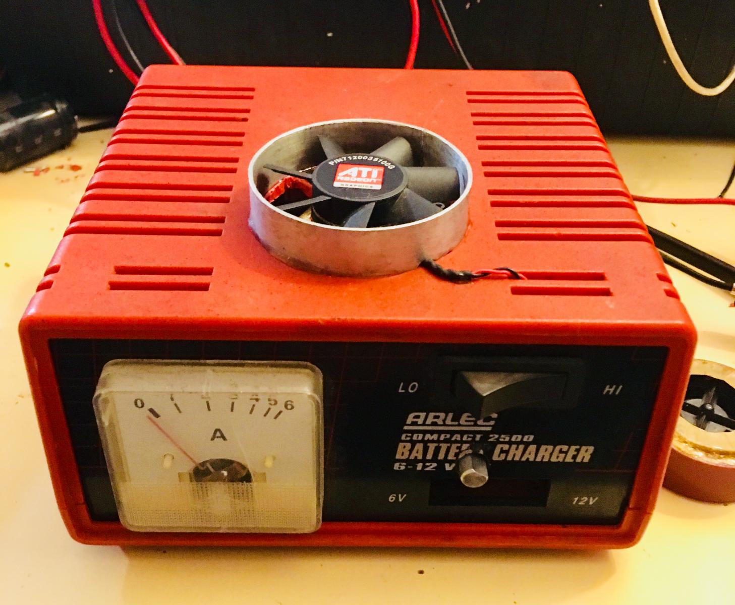

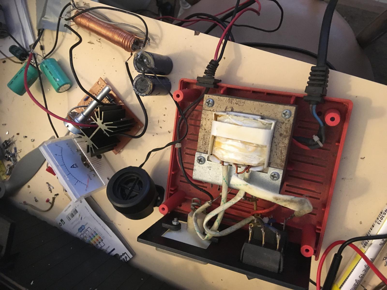

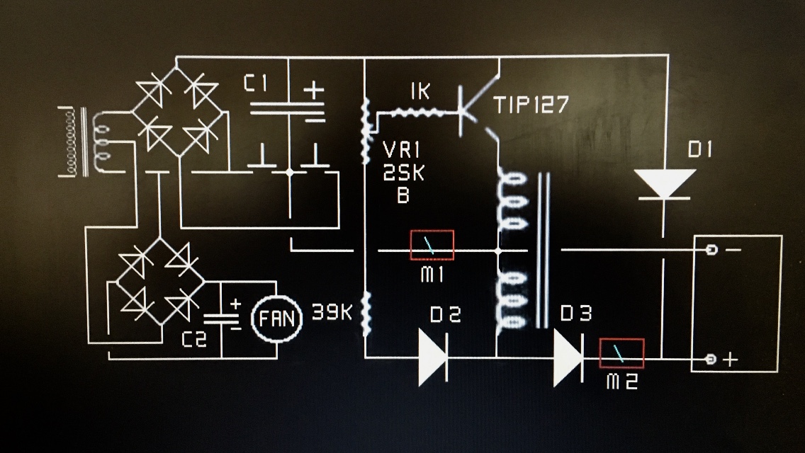

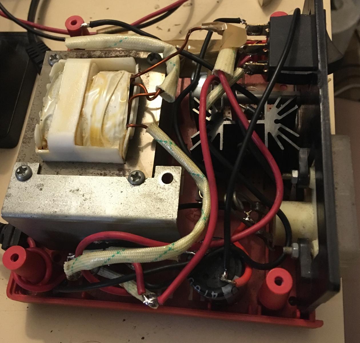

                      Hi all. I’ve probably built around fifty joule thief circuits over the last 8 yrs or so, always with about 3-100 ma input and up to about 40 ma return to source at the same input voltage, using single stage transistors. Recently I thought I’d try some tip 122/127 Darlingtons with 12v input and was surprised to see 400-600 ma return to source current.i haven’t measured the input current. I’m guessing it would be 750-1000ma for that sort of output. Heat gets a bit serious if I push it any harder.
                      The tips seem happy with 1 k base resistance off the usual variable voltage divider and they need a decent heat sink. With the much increased output I decided to hack a battery charger and fit the additional circuitry inside the box with a little computer fan on top in a bid to restore a car battery that was digitally tested as bad:replace, The built in magic eye indicator for one cell of the battery had no colour to begin with and after about a week is starting to show the bright green. Still waiting for the red dot in the Centre tho. Anyway long story short, it might be worth trying tip122/127 for more output. Hfe 1000-2500, 100v, 5a continuous.
