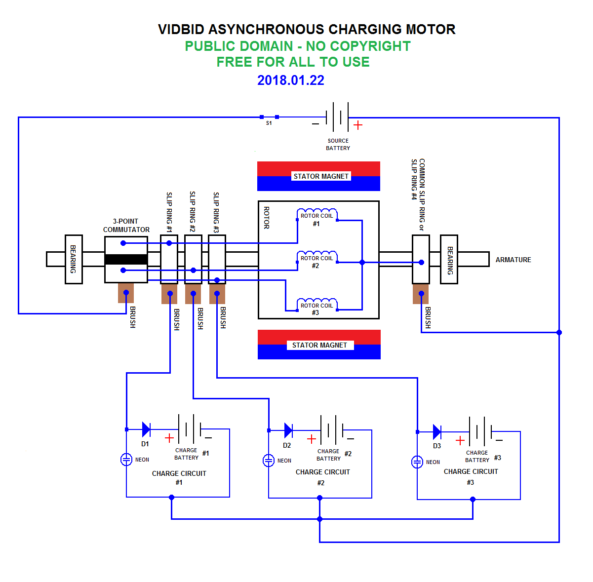

    Check my latest fusion design. I don't take any credit for it.
    PUBLIC DOMAIN - NO COPYRIGHT
    FREE FOR ALL TO USE
    In a few days, I'll make a video explaining its purpose and how it works, and I'll post it here.

    Interesting design
    Vidbid,
    Interesting idea with slip rings and commutator together. So it's a 3 segment commutator?

      Hello Vidbid!!
      Nice work friend!, I like it, it uses the pulses from commutator to send back to the charge system, but only utilize the reversed Positive spikes to charge the three batteries...nice!
      I just believe you also need a diode between the negative on the charged 3 batteries and the positive from the source battery...that way you will fully drive negative spike to charged batteries...
      I love electrodynamic machines, and so, I can not avoid when I see such a nice system put together like this one...to try to "improve it"...even before it gets born...sorry about that...
      So if I may suggest a "Reversed Engineering" of your set up above...if you think would deviate from Original Idea...then I'll just simply delete this post as per your request.
      I would reverse the whole thing, make it completely brushless, then zero mechanical friction.
      You could make a two magnet rotor with the three coils as stators as you have above...then add a third small magnet at a second level of rotor (not interacting with coils) but just to trigger three static reed switches at that level, which would replace the three element commutator...but static.
      And so if it works as you like...you could always upgrade reed switches by hall sensors, even though it requires additional circuitry to run them...
      I believe it "feels" very comfortable to have all wiring's and circuits on the static side, just running to your charging battery bank...
      It was just an idea...do not take it seriously...hahahaha

        Thanks, UFO. Those are great recommendations. I encourage improvements and modifications, and as such, I shall refer to your newly improved design as the Ufopolitics Asynchronous Charging Motor.

          That's correct. There are three segments on the commutator. Each segment of the commutator charges a corresponding rotor coil. The corresponding slip rings provide a flyback path to three corresponding charge batteries.
          A TIMELESS MACHINE - YouTube
          It's hoped that this design would eliminate commutator sparking and produce mechanical torque and battery charging. Also, I don't see why the motor couldn't turn a generator to produce additional electrical power.

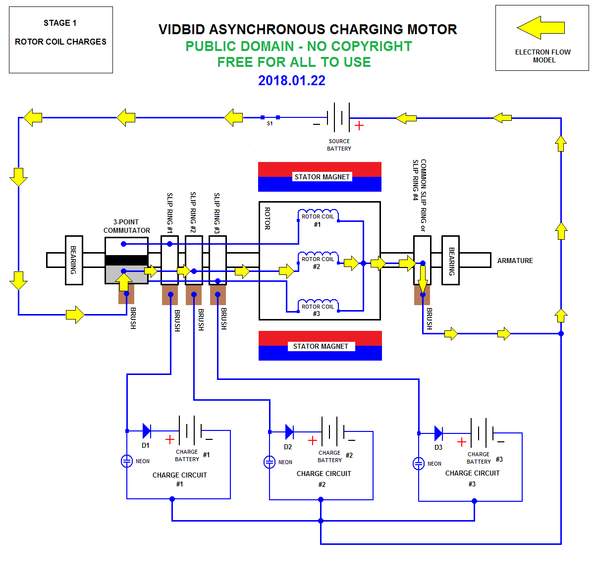

          Stage 1 - Rotor Coil Charges
          Note: I believe that there should be sufficient gaps between the commutator segments so that the commutator brush can only contact one segment at a time, that the commutator brush doesn't contact two commutator segments at once. I believe this is important. I also believe that the gaps between the between the commutator segments should be sufficiently long enough to give the rotor coil sufficient time to discharge most of its charge into the charge battery.

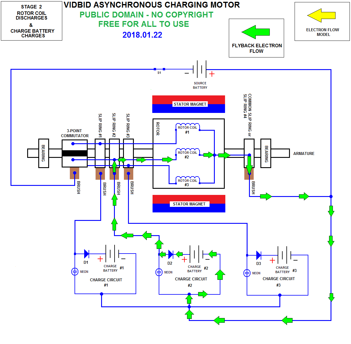

          Stage 2 - Rotor Coil Discharges and Charge Battery Charges
