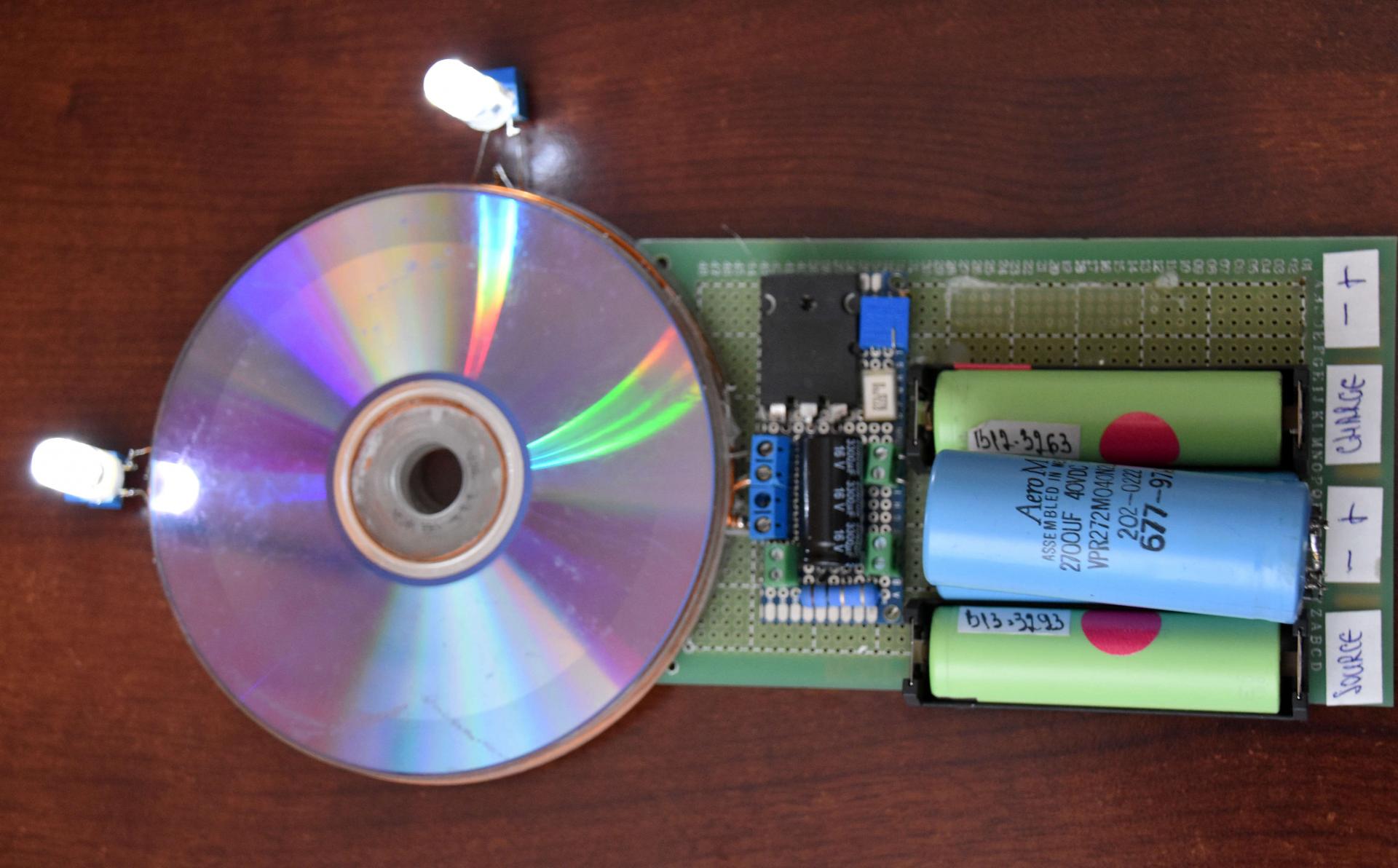

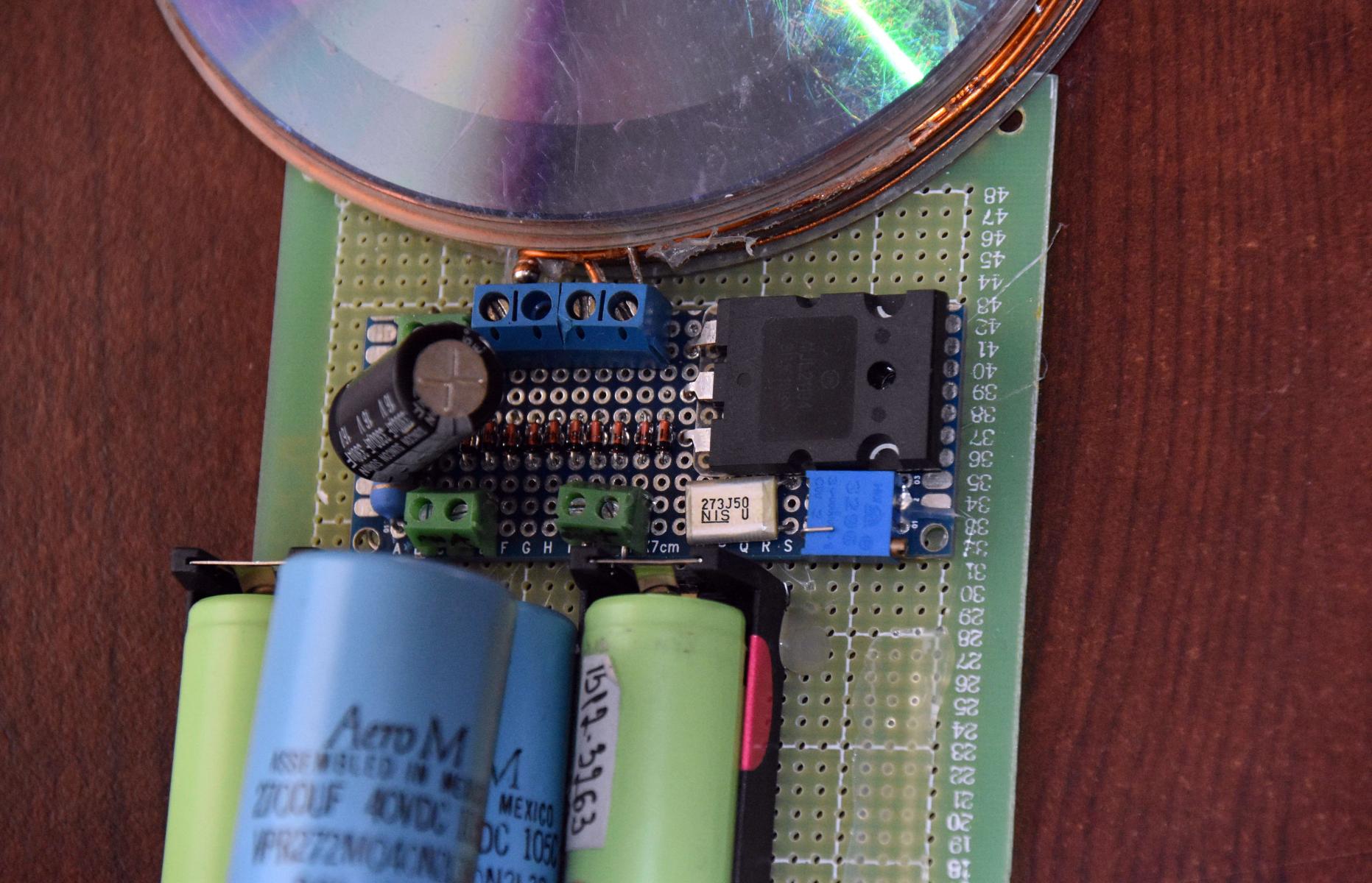

    Hello, everyone.

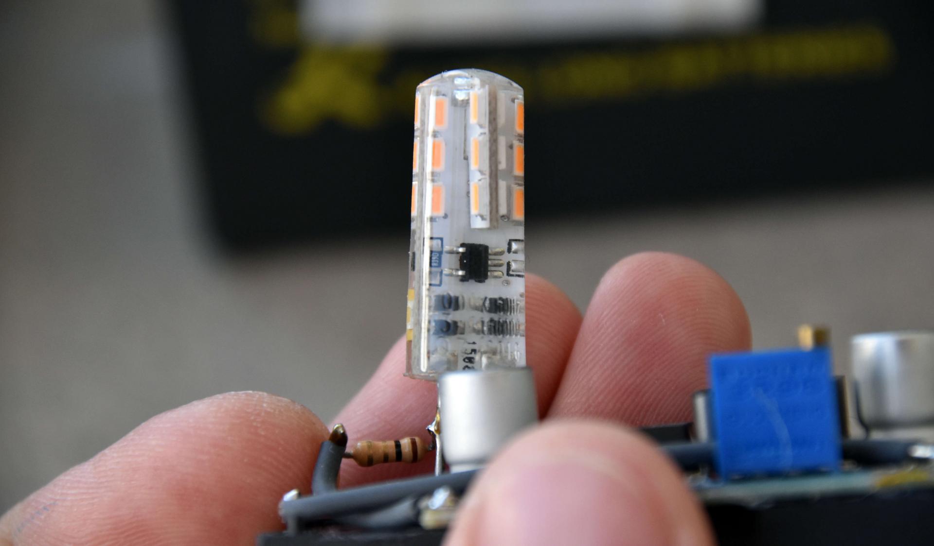

    My goal is to achieve a emergency light, capable of running long time, with a decent light, and a small current draw.

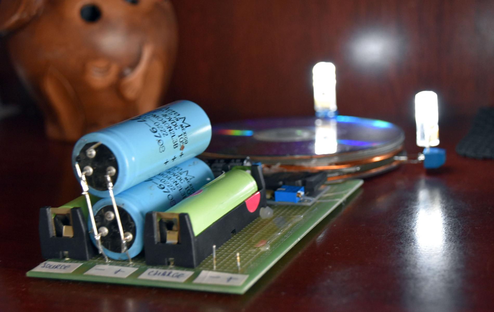

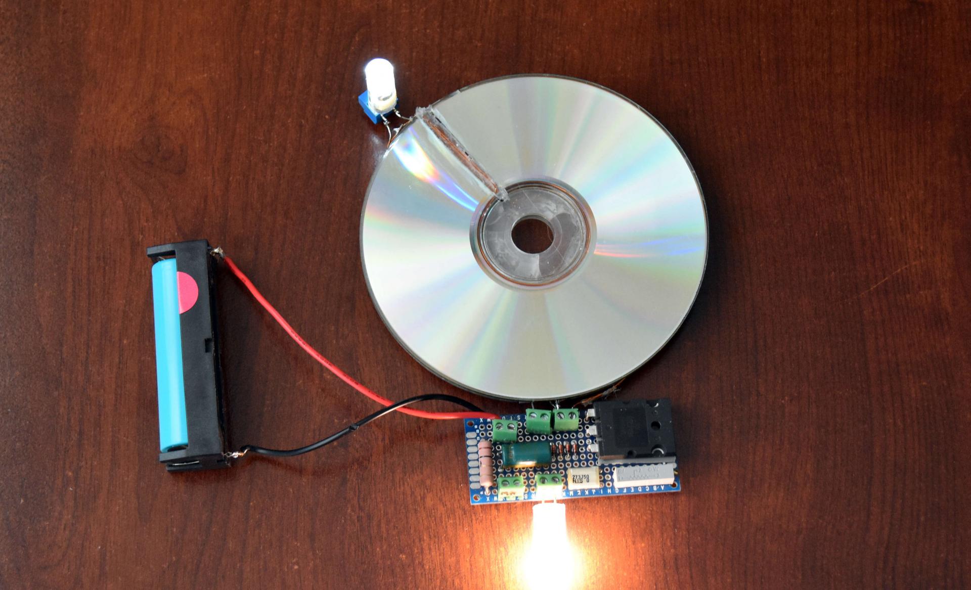

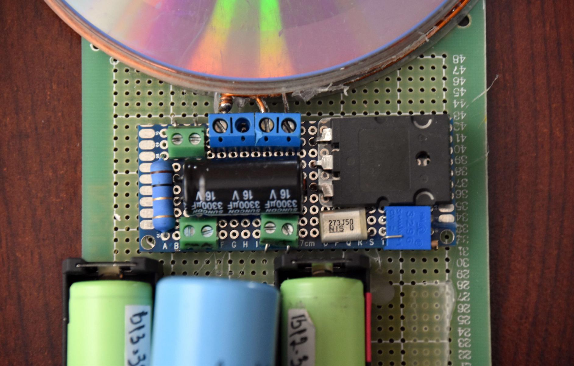

    I have played, during last years, with Joule thiefs, and recently, I made one with 18650 Li-ion batt, with some modification to last longer, and to give a usable light.

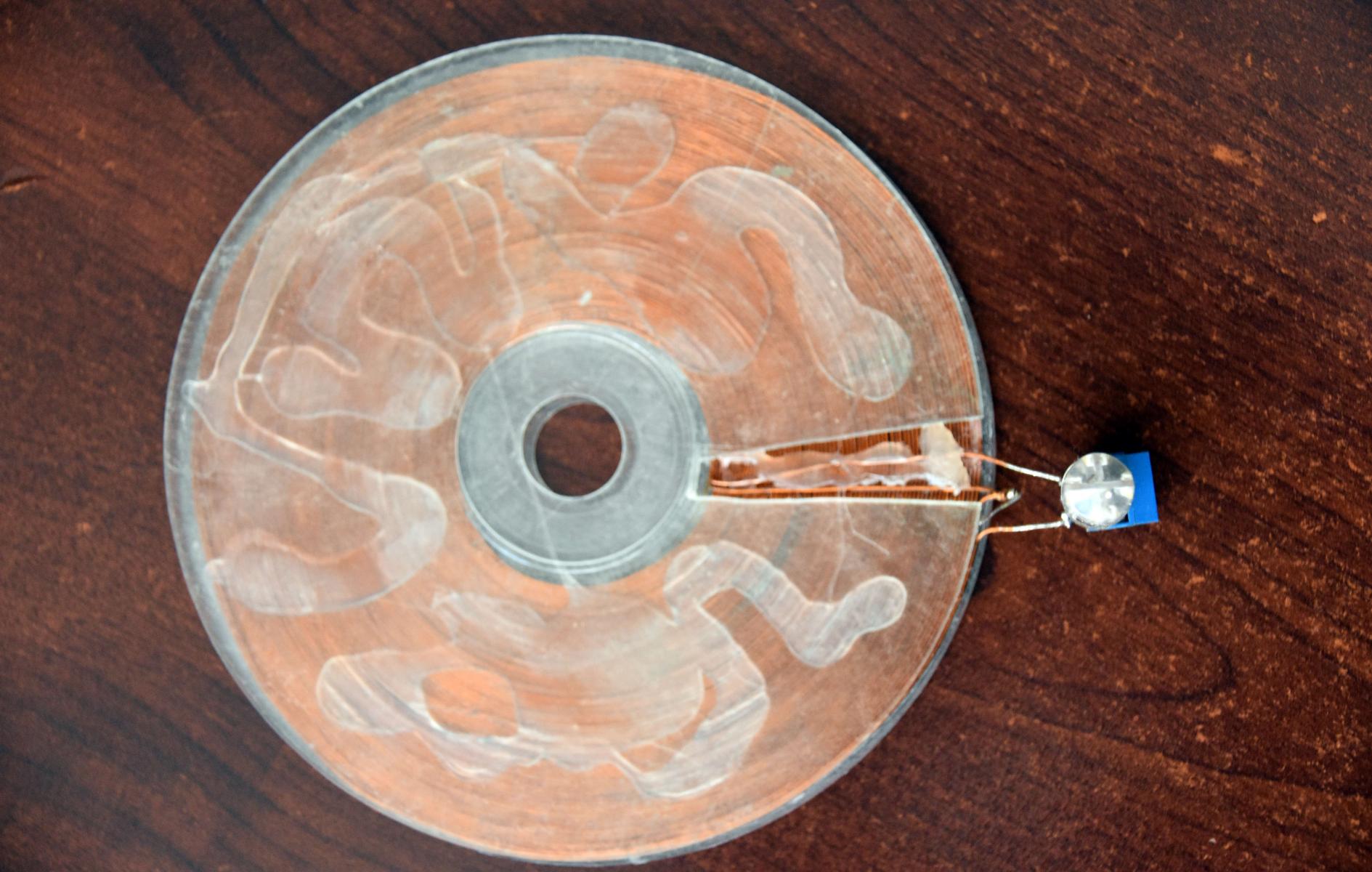

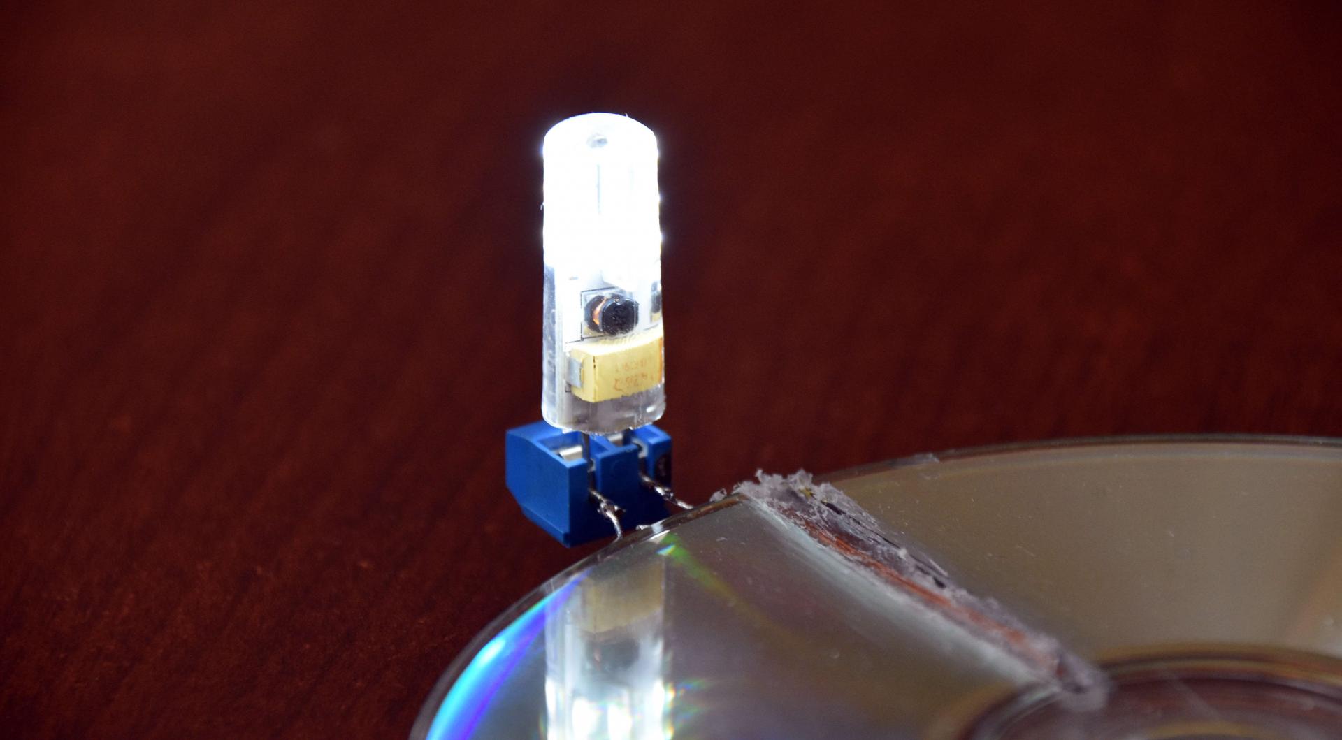

    Output of joule thief is charging other 18650 batt, while giving light from two 12 volt / 1 watt led bulb, and each of those bulbs are connected to a pancake coil.
    Both batteries was charged when I started the test, and, from time to time, batteries was exchanged from charger to source and viceversa.
    A small reminder. Those 12 volt led bulb can`t be fired up by a single 18650 li-ion batt...
    Just for fun, I compared the charger with a „simple” Joule thief, similar setup with charger, except no charging second battery.

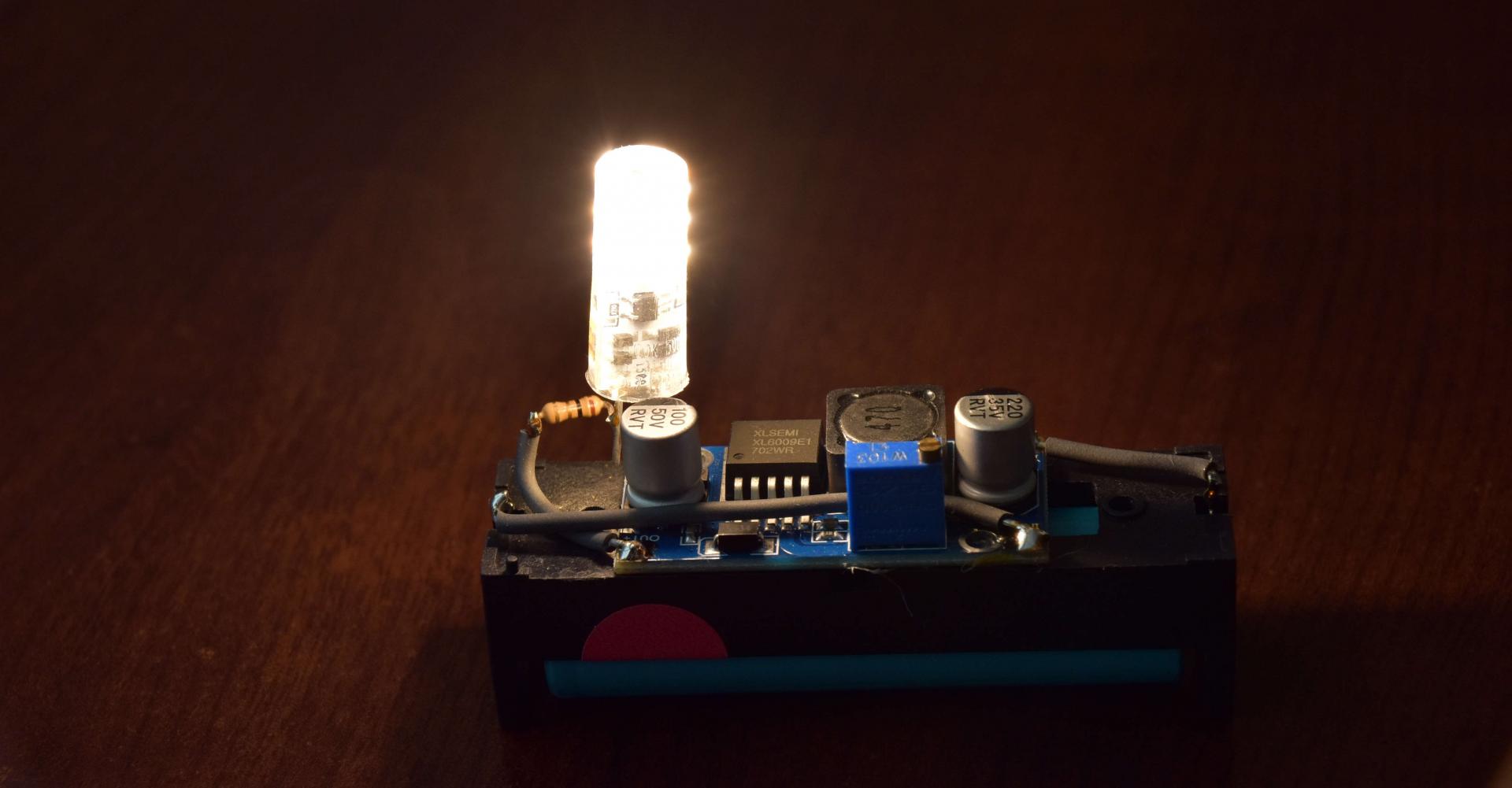

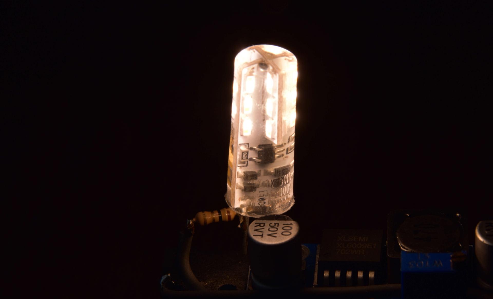

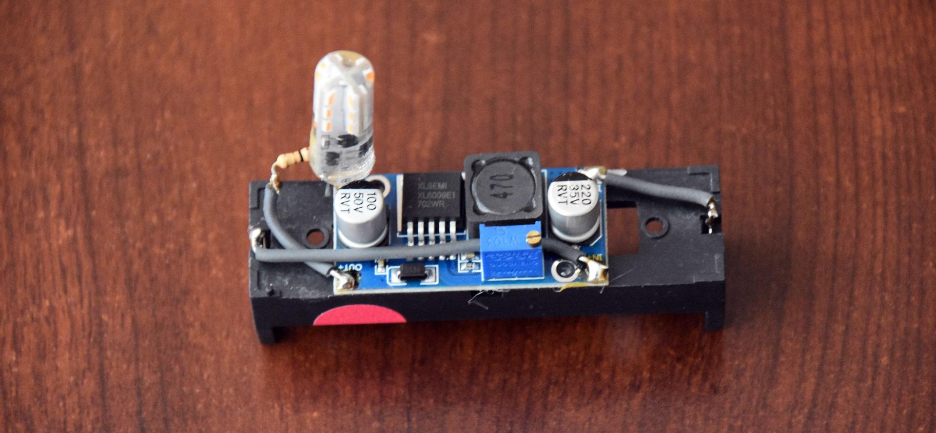

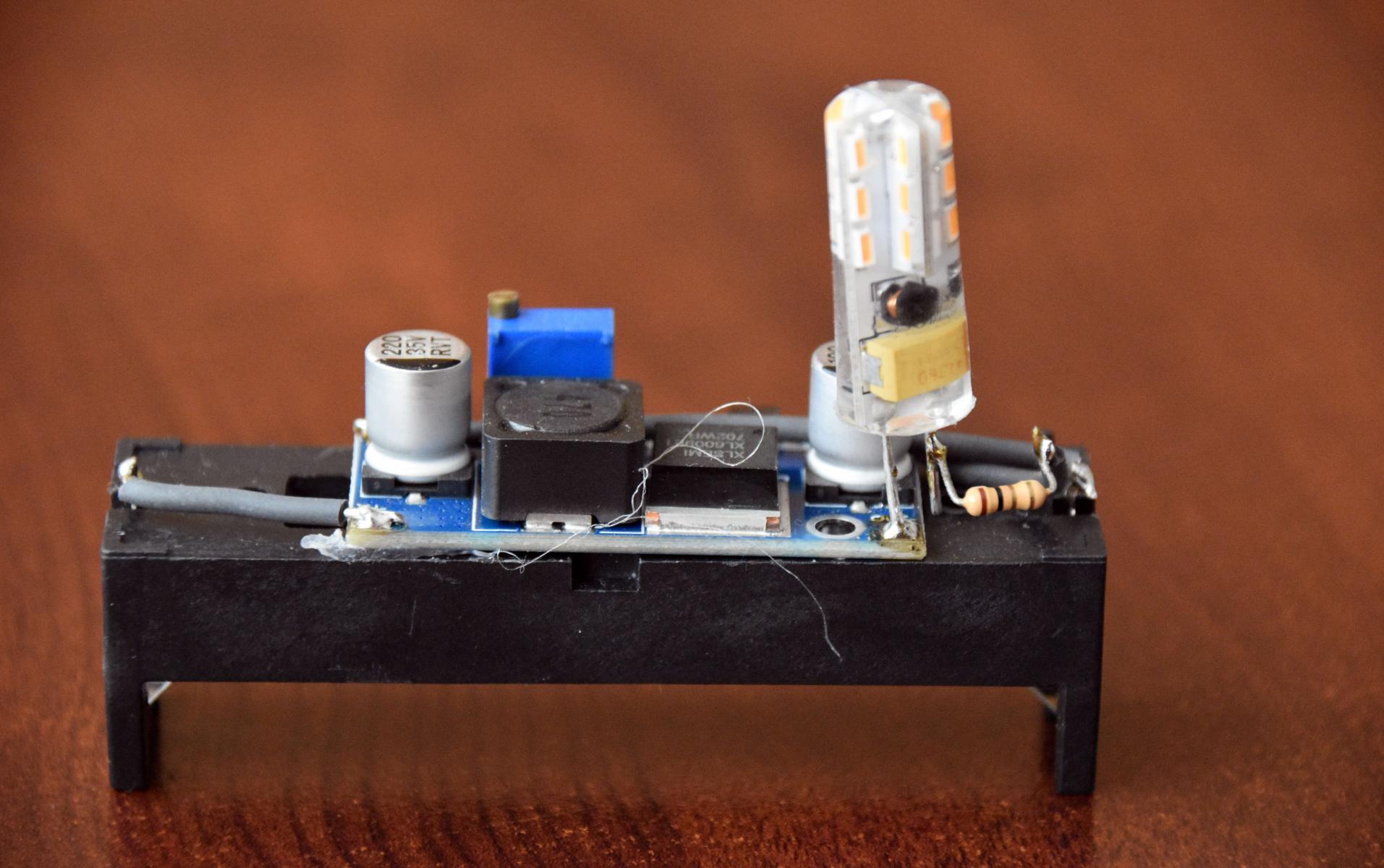

    Also, I`ve tested a „conventional” way of lighting the led bulb, with a step up module.
    So, the result are as following:
    1. Conventional setup: run time almost 42 hours, initial current draw 40 mA (and 176 mA in the end);
    2. Joule Thief classic: run time almost 80 hours, initial current draw 44 mA (and 30 mA in the end);
    3. Joule thief charger: still running, 180 hours run time until now, initial current draw 66,3 mA (lowest current draw, until now 47,7 mA)
    Setup 1 and 2 was running from a 2900 mA battery, while setup 3 was running from two 3250 mA batt (i was tried to compensate bigger juice from last setup with a bigger curent draw). All Li-ion batteries are new.
    Photos and schematics in following posts.

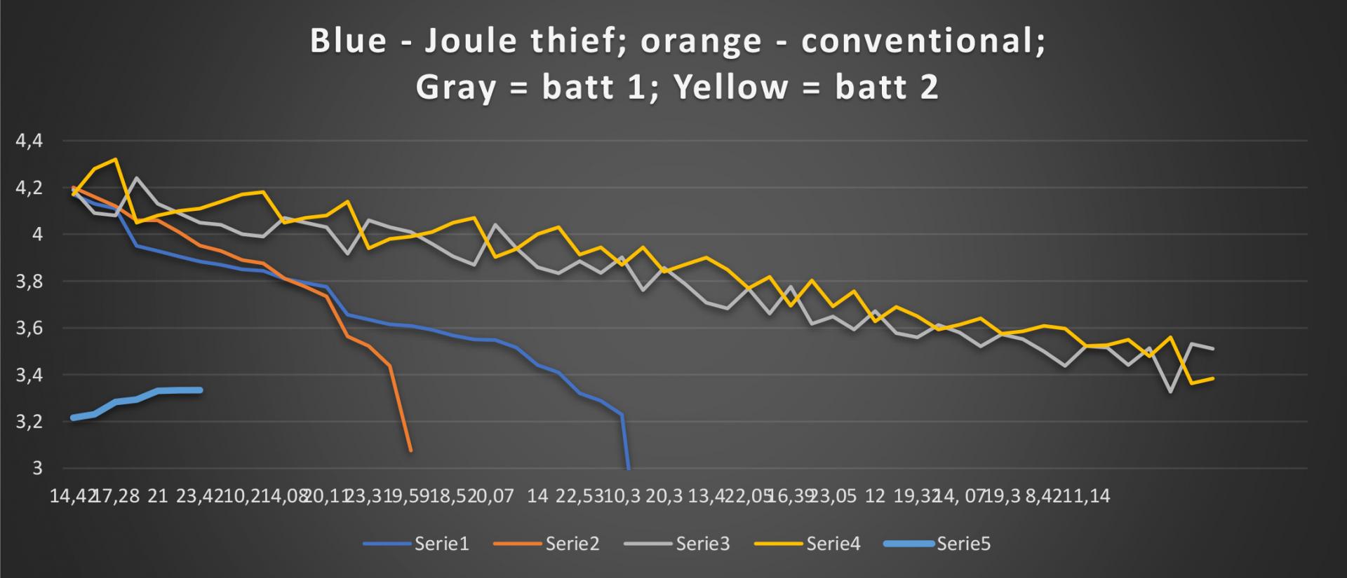

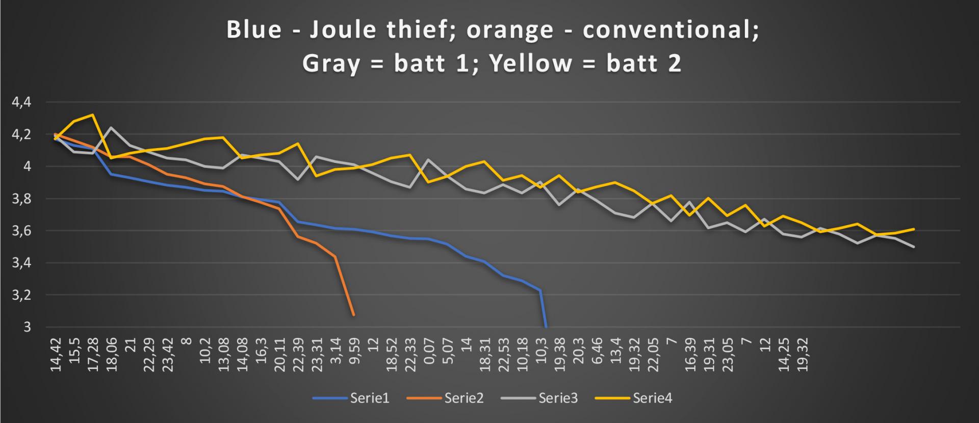

          A short diagram showing progress of the 3 setups discharging times. Yellow and gray lines are from joule thief charger, the setup still run for almost 8 days.
          I tried, also, in other test, to use Joule thief charger with only one batt charged, and the other, discharged, but the result was disappointing.

            Just a short update: 206 hours run time!
            I don`t know if my calculations are right, but the charger should work only for 106 Hours! 6400 mA (capacity of both Li-Ion batt), divided by 60 mA (average current draw), equal 106 hours run time!
            But my running time at this joule thief is almost double, and I had usable light for 8 days. Interesting...
            Anyway, i`ve hooked up another 18650 batt, with a fast diode (1N4148) to the second pancake coil, and it`s charging, slowly, but now i have another source of power to feed this setup, after a few days...
            Best regards,
            Teodor

                Thanks for your reply. Please consider I`m using 12 volt led bulbs, and if you examine again fotos from joule thief charger, the light is quite intense during night. I can easily read during night :-).

                    L.E. The light blue line from the diagram is charging the secondary batt from the pancake coil (so one led bulb now it`s gone!)

                        Pancake coils are very interesting... If I remove both of my recovery coils in my Joule thief charger, current draw change from 50 mA to 600 - 700 mA!
