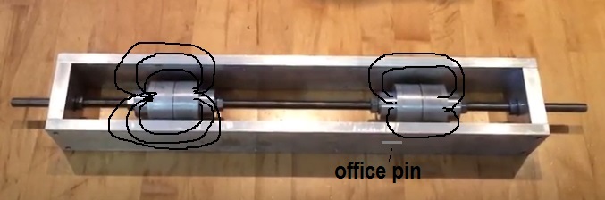

                        Hi Paul,
                        What is missing for me is the free rotation of the floating rotor in the center: I would expect it to spin for a relatively long time after
                        you give some spinning to it by your fingers.
                        See this levitating toy what I mean:
                        What I suspect is that free rotation is hampered by eddy currents induced in the Alu side walls close to the floating rotor magnets.
                        I think there are static fields like I tried to indicate roughly in the picture, see attachment.
                        Can you can detect magnetic field on the outer side of the Alu wall? Does say an small pin or a small nail remain attracted to
                        the outer side of the Alu wall as I tried to indicate in the picture?
                        If you can detect stray fields from the magnets at the outside wall, then the fields penetrate the Alu structure
                        so this may cause the eddy current braking effect against rotation.
                        Unfortunately, you would need to build a wooden or plastic structure instead of the Alu one to get rid of
                        the breaking effect if this is the case. I do not know how the magnets are arranged
                        inside the cylindrical Alu holders (I did not follow your full work here), so maybe I am wrong with my eddy current suspect.
                        Your work is awesome, by the way.
                        Gyula

                          • #14
                            Hmm not sure until I increase the magnet strength of the outer magnets. There is currently physical contact but barely.
                            I would expect the axle to be levitated more and a visible gap between the magnets...
                            Next magnet holders are going to be stainless 316 with probably 0.5mm between the magnets on each holder.
                            The current arrangement is actually N/S N/S I just checked it.

                              Gyula, yeah, I think your right the paramagnetism is producing a weird effect that adds friction. Its magnetic friction!
                              I might be able to get away with the frame but you have a point!
                              Magnets get sucked over to the frame, so the magnetic field is there.
                              I just tested a 24mm spanner and it almost held it off the ground to the outside of the frame, so field is strong.
                              Might have to be all made from 316 Stainless.
                              Will look amazing polished up!
