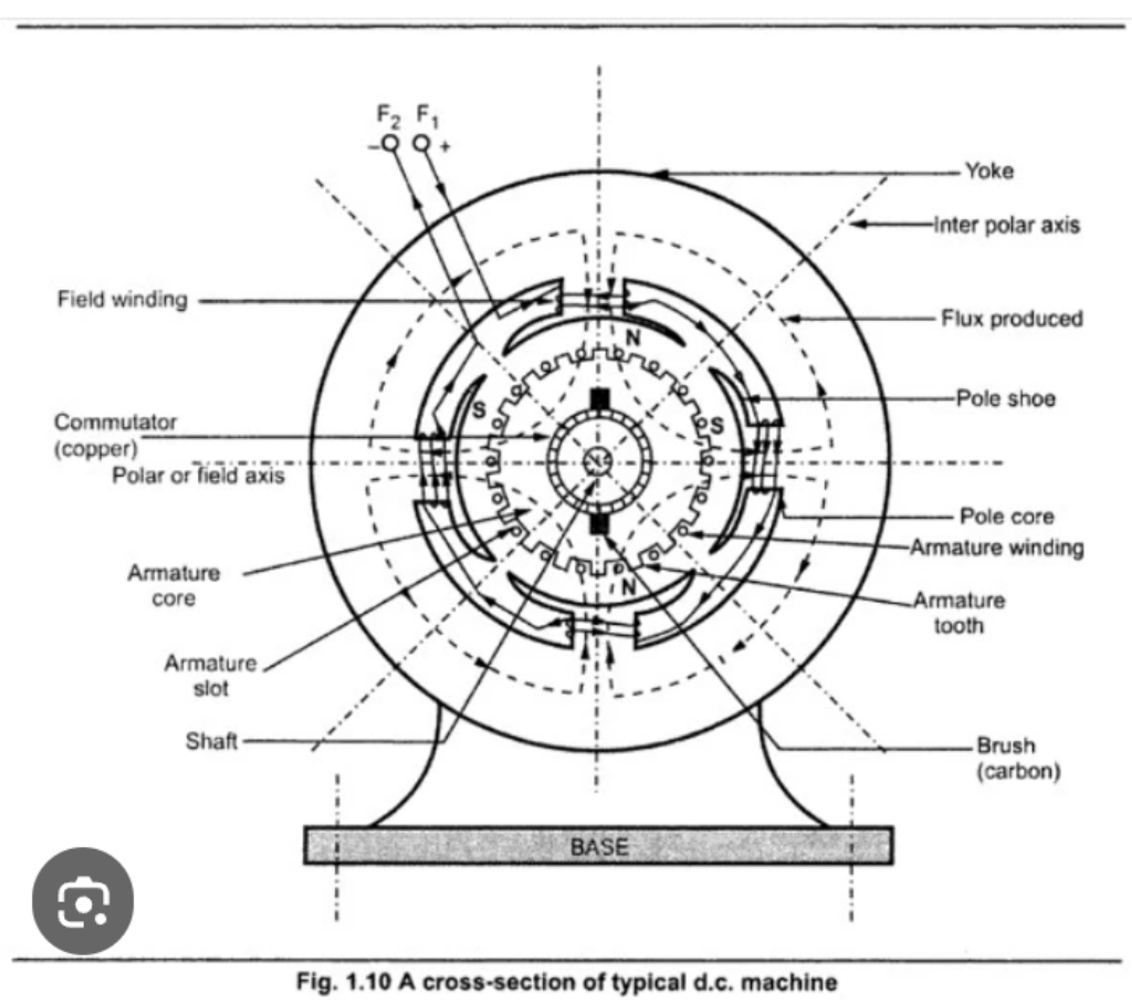

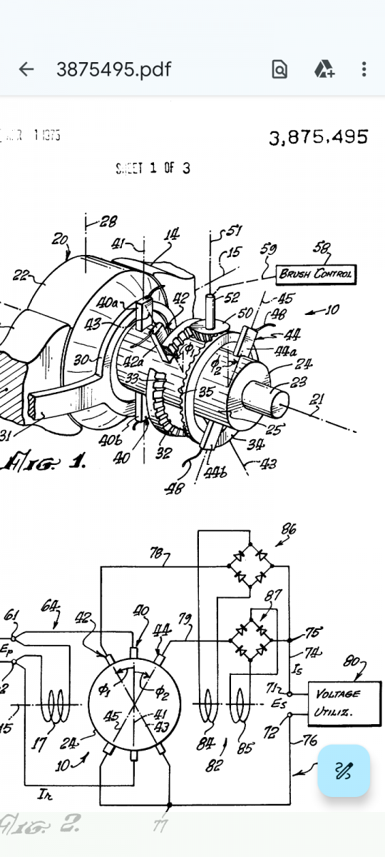

            • Hi all,
              I've been following another forum, OUM, thread about Lockridge device. Ufopolitics is designing his version. I have not analyzed the original device but have been following Ufo's explanations on his approach. I'll just list some comments below for those interested.

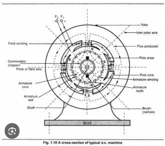

              .... Nomenclature, what to call what. Helpful to use standard jargon of the field. Such as found here:
              Click image for larger version  Name:	Screenshot_20241127-000532_copy_1024x909.png Views:	0 Size:	430.6 KB ID:	515484
              ​​​ ​​​​​From:
              ​​​​https://eeebooks4u.wordpress.com/202...-a-dc-machine/

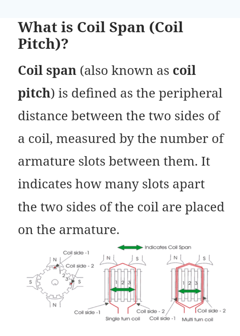

              Also concerning armature windings:
              Read the article here:
              https://www.electrical4u.com/armatur...mutator-pitch/
              The idea to reduce the coil pitch without altering some other items will produce unintended consequences.
              I have stated before that all rotating motors are running as generators, so having a single dynamo simultaneously function both as a motor and as a generator is reasonable. Using a single armature and accessing a generated voltage different from a supplied source while rotating (as a motor or as a generator) by adding auxiliary brushes to the commutator has been done successfully. One such device invented by Dr. Middlebrook is called a rotary transformer. I was able to witness the functioning prototype years ago. It did work as claimed (OU was never claimed). But I'll reference the patent as it may provide insight to armature winding and multiple brush set commutation.
              ​​​ Click image for larger version  Name:	Screenshot_20241126-223056.png Views:	0 Size:	222.5 KB ID:	515471

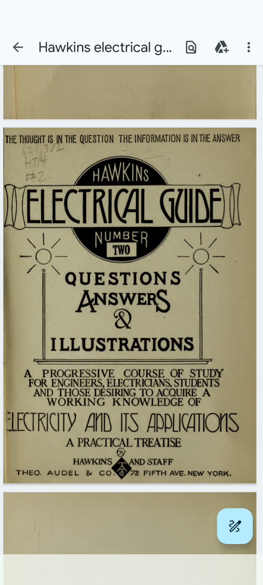

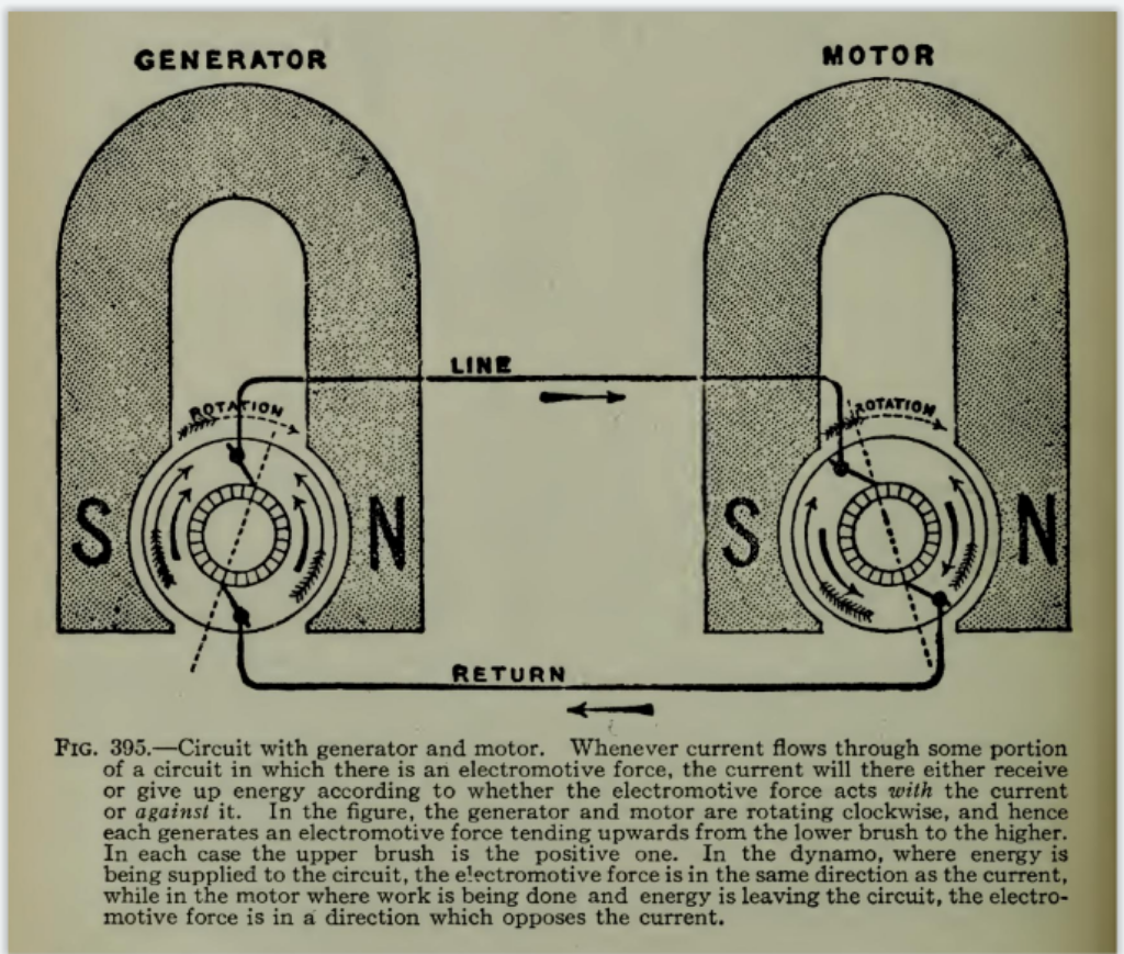

                  • As I continue to follow that Lockridge thread, I am pleased to see the reference to this text:
                    It does teach correctly basic aspects of electric machinery, with only a few mistakes noticed.
                    This lesson:
                    I like. It shows plainly and reinforces my claim motors and generators are the same.
                    A mistake, which I mentioned, concerns the cause of the shift of the neutral plane. It can be seen in the diagram that everything is the same between the generator and the motor except for the direction of armature current and the neutral plane shift. And it is this armature current which is the cause of the neutral plane shift, not rotation. In another section of his text, the author claims rotation of the armature causes this neutral plane shift. That shift is due to armature field distortion caused by current, and nothing about rotation. The diagram above shows this.
                    In another chapter he discusses armature winding and covers multiplex. A rather obscure feature that I mentioned recently. A feature which was incorrectly defined numerous places simply relying on Google search. These old textbooks are great resources.

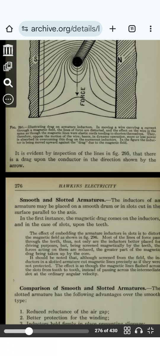

                      While reading through a few sections of this reference presented by Ufopolitics, I noticed that the author states his opinion, which is very much like what I have been telling you concerning "wires in grooves". I've copied and pasted below:
                      From:
                      https://archive.org/details/hawkins-...e-series-books
                      _______
                      Smooth and Slotted Armatures.—
                      The inductors of an armature may be placed on a smooth drum or in slots cut in the surface parallel to the axis.
                      In the first instance, the magnetic drag comes on the inductors, and in the case of slots, upon the teeth. The effect of embedding the armature inductors in slots is to distort the magnetic field as shown in fig. 296. Most of the lines of force pass through the teeth, thus, not only are the inductors better placed for driving purposes, but, being screened magnetically by the teeth, the forces acting on them are reduced, the greater part of the magnetic drag being taken up by the core.
                      It should be noted that, although screened from the field, the inductors in a slotted armature cut magnetic lines precisely as if they were not protected. The effect is as though the magnetic lines flashed across the slots from tooth to tooth, instead of passing across the intermediate slot at the ordinary angular velocity.
                      (my bolding)

                      Click image for larger version  Name:	Screenshot_20241128-125730.png Views:	0 Size:	734.7 KB ID:	515480
                      Edit.
                      2nd image from:
                      https://archive.org/details/hawkins-...e/275/mode/1up
                      ______

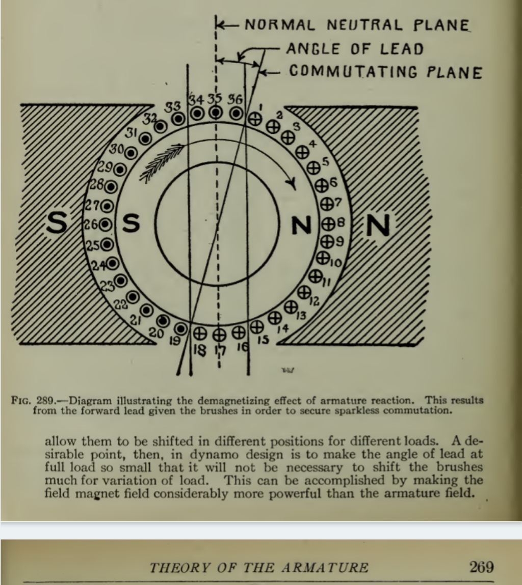

                        • So I've been continuing to study the Hawkins Electrical Guide and this diagram in particular.
                          Figure 289.
                          It depicts a dynamo as a generator under load. One can confirm generator mode by the direction of rotation indicated by the author, the polarity of the main field and directions of current in the armature conductors. The purpose is to aid in the author's explanation of field weakening when the commutation plane is shifted away from the neutral plane.
                          When you read carefully, you will understand that the smaller N and S labels in the circle representing the armature only apply to the field attributable to conductors 34-36 and 16-18, which buck the main field. The remaining armature currents produce the typical armature field direction at quadrature to the main field.
                          • Mr bistander. If you look at the currents in the armature conductors, the magnetic field in the ring core is obviously not the same as in the picture. The polarisation of the core from the outer poles of the stator cannot be as in the picture either. Take and carry out modelling in the appropriate program, is it difficult in the 21st century.
                              Hi Rakarskiy,
                              The representation depicted in figure 289 does coincide with the author's description of the portion of the armature field which bucks or opposes the main field due to currents in conductors 34-36 and 16-18 when the commutating plane is rotated from the natural neutral plane as shown. Read on page 269.
                              "The current in inductors 1 to 15 and 19 to 33, tends to cross magnetize the magnetic field of the machine, but the current in inductors 34 to 36 and 16 to 18 tends to produce north and south poles as indicated."
                              I, unfortunately, have not the means to produce FEMM. But if you do, please post. Thanks for the discussion.
