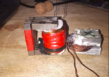

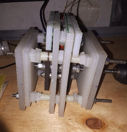

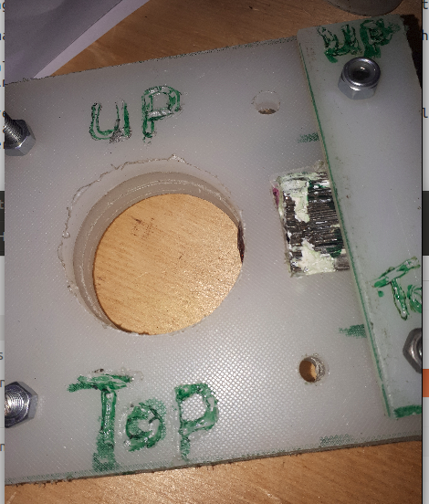

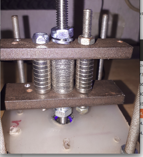

    I am still that taken with Alex Manzanero's idea that I had to keep nibbling away. I'm also hoping that the rotor might answer some questions I have about induction. Here is a shot of the stater.
    Here is a clean shot of the rotor.

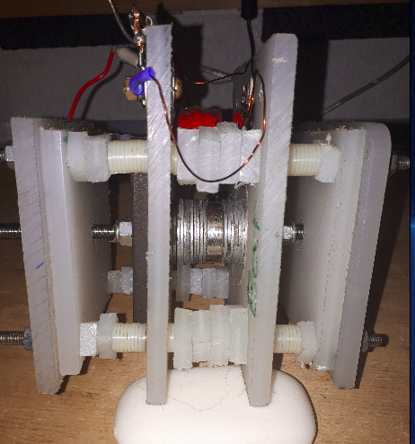

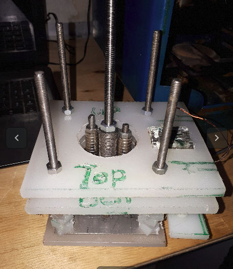

    Here is a shot of where things ended up today, when I ran out of spacers and patients (not necessarily in that order ). Hopefully that will be enough pics to get the general idea.
    There is probably only two major mistakes I can think of when assembling everything, and I managed to make both of them.
    The first is not replacing all steel threaded rod with stainless. If it doesn't cause massive shorts in the flux circuit, it will cause unnecessary cogging.
    The second is not making sure both magnet stacks are facing the same way, ie all norths up or all norths down. Failure to do this will result in the two stacks coupling causing a massive short across the center of the rotor, with only the left overs making it to the outside where it is needed.
    cheers.

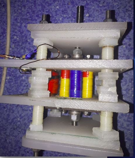

      The other day I Bolted it all up and this is what it looked like.
      It looks like I blew the gen core and ergo the windings. I was pretty unimpressed with the voltage output. That is about 3M of 0.7 wire.
      Joseph Newman would be very angry with me right now, and I also observed that the more experienced gen builders here are quite generous with the copper. So in order to make sure that I give this concept a fair shake of the sauce bottle, I'm rewinding the stater. The primary on the stater is wound and I'm doing the secondary tonight. Here's a shot of the old one next to the new one.
      The rotor was a bit of a departure from the norm. I found the time to briefly test it against a more orthodox rotor with more powerful magnets, and I'm actually quite happy with it for now. I'm hoping the mark 2 will be ready to spin up soon.

        I also tried this version with a much more powerful rotor made from 3 very strong ring magnets placed right in the center, so they would rotate one their own axis, with the axle through the center of them. Axle and washers made from steel.
        This made for a very powerful magnetic lock when it would come to a stand still. For all that flux being pumped through the gen core, it did a little better, and could charge a capacitor to 42 volts, but when shorted could only deliver 95 mA.

        The first stater made from 3M of 0.7 wire. Output using the two magnet stack rotor 20 mV after being rectified, and 2 A shorted using clamp meter set to A.C. .
        Second stater made from 0.25 wire, as many turns as it took to half full the core, over a thousand, 43 Ohms.
