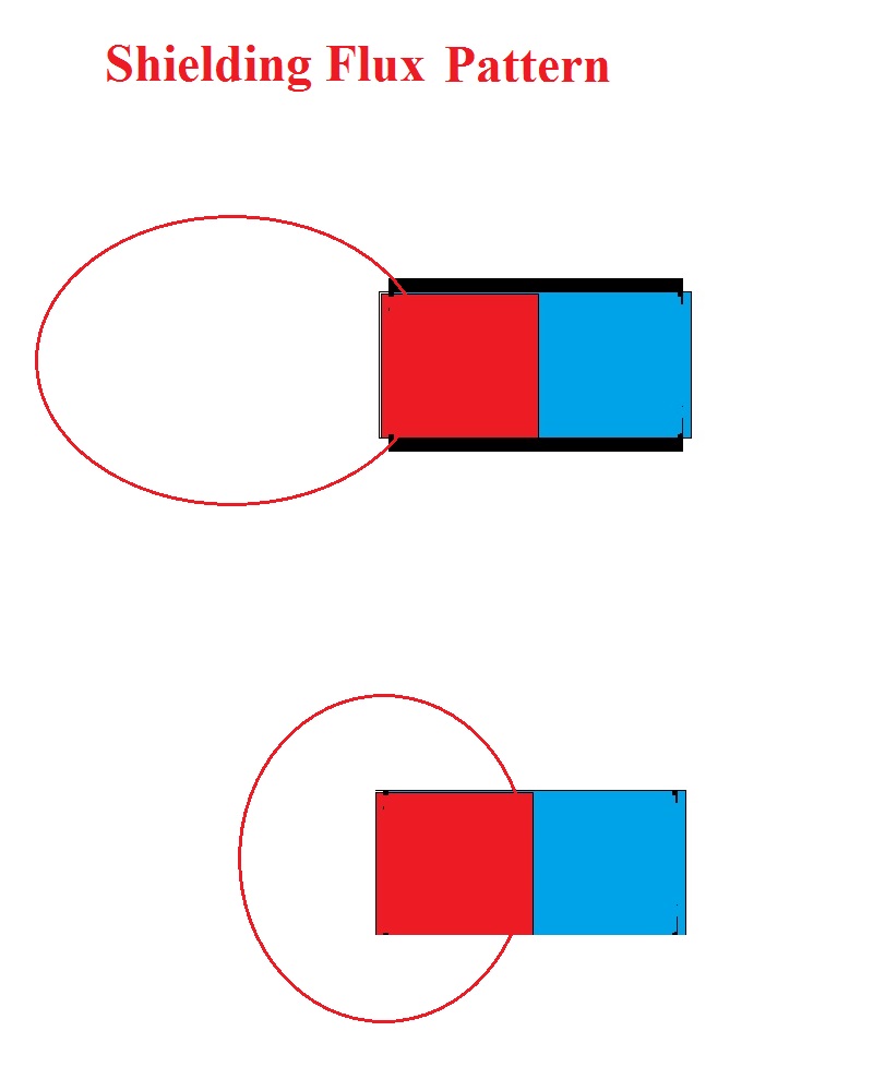

80lbs
https://www.magnet4sale.com/n52-neod...rical-magnets/
1/16" thick shield will not allow the magnet to be pulled back out
of it's socket without a special tool. The pattern shows a better usage
for flux plus will keep overlap down to a minimum for crammed rotors.
56lbs
Just a moment...Last edited by BroMikey; 07-31-2019, 10:41 AM.
