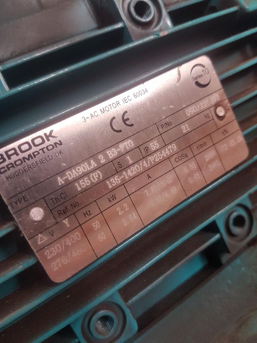

                            • I just gone my first motor this week,
                              looking forward to a winter of building loads of toys....to play with at Christmas...
                              Great to see all these posts here i need to read thru!
                              here's a photo of my three phase motor. (I almost got a 8kw but my thinks start small bod!....well smallish!) 2.2kw....
