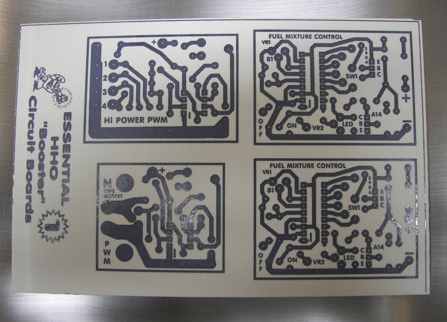

              Board Update!!!!
              Everyone,
              Last night I stayed up Re-Designing the Boards in my PCB Software.....Not because there was anything wrong with "Chemelecs" But just so I wasn't taking his Boards, making them and Offering them for sale......That is against my ideals....
              Im almost CERTAIN all of you will appreciate the way I am going to offer them!
              RedMeanie
              (psst...Don't Tell Anyone, But I'm Really Not Mean!)
              • #22
                Here You Go.....
                Here is a Combo Board.....
                It Has:
                (2) Fuel Mixture Controllers (EFFIE)
                (1) Hi Power Multi Mosfet (Off Board) Pulse Width Controller
                (1) Standard Pulse Width Controller (On Board Mosfet)
                Let Me Know If This Board Would Interest Anyone!
                You Would Just Need To Cut It and Drill Holes (Very Easy)
                Or I Will Have Individual Boards Available Already Drilled And Cut, Unfortunately They will be More Because Of Time Involved....
                I Highly Recommend Getting The Combo Board That way you can save a bunch of money and have spares!

                • #23
                  This is SOOOO GREAT
                  Good job, man
                  Thank you for sharing

                    • #25
                      Looks great! I look forward to an entire kit! (PM sent)
                      Much thanks!

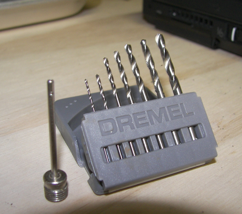

                        @RedMeanie, I'll be visiting my benchstock area at work soon. Which size drill bit do you use for drilling the boards? It has been a while since I have done circuit board level work. Do 0.035" and 0.060" drills sound right?
                        • #27
                          Originally posted by TuxAir View Post
                          @RedMeanie, I'll be visiting my benchstock area st work soon. Which size drill bit do you use for drilling the boards? It has been a while since I have done circuit board level work. Do 0.035" and 0.060" drills sound right?
                          Yes .035 will work that is about right.....I use my dremel bits, Whatever you do DONT buy Specialized bits from an Electronics place....They charge way too much for them.....And since just about everyone here probably has a dremel (Great For This) I highly recomend just grabbing a set of theirs...They are cheap and I have had this same set for years.....
