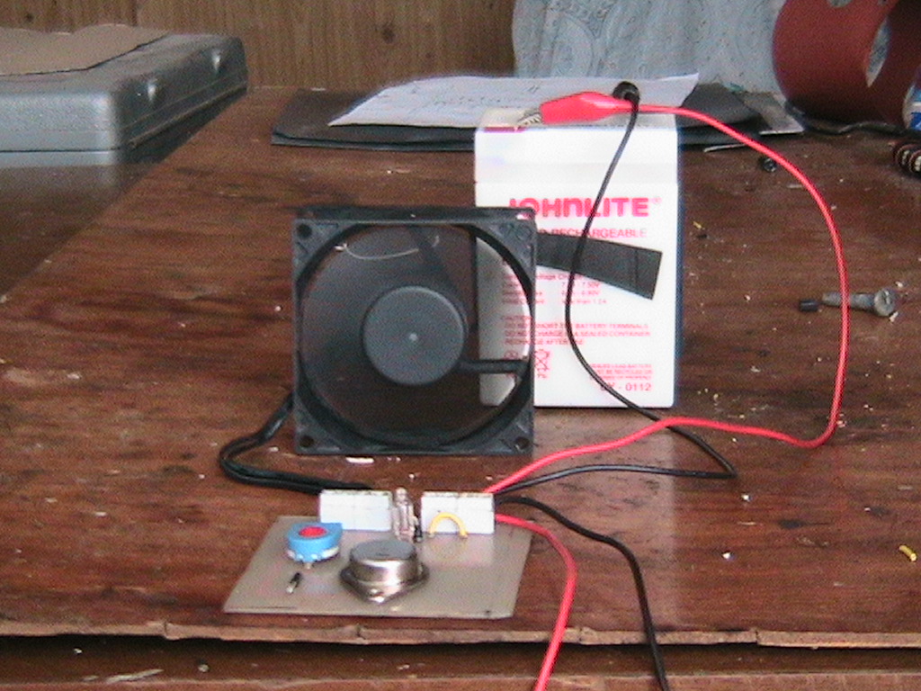

Originally posted by Philosopher View Post[ATTACH]830[/ATTACH]
Here my complete unit.
I'm chargining a 6V 4Ah lead acid battery.Can you axplain me the Bedini rules for the correct discharge of this battery?Thank you.
Excellent. Text book example. Thanx for sharing. Keep in mind that if the battery was sulfated or drained enough it could take literally days to charge it back up. As far as draining, if it was a 12 volt you would merely hook a invertor to it. However since you are using a 6 volt, what i would do is use a standard lamp bulb from a 6 volt lantern (walmart 3 dollar one) and wire the battery to it with clip leads or whatever. Some people have to cycle the batteries several times before they are conditioned where they retain the most amount of charge. For example :
