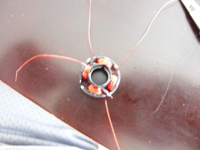

I've pulled a fan apart and rewrapped the stator, cw-ccw-cw-ccw, single strands, 2 wires in total. When I test the ohms of the first windings get only 1.5 ohms. I tested the other and get the same result. Not sure what to think here. Each post is wound 50 times and I am using 30 gage wire. I was able to strip the wire with a wire wrap tool. I have 3 pics for you to look at:
Stator.jpg is the stator windings

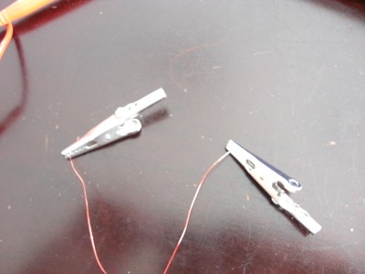

Clips.jpg are the alligator clips attached to the wire I am testing. Meter reading is the same regardless of clips.

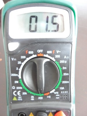

meter.jpg is the meter reading. You can also see what I have the meter set to for confirmation.
