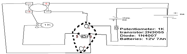

Now i am a bit confused about Trigger and Powercoil.
I did usual name the one, what is at the base as the Trigger. Anyway.
Black and Red is one Coil, and there dont go current through, when it dont runs.
You need to measure between the Case from Transistor and your Minus from Batt.
Thats Collector and Minus.
There is current, at the moment, when the Transistor switch.
If there is current without running, then its wrong connected.
But, can you measure the Ohms from the Coils?
And what Resistor & Pot do you use.
I think, either your Resistor is to high, or your Ohms at the Bifilar is to low.
Does the Coils swinging in a high frequency or low.
The right Resistance at the Base do control the Strenght of the repell.
And dont forget to put 5 Diodes in parallel for charge
