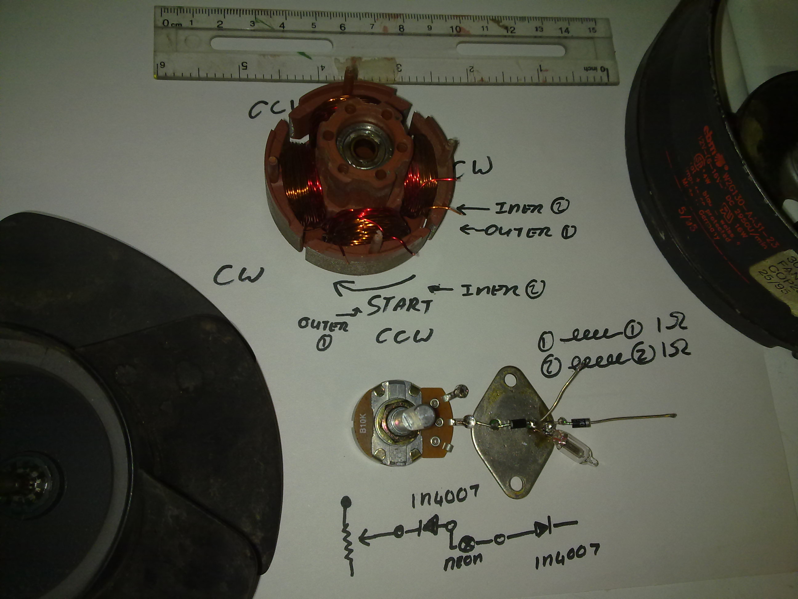

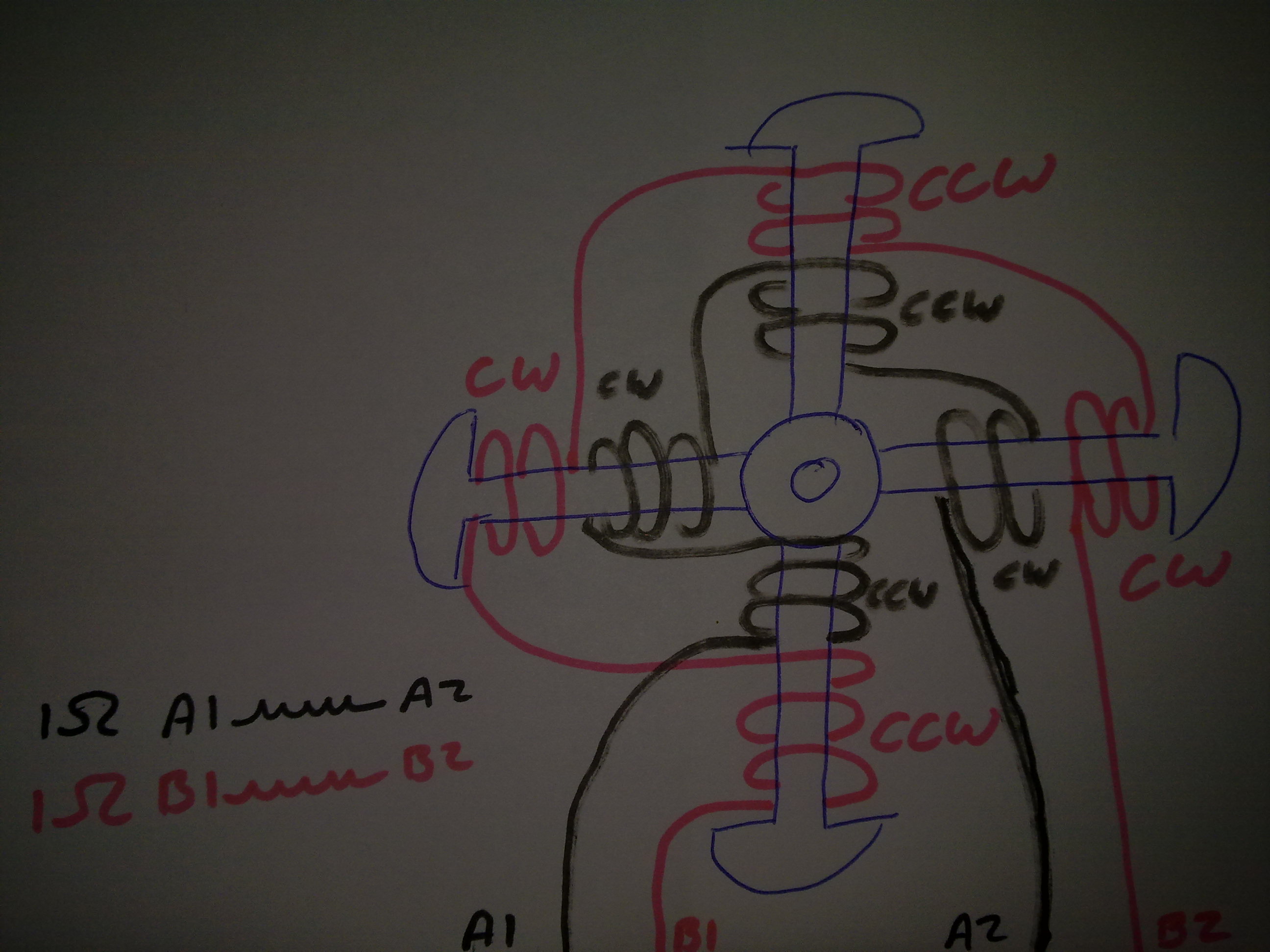

You better seperate the Coils into 2x2,
like Imhotep did show it at his Circuit and his Videos.
When you trigger all 4 Coils at the same time,
the N-S Fields at the Magnet will cancel each other out.
Btw, what is your resistance at your Coils, it should be higher at last, as the Resistance at the Gate.
Ie, coils 10 Ohms, or 5 Ohms,
and Pot or Resistor for the Gate minimum the same or lower.
