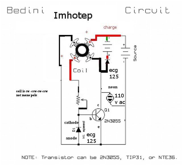

  • I try to make it selfrunning like show in scheme, with black diode and without it, but it not selfrunnig. I use 16 V 10000 uF capasitor.
    If on one stator coil wind other coil and conect to source trought diodes, and from 12 V and then disconct 12 V, it stop seems slower, than without it.
    I think to chare battery beter not modifi fan, but wind on each coil, stator pole, other coil and from it trought diodes get + and - and chare with it battery.

      • Hello,
        Iam not an electronic and just start electronics as a hobbie.Just finished my first project, a Julie thief with success cause of the help i got by reading the forums
        Now iam trying to build this bedini-imhotedp motor and cant find the right diodes(ECG125) locally.
        What i found is a IN4007 diode.Is the IN4007 going to work if i use it?
        or you can suggest any other diodes to work with ?

          • Fan not spinning
            Hi All,
            I am new to this forum and really liked its projects.I like Imhotep,s Bedini Fan project and tried many time but no luck even changed fans with bigger size.My components are 2 1n4007 diodes,1 2n3055, 5k gain and 1 100 ohms resistor and one 12v 2Ah battery dead for charging.My fan only turns one but not spinning.I checked my components which seems fine but not working.Any help will be really appreciated.Thanks in advance
              Hi jas2010 did you wind the coils one clockwise and the other counter clockwise? If yes do hear a squel from the coils?
              Did you try to push the fan to start?
              Check these first.
              • @ Guruji
                Thanks for reply
                Well actually i havent wind the fan coils but modified as separated coils according to Imhotep,s video.Also try to push fan but nothing happen s .Also i want know that how i drive fan,I mean circuit diagram to drive hard disk motor,floppy drives motors etc.Thanks
                • UF4004 diode (ultra fast) seems to work pretty well from collector to charge batt. Produces higher Voltage spikes than 1N4007. I have not tried schottkys.
                  • Jas
                    You only make actually 2 Coils. 1 Coil triggers the Transitor at the right Moment.
                    The other coil pushes the Rotor magnet.
                    At the Fan, you bind 2 Pairs to one Coil.
                    When your Tranistor dont open at the right moment, only switch the Ends from one Coil,
                    like the one at Minus and Base from Transistor.
                    You 'drive' the Rotor with the Resistance at the Base, but adjust it to highest Rpm and lowest Amp draw.
