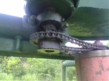

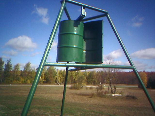

Our windmill uses a savonious rotor design based on a south pole weather station 55 gal oil drum that I read about in a windmill book purchased from an ad in populer science back in the 70's.
it has been in constant use for over 4 years and the only maintainence is to oil the chain and thrust bearings 2 times a year.
the rotor seems to never go more than 300 or so rpms and has done fine in a few 60 - 80 mph wind storms. the main drawback is it doesnot start below 18mph winds.

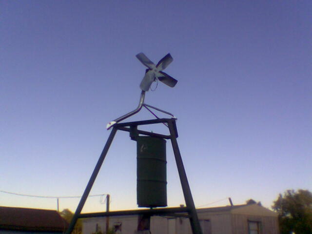

The next addition will be a "starter" standard rotor design to assist the larger rotor in startup.
