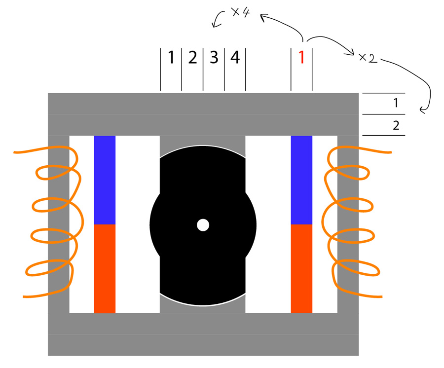

Originally posted by Jetijs View PostHere is the file:
You should be able to view this file with no need for additional software. The bolts and nuts there have no thread, because I have not learned to draw them yet, also it is not important.
If you have Solidworks with Toolbox installed you can simply use standard bolts and nuts that already have predefined threads (you can easily modify those files).

I didn't quite understand that out sourcing part (my english could be better). I tried to fiend some commercial rotor/stator cores that I could use for our purpose, but I could not find anything online and when I visited the local motor rewinding company, all they had was simple induction motor cores with many poles that are very hard to wind like we need and even harder if we need bifilar windings. So I figured it would be easier to make a stator/rotor core by myself exactly as I need them. I bought some 0.35mm thick sheets of silicon steel from the motor rewinding company and gave them along with my CAD drawings to a guy, who works in a local laser cutting company. Now I have to glue/bolt the plates together in needed thickness. I already finished the rotor piece, tomorrow I will work on the stator and if everything will work out fine, I will post some pictures.

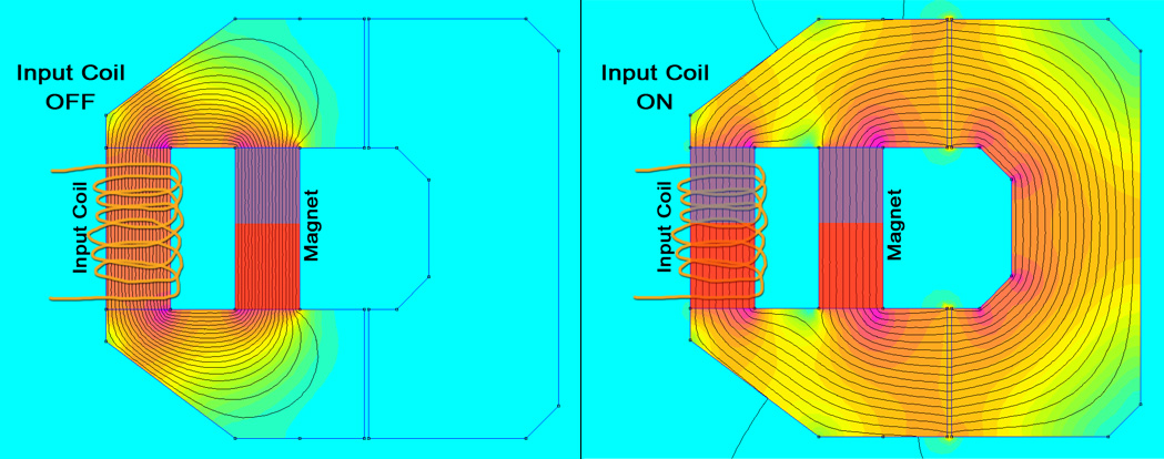

Hi there Schpankme,
No since its field will just latch onto the secondary C core at the moment when gets close to it. And besides that you don't want a coil over a magnet since the permanent magnet is just that, 'permanent' and you are not supposed to enforcese a magnetic field directly upon its structure, if you do you can/will waste the magnet.
So as in the video what you want the flux from the magnet to be 'steered' to add to the overall strength of the coil's initial input field. What you want other words is that the coil on the main core section will 'saturate' that core section onto it is wound. So when that happens the flux from the magnet must seek another 'path of least resistance' and will jump the air gap (paper) and will go trough the secondary core. So this will add to the magnetic field of the coil. And when the coil is turned off, the field of the magnet will return again to the primary core as a preferred path of least resistance. So the secondary core is again free to move.
See the attached picture.
Steven

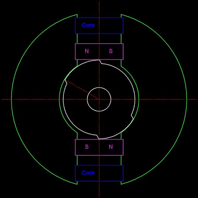

The next question would be saturation of the rotor; on a dual valve, 22 inch DIA motor, with 3 inch DIA shaft. The picture attached shows a 10 inch rotor and 6 inch magnets. The core is spec'd at 3 turns of #4 wire (0.39 O.D.) 420 feet.

Hi there Schpankme,
I have seen your questions on overunity.com as well.
The motor you have drawn can not work. Since the permanent magnets will just couple together and stay that way. The two magnets in your design should be repulse to each other. So flip one around.
You must understand that the rotor should have a usable cross section that is equal or somewhat more then the cross section of your two coil/cores and magnets together. This is why Hildenbrand said that the rotor did oversaturate because he did not make his rotor big enough (that is, big it enough cross section accommodate all the fields at one time).
And when I look at your motor I see that the finger of the rotor is only wide enough to accommodate the flux of one coil/core and one magnet. So you need to increase the rotor finger width twice as wide as it is now.
In the attached picture you see a motor with the proportions about right. Remember to give a little overhead, and so have the rotor a little wider. And keep the coil/cores about the same cross section as the magnets. Just like the image.
