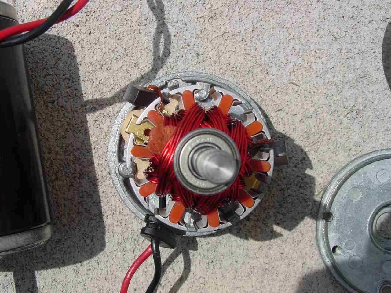

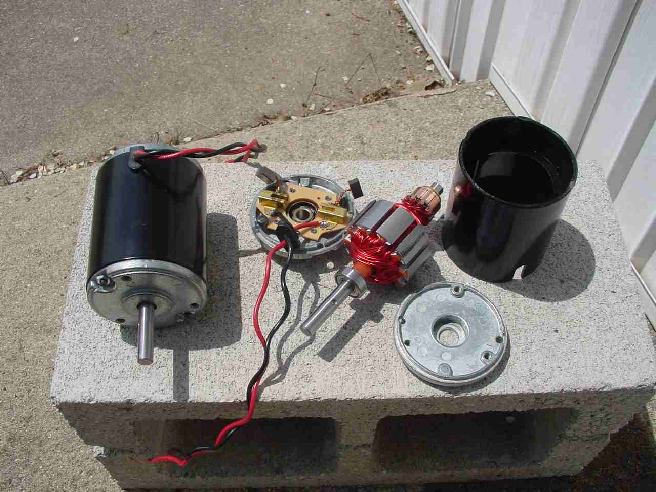

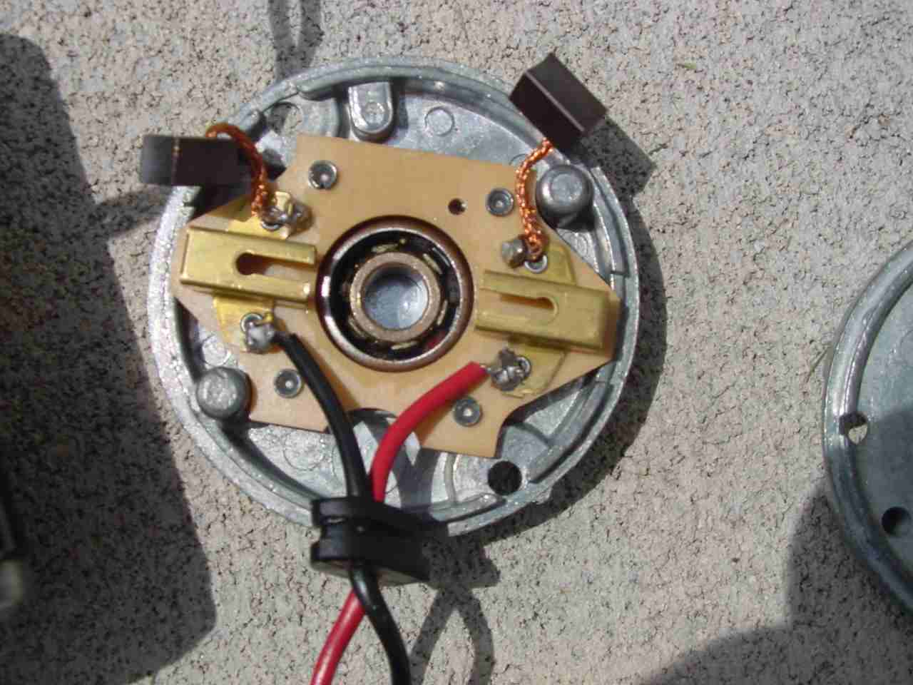

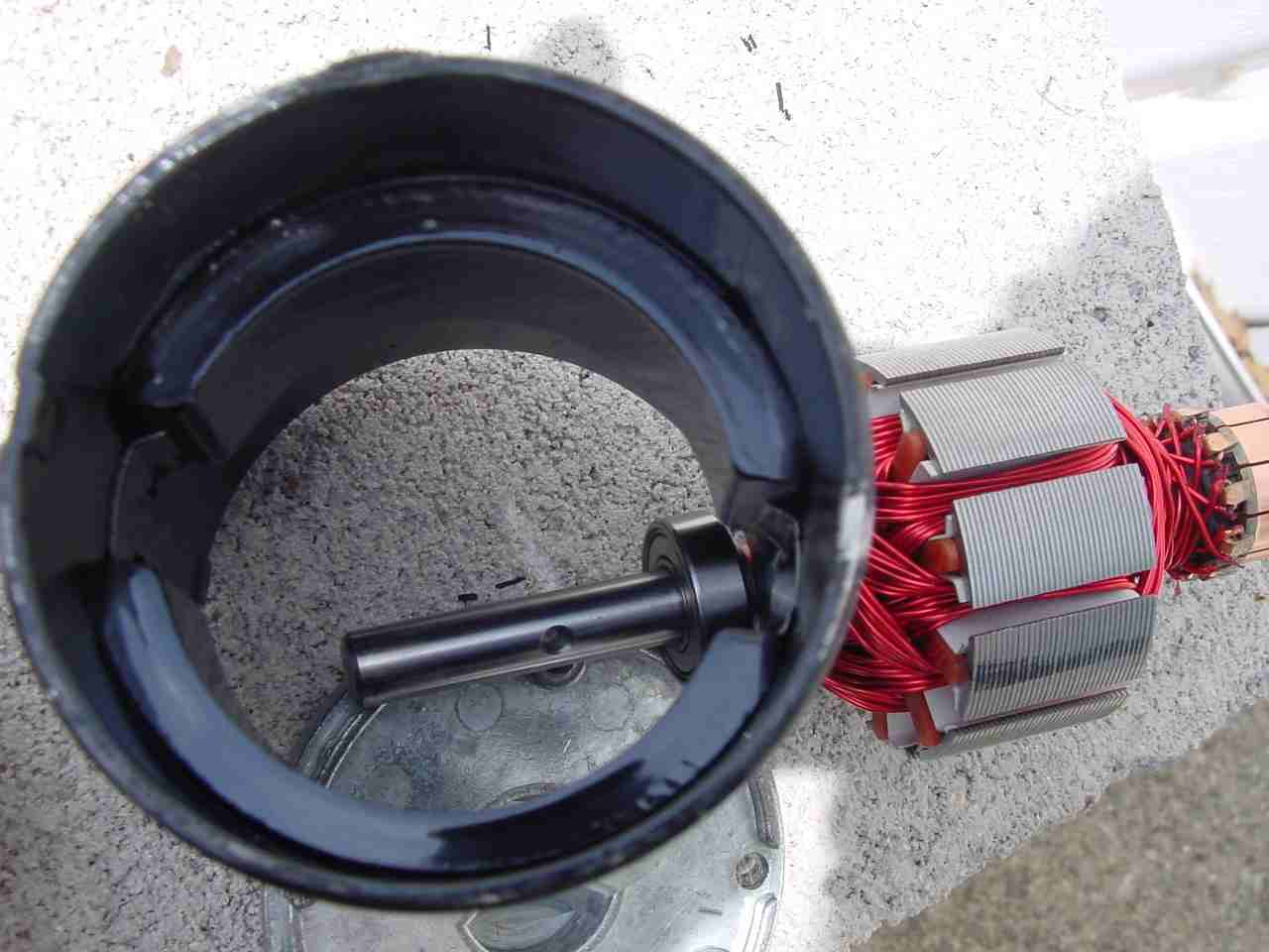

                              • Replicating Elias motor...
                                I have picked up 4 cheap $4.00 each dc motors, that I hope to convert to Peter's style of motor. This is a permanent magnet motor, so, my plan is to pull out the magnets and to place in some hand wound coils.
                                This is a 12V over 3,000 rpm motor not much torque as it is now.
                                The commutator sure put drag on this motor, I am surprised it put out as much as it did with this much drag.
                                Anyhow.... will cut off the coils and plan how I will cut down the stator.
                                Mart
                                See my experiments here...
