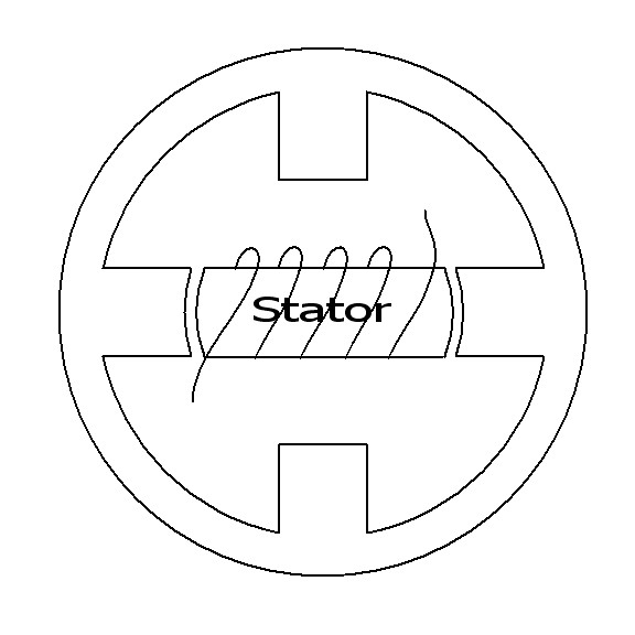

But if the outer is spinning around the stationary inner Coil then commutation will become difficult indeed. The rotor would have to be drum like , and have to support the entire rotor from one set of bearings. One end would have to be left open or have a bearing large enough to allow the stator wires to go through the bearings to the Stator. This could be done via a slot grooved in the stators stationary shaft. Now I think this motor will run but will have very little if any torque. And the larger the spinning drum the more so. Think of it this way, a fairly heavy wheel solidly attached to a axle is easier to stop from spinning by grabbing the outside of the wheel than to stop by grabbing the axle.
And at those gap sizes, ordinary bearings might not be suitable and precision bearings should be used. This adds a little more drag but you don't really have a choice.
