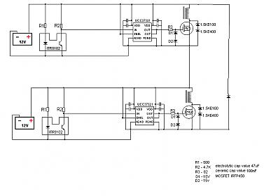

I missed your post. Yes, the inductive spikes will be collected and sent into the primary capacitor so that much less energy will be needed from the power supply. In my previous schematics you see just the driving circuit with no recovery part. This is the exact reason why I am using bifilar coils, because one coil will be used as primary power coil and other coil will be the recovery coil. You have to use bifilar coils in order to get the output right beck to the input. You can also use just single strand coils, but then you will have to send all the inductive spikes in a second battery or somewhere else. Here is the circuit with the recovery part (this is for the V2.0 motor):
Started testing the circuit. Found two problems. One set of two MOSFETS has the UCC37322 MOSFET driver and not UCC37321. This is an inverted output driver, so two sets of MOSFETs are working in inverted mode
I don't know how I could make such a mistake. Also one of the rest six MOSFETs has and transil diode across the drain and source that is rated at 100V and not 400V as the rest. This makes the MOSFET oscillate in low frequency rather than turn it steady ON when the optoswitch triggers. I can easily chanfe the transil diode, but resoldering the inverted MOSFET driver will be hard if possible with the equipment I have. I guess that I will rather just disconnect the inverted driver from the rest of the circuit and solder another non-inverted driver somewhere else on the circuit board.
Edit:
No, the transil diode on that one MOSFET was not the cause of the oscillations. I guess that the MOSFET is just dead.
Edit: Yes, te MOSFET was dead.Last edited by Jetijs; 02-19-2009, 01:39 PM.It's better to wear off by working than to rust by doing nothing.
