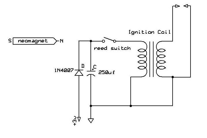

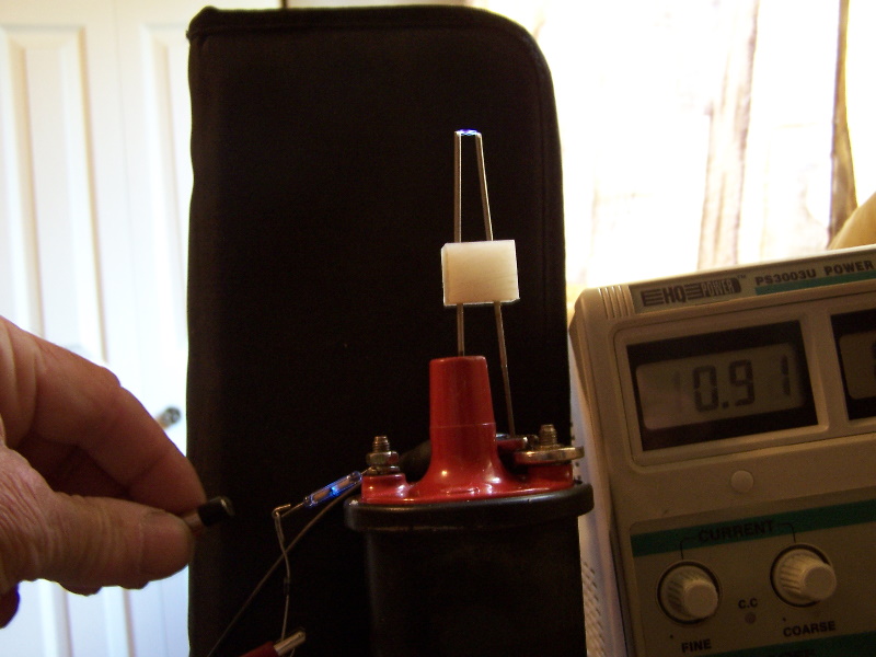

It became apparent that the Magnetic Flux was responsible for the Gain and I thought of a way to do that by subjecting a Reed Switch to the Magnetic flux,thus I would have no electrical connection to the magnet at all.
I got a pleasant surprise!, not only was I able to draw a 5 mm arc from a 12Vdc automotive coil at 3 volt but there was no need to use a timer or other electronic device to achieve alternating contact closure within the reed switch Glass envelope.
Arcing and rapid switching of course raises a havoc with the Switch contacts so I tried to bypass the Switch with a .33uf cap.
Although the arcing was lessened the contact now just welded together within a second.
I then paralleled the switch with a 27VDC Zener which reduced the Arcing but it reduced the output by more than a half.
The same happens if you are using the south pole of the rod type Neo Magnet. You must use the north approaching the end of the switch.
I have 50 of these switches so I kept destroying them by trying different approaches. At full 12.6 VDC I drew arcs about 8 mm but the switches would'nt last.Current Limiting and running them at 3 to 6 VDC kind of makes them last a little longer.I have made a video of this but it seems that there is not sufficient Bandwidth on this forum to post it.
