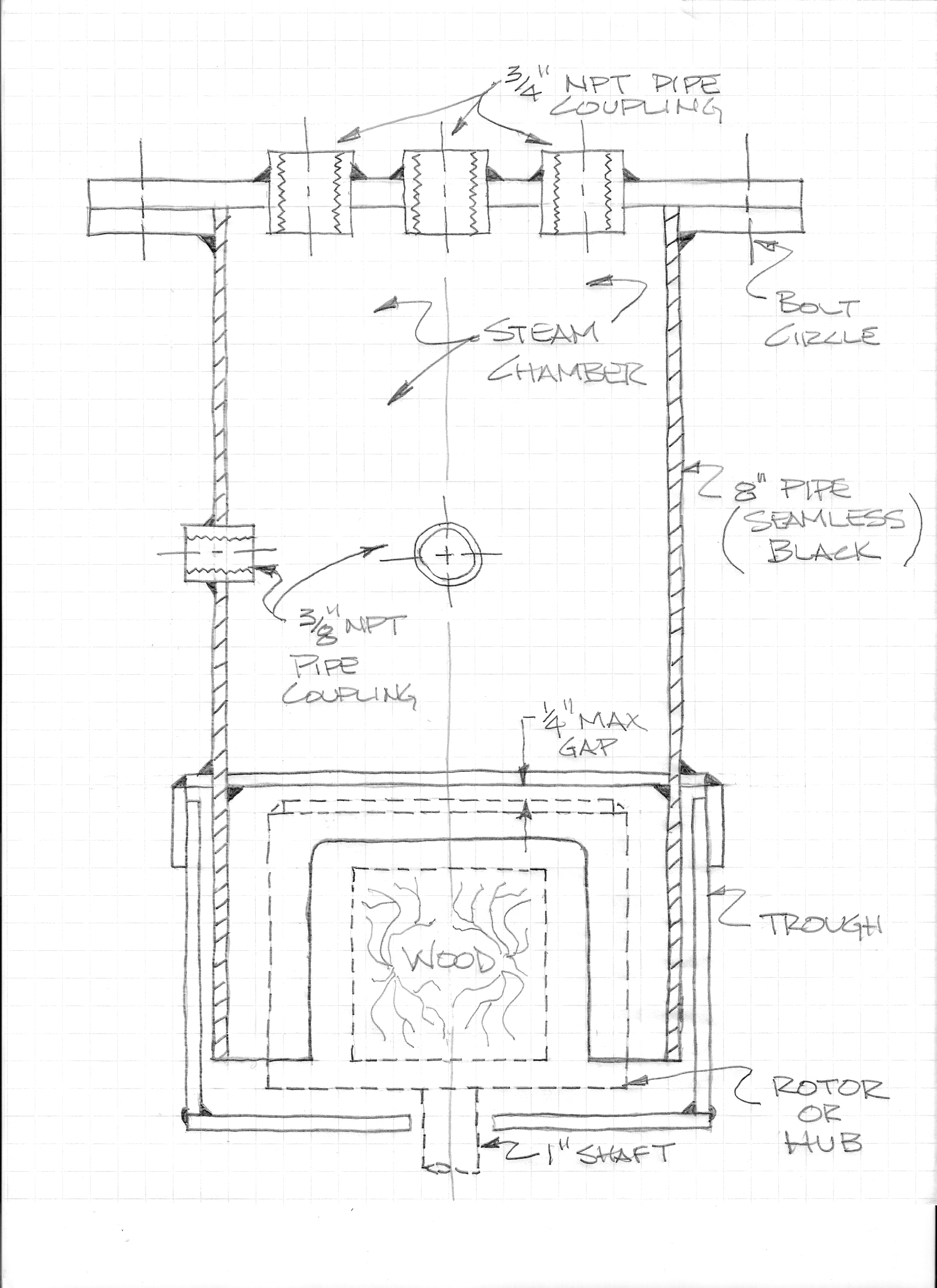

                  In post #44 I suggested modifying the trough box to accommodate possibly extending the boiler steel at 90 degrees to the wood to increase the heat transfer area possibly by 100%.
                  Here is a "cut section" sketch of what I was thinking about using 8" seamless black pipe with 3/4" couplings for the steam fittings on a blind flange and 3/8" couplings on the 8" pipe for the drip assembly inside the steam chamber.
                  This type of assembly could easily accommodate 150 PSI if assembled and welded properly. Then using available pressure rated fittings and devices for the final steam and water drip connections.

                    Actually, I think it was post #44 where you first mentioned the idea of extending the steam vessel sides to surround the rotor hub. Thanks for your drawing of the concept. It actually looks very close to what I was describing in post #60, as quoted here: "For example, a heat containment box could be constructed with walls that extend from the steam vessel box to the base of the trough, and would fully enclose the rotating metal hub. Cutouts, just slightly larger than the wood 4 x 4 dimensions, would be made in two sides of the containment box, allowing the wood to feed through the openings, and employing very light pressured scraping blades to restrict nearly all flow of heat into the troughs. With all heat development contained and focused in the center section of the trough, this would seem to produce even more amazing results than has already been demonstrated."
                    The only differences between your drawing, and what is quoted above, is that I proposed extending the steam vessel box sides all the way to the base of the trough, making the cutouts slightly larger than the wood 4 x 4's, and suggested the use of scraper blades at the openings. I'm just thinking that we might as well seal off as many pathways of heat escape as is possible. Any heat that escapes to the troughs is wasted heat if our aim is to generate steam. With the cutouts made as 4.25" squares, this would leave a 1/8" air space on all sides of the wood to accomodate irregularities. Then mount spring loaded scraper blades to the perimeter of the openings, allowing them to further restrict the openings to a 4" square. The scrapers would contact the sides of the wood piece as it is being fed, but with very light pressure so as not to create any drag. The broad side of each scraper blade would rest against the exterior wall of the box extension, effectively restricting airflow. The leading edge of each scraper should be rounded so as not to bind on rough sawn wood irregularities. Better yet, the scrapers could be made of angle iron with the leading edge bent upwards. Here's a drawing showing the basic cutout and scraper concept:
                    Note that if installed as depicted, there would be small openings exposed at the ends of the short scrapers whenever the upper and lower scrapers move outwards to accommodate warps, knots, or other surface irregularities. The resultant air loss would be minimal, though, and could even be eliminated by application of a 1/2" by 5" metal overlay on the short scrapers, which would overlap the ends of the longer scrapers. There would definitely be room enough to accommodate the bottom scraper, because Lloyd's design calls for rollers to be placed beneath the wood, which would elevate the wood somewhat above the bottom of the trough.
                    Just some ideas to consider, and this should at least give you a visual idea of what I am writing about.
                    Thanks for your drawings, Glen. They are greatly appreciated. Best regards to you,
                          Rick
                          Hi Rick,
                          When I was thinking about the boiler design and left the sides open as shown it was because of the possibility of the use of non dimensional lumber or wood with three or less sides 1/2" out of square as fire wood is. The scraper idea is a very good one but I'm also really concerned about the vibration and chattering possibility of the wood on the whole machine. When I was looking up some information on some sealing and insulating materials for the wood access doors and boiler assembly on the trough, this is what I found surfin, a really good web site on "Specialty Insulating" products.
                          Great Lakes Textiles - Manufacturing and Marketing a Broad Range of Insulation Specialties Throughout the World
                          There are several products of interest that could be used for insulating and the door seals. There was also some products that could be used in place of the scrapers that you suggested is the "Fiberglass Lagging Tape" used like a flapper end cuts at 45 degrees like a picture frame.
                          This comes in 1"-12" wide x 1/32" - 1/4" thick strips , they also make a "Tadpole Tape" that also looks like it may work. (rated at 1000 degrees F) This would stop any scraper vibration issues and provide a good seal around the out of square friction wood that maybe used.
                          And now a barrier with scrapers or flappers is between the hub or rotor on each side of the trough assembly, I'm thinking maybe of using a 1/2" or 3/4" thick sheet liner of "UHMWPE" on the trough bottom, instead of rollers for the guide and rail assembly the friction wood rides on, because of the reduction of heat transfer inside the trough.
                          Just some ideas .....
