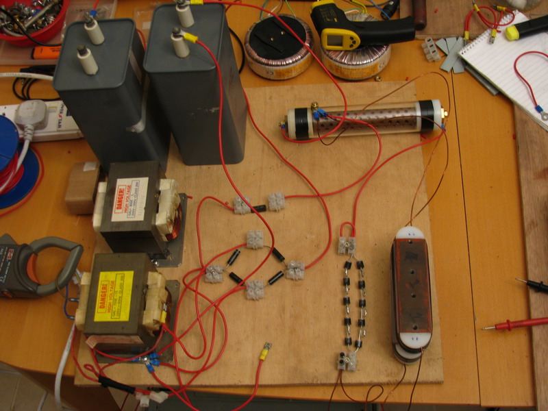

Hi everybody,
I have been following this forum for a long time now, but have not posted comments as I was still in the fabrication stages on my gray tube and motor and didnt feel that I had much to contribute.
I now have the motor mostly completed, and have manually "test fired" a set of magnets on the bench. Each magnet weighs 2.1 kilo's so that is pretty impressive. The motor is configured with 3 magnets on the rotor, and 9 on the stator.
My problem is that I CANNOT get the tube to fire through the diode #28 (with or without the grid connected). I have attached a picture of the setup to show you.
The MOT is supplying 2800V, rectified by the bridge (microwave diodes), and supplied to the 4KV 4uf capacitor. The capacitor is connected to the HV rod of the tube, and the magnets are connected to the grid. A microwave diode is also connected to the grid as as diode #46.
I originally had a microwave diode connected to the LV of the tube, but could not get an arc across the gap when I switched the diode. Although the diode tested OK, I replaced it with the 6A 1000V diode strings in the photo.. but still no arc when the diodes were switched through the battery!
If I bypass the diode, and switch the LV rod to ground via the battery the gap in the tube arcs..!! However, this will not allow the tube to work with the time compression as described by Aaron.
I do not have silver tips on the 1/4" brass rods in the tube yet, or the carbon resistor, but everything else is as per the patent.
If anybody can help me out with some advice, or tell me what is wron, I would be very grateful; I have spent days on this now, and I am totally frustrated. I am sure that it must be something simple - but clearly in my case the diode #28 is blocking the HV path to earth before the Arc can begin.

I can't tell exactly how you are setup, But it looks like you have two wires from the coils running to the grid. Anyway, if you setup sorta like this diagram then It should work. Imageshack - woodshadejpg.png - Uploaded by Ghst Just note that the red wire from the bottom of my setup is actually from the grid. The electrode in the side is the low voltage. I have even jumper wired the high voltage across the tube to the capacitor (straight from high voltage to the capacitor) it will still discharge as long as the the high voltage potential is introduced into the tube and has a ground path.Last edited by Ghst; 11-07-2009, 12:06 PM.

Hi Ghst, Aaron,
Thank you very much for the replies.
I looked at your diagram Ghst. It is very clear, but quite a different setup to Grays patent. I will give it a go with my tube, and see what it does.
I am really interested in the auto coil switched by the chopper. I saw that someone (Aaron I think) posted a design for this a long time ago. I would like to try it, but my concern is that the coil will develop too high a voltage on the circuit, and blow my cap(s) (very expensive if that happens). It would be great to run that system if it is reliable, as the MOT is only suitable for short term testing. The voltage is too low, and the device is too inefficient. If there is a reliable design for the auto coil circuit that people are using I would appreciate being pointed in the right direction.
But for now.. if we forget about the grid for a moment; my tube will not arc between HV, and LV rods, unless I bypass the diode 28.
I am assuming Aaron, that you suggest that I take the tube out of the circuit, and insert a spark plug between the HV and the cathode of the diode - and see if that sparks when I ground the anode of the diode? Ok. I will pick up a sparkplug, and try that tomorrow.
I have attached a schematic of how I connected the tube for testing for your information. From all the posts that you guys have made, the circuit should work??
FYI. The tube has 6mm brass rod for HV, LV. The gap between rod and first copper grid is 6mm, and the gap between first and second grids is the same. The rods are threaded to adjust the location of the gap, and the gap spacing.
I look forward to hearing back from you.Attached Files

Hi Crunner,
I looked at your diagram.
This is what I would try first.
1. Remove the 15kv diode at the bottom right of your schematic. Just have
the grid pickup going straight to and only the coils. If you have anything
else connected to the grid, it should be an overshoot gap, which you will
probably not need at the moment.
2. Wire the coils in series and flip one so they will repel. The way you
have them wired now, they are essentially short circuited and you will
greatly restrict the ability for the magnetic fields to collapse quickly.
3. Take the coils straight to ground and bypass battery #2 for now.
Having a battery behind the diode at the LV rod is very difficult to get to
work. I have only been able to get the effect that way only a few times.
It would be almost guaranteed to work if you replaced batt #1 with a
capacitor and have a separate power supply charging it to a few hundred
volts at a couple hundred uf's rating. I know this isn't as elegant as the
battery method, but at least you can get the system running and move
towards optimization later.
I hope this helps.Sincerely,
