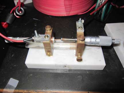

For these experiments only two kinds of electrodes were explored. The first was pointed tool steel opposing a 1/4" blunt tool steel surface (the micrometer). The second was a short section of #12 AWG solid copper wire. Not a whole lot of difference was observed with either gap in this test.

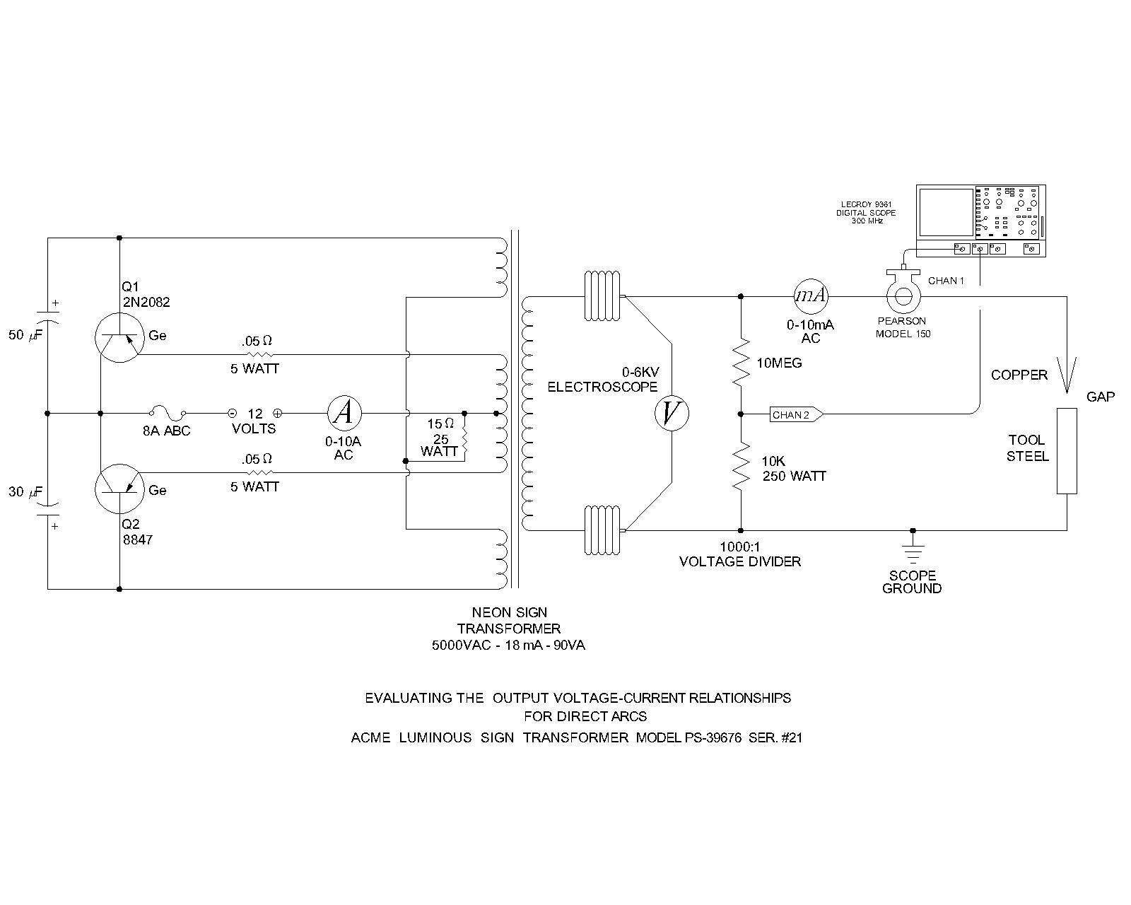

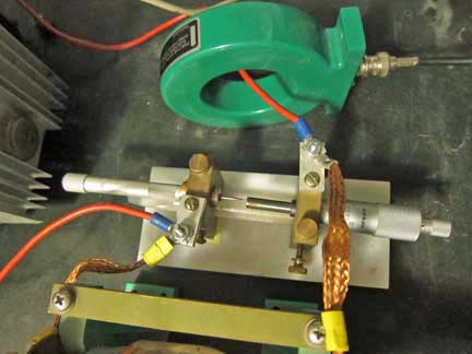

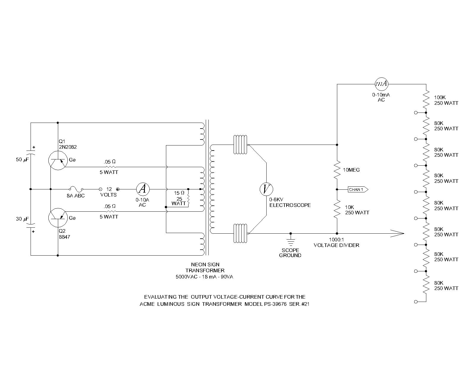

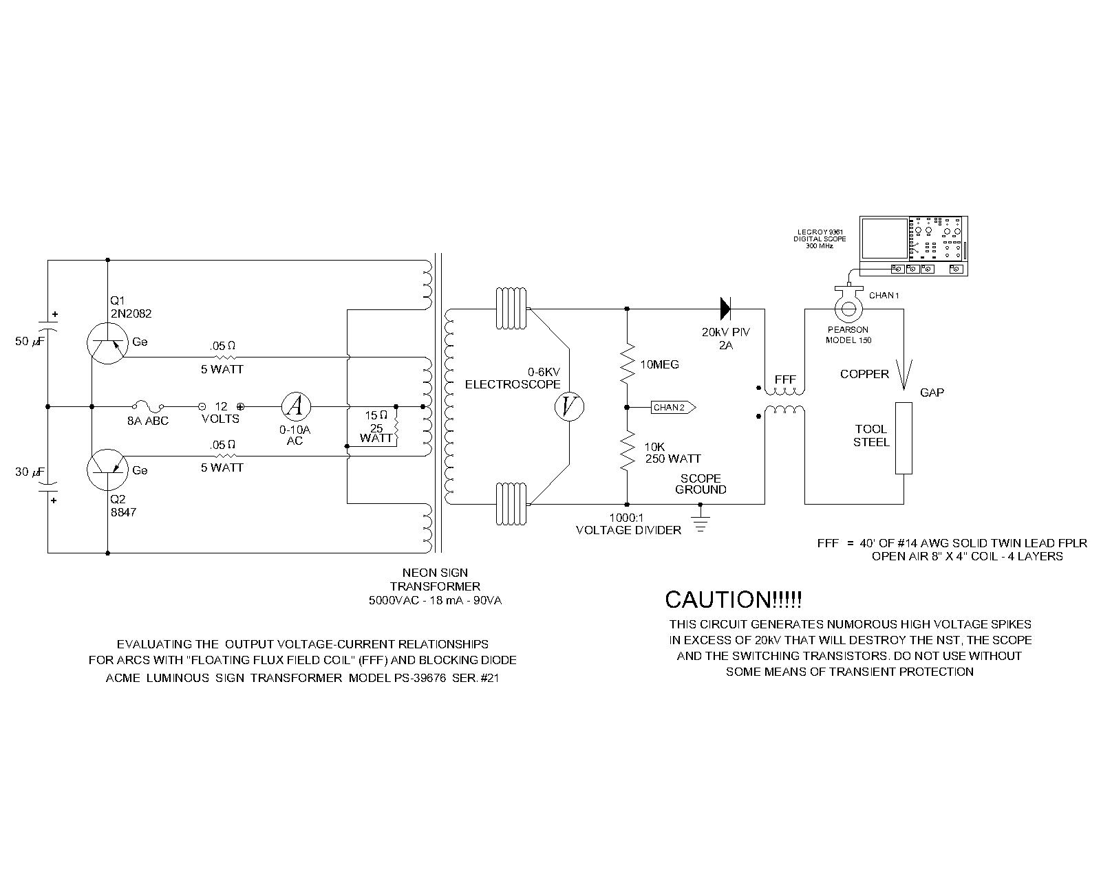

The purpose of this experiment was to just observe the basic voltage and current wave forms. A Pearson Model 150 wide band current transformer was use to make the current measurements. A 1000:1 voltage divider was used for the voltage measurements.
Once the arc strikes it stays burning until the end of the power supply cycle. The average secondary loop current operates at its maximum listed value of 18 mA. The voltage across the transformer drops down to a steady state value that is flat during the burn time. In this case it was observed to be around 500 Volts. This value changes with the width of the gap. Longer gaps cause a higher steady state voltage.
Scope Trace D012 shows the current with a 0.100" gap. This trace shows that at time something happens and the linear current becomes very turbulent. It is unclear just what is going on during these events.
Scope Trace D011 is the voltage across the gap/transformer with the same turbulence showing. Notice the voltage spikes that manifest during switching transitions.
Scope Trace D017 is the impact of a loop diode on the current flow. The Pearson transformer automatically adjusts its zero base line so that the waveform has equal energy above and below its own reference line. So one must adjust how they look at this data. As you would expect; the diode causes arcs during a 50% duty cycle.

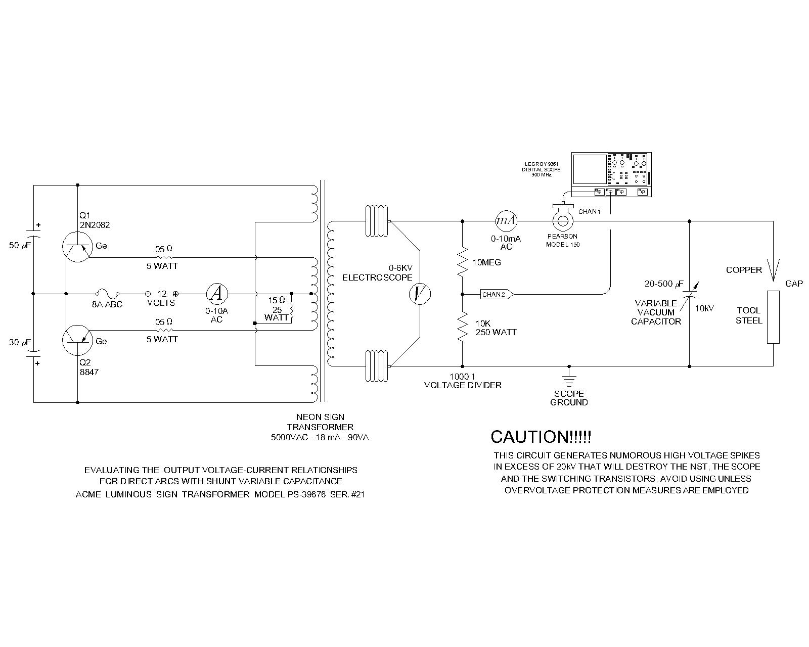

Mr. McKay, is the destruction of NST transistor still happen if the NST is only connected to variable capacitor without spark gap ?Originally posted by Spokane1 View PostWhat happens when some shunt capacitance is added to the NST and a gap? Well, in my case it blew out one of the switching transistors and took the fuse with it. Fortunately the windings seem to have survived. I didn’t even have time to copy a scope trace. It just so happens that I had a replacement transistor on hand or else I would be building a new switching circuit.

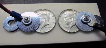

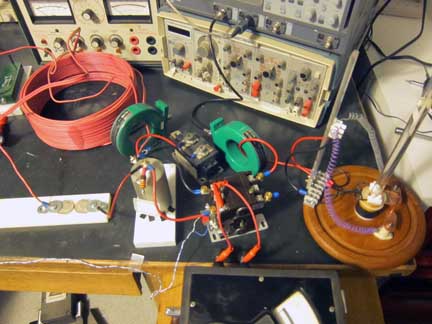

I did better than that. I used two (2) each 1964 Silver U.S. Half dollar coins mounted on a strip of Delrin with a 0.050" gap.
Using two different spark gaps I charged a 5 uF capacitor to 2700 volts (using the FFF and a diode). Then I discharged the capacitor through my popping coil apparatus. This was done with the copper - tool steel electrode and then with the Silver-Silver electrode.
The results were exactly the same +/- 5% between the two approaches.
This tells me that the electrode material may have some kind of performace improvement but it is not the central "kernel" to this technology.

Capacitor Only?
Dear Wicaksono,Originally posted by Wicaksono View PostMr. McKay, is the destruction of NST transistor still happen if the NST is only connected to variable capacitor without spark gap ?
Wicaksono
I'm certainly not going to try that with that goal in mind.
However, I would speculate that the spark gap is required to generate the destructive spikes.
In reading books on Neon Sign technology I notice vague references to the problems associated with two much stray capacitance associated with supply wires that are to long and to close to metal construction. The result is escessive loading on the NST. Since the NST is suppose to run at 80% of its full load rating it doesn't take much to push into 100% of full load rating.
However these books don't go into detail as to the actual electrical impacts on the circuit.

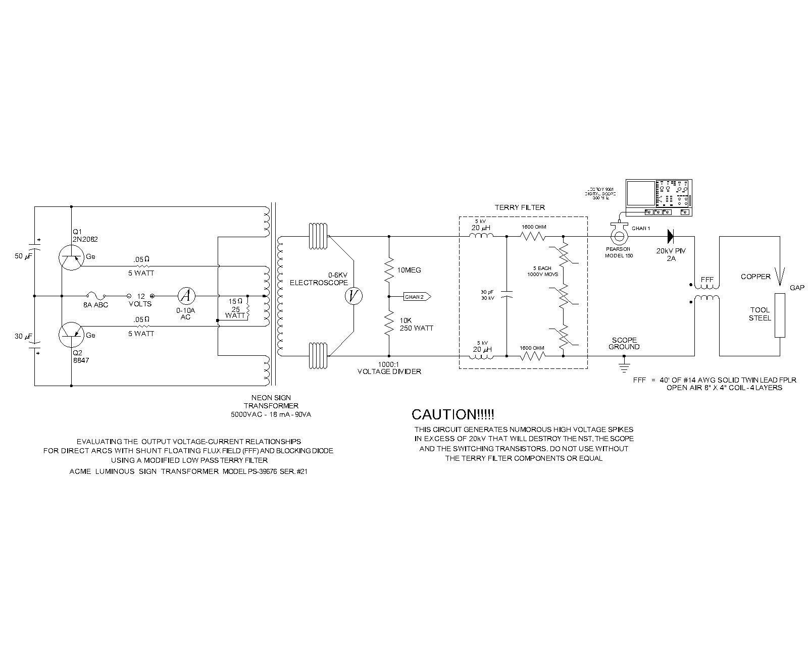

Mr. McKay, how about using materials other than copper as electrode (iron, steel) and see if the spikes disappear ? Thanks.Originally posted by Spokane1 View PostOperation:
At least the circuit doesn’t impair the operation of the NST and the formation of disruptive arcs, however despite all the added components the spikes are still not eliminated, however they are mitigated somewhat. They do seem to be greatly reduced in the positive polarity but seem just as stron in the negative swing.

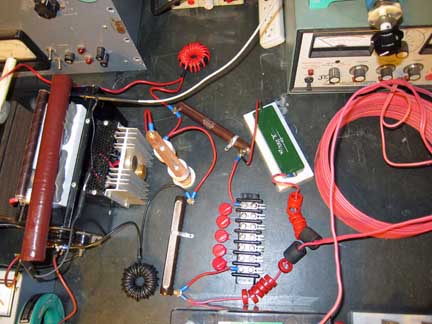

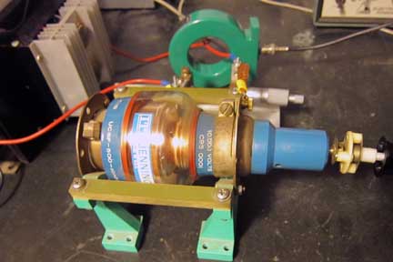

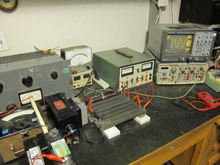

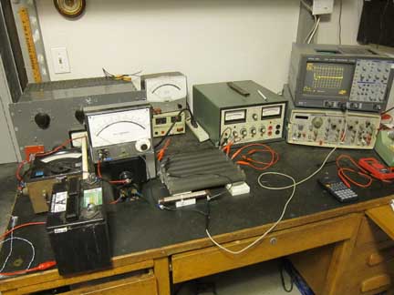

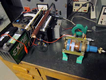

Here are some photos of the experimental setup used to evaluate various kinds of metal electrodes.
The thought is to charge the capacitor with the current that flows through the arc. Then discharge this stored energy through a small "popping coil" appratus. The conversion efficency is less than 1%, but I'm looking for relative improvement. So far I haven't found any.
