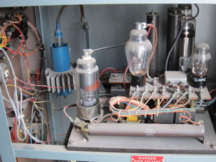

The attached photo is from an old 50's - 60's spot welder. It employs the very same Ignitorn that Gray used and is fired by 2 Thyratrons. For a spot welder the repetition rate is very low. At most 3 Hz. and more typically .5 Hz.
The GE Gl-7171 Ignitron is the blue can on the left. The two large vacuum tubes in the center are the Thyratrons. This appears to be a cascade approach with the smaller capacity Thyratron (center) driving the larger capacity Thyratron (left of center). The Vacuum tube in the right rear is a HV rectifier with a PIV of about 2500 VDC. The smaller vacuum tube on the right is most likely a Triode.
These are the kinds of components that I would expect that Nelson Schlaft was confronted with when he was hired to "Make the Motor's Work" in late 1980.
There were not a lot of cheap solutions to switch HV at the rate and power levels that Hackenberger needed in the 70's (thus the need for the CEST approach). However, these kinds of devices were plentiful on the surplus market. For Hackenberger in the late 70's it didn't really matter if the thyratrons would not be used in the final application. He was attempting to improve the Free Energy Engine and was focusing his engineering efforts in other more productive areas. This part of the circuit could easily be upgraded with newer components in future versions.
To me this strongly hints that the non-classical conversion process does not take place in these components. To me the CEST was an attempted replacement for the Ignitrons, but didn't work well enough. Therefore the CEST was not the seat of the novel Free Energy creation. But this is just my opinion and not fact.
For me I'm using mechanical contactors to discharge my storage capacitor for single shot experiments. When I get to the point where I need higher repetition rates I going to upgrade to HV SCR's, provided that they can effectively switch the novel energy particles that I speculate will be stored in the capacitor.
Mark McKay
