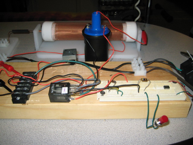

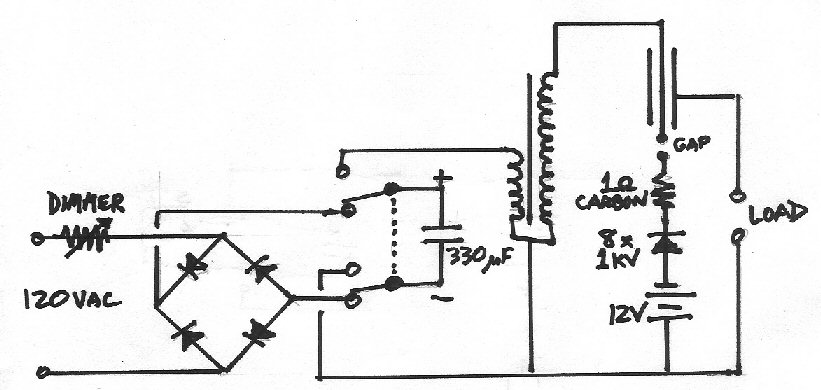

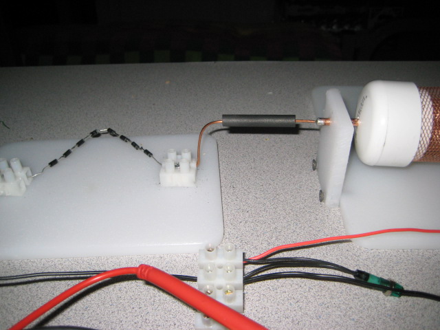

            • Gray tube progress
              Here are a couple pics and a circuit of what have on my bench. Again, I'm not looking to recreate the whole motor, just trying to see some radiant energy on the grids.
              Right now the circuit is just set up to single fire the spark. The HV coming off the coil I estimate to be about 8KV... which will jump about a .25" gap. When I put a diode from coil primary to HV, I can get a nice plasma spark. I used a carbon rod from a D-cell with smaller gauge wire, since I was unable to bore a hole for the large rod without shattering the carbon. I'll need to get a larger block of carbon.
              Recently I have added the reverse biased gang of diodes on the LV anode, and a 12V battery to give the diodes an initial forward bias. I also have a magnetic field shroud to place over the gap if I choose to. The gap I'm using is generally 1mm or less.
              Results so far are pretty dismal. My neon bulb placed from receiving grids to ground will flash when the coil is pulsed, but it flashes whether there is a spark or not. Apparently the capacitance of the grids is conducting a little energy to the load, but it is not enough energy to move a motor, even a small 3V DC motor. Also, with the diodes in place I only get a spark every few times I trigger it. They must be shutting down pretty quick.
              At this point I'm just starting to try a hundred variations on this theme, and looking to this group for some suggestions.
              My understanding of the radiant phenomenon from Gray, Lindemann, and Bearden tells me that this effect should show up with a single spark if the circuit is properly constructed. The big question is how to tune the circuit. All the specifics are strategically left out of the patent. I didn't get the feeling that he was creating a resonant circuit, but I could be wrong. Perhaps I shouldn't be using an ignition coil for my HV, since the spec is for a capacitive discharge to the spark. But a spark is a spark, and if it's properly quenched, shouldn't we see something?
              • @What The Flux: I'm having difficulty making out your circuit; all I can get is a tiny little image.
                Gray's Tube had both an inductive and a capacitive spark. His bridge rectifier charges the cap, but it also is connected to the spark gap. It may be that you need BOTH kinds of sparks to get the effect.
                    Those are thumbnails click on them to view.

                          • @ What The Flux:
                            It looks to me like your battery has reverse polarity. The battery's function may be to provide a bias voltage to the grid. If so, the grid needs to be more negative than the input electrode, relative to the positive output electrode.
