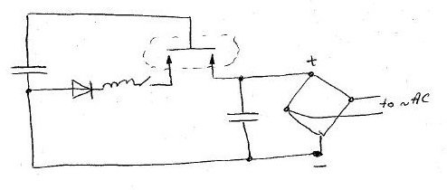

inductive load
Mlurye,Originally posted by mlurye View PostHere is schema the way it supposes to be for inductive load. Aaron you are correct about direction of diode
That is the easiest way I have found and even between the HV cap and that load, the way you show it, there doesn't even have to be a gap there although it can. So 3 points or 2 will work fine.
After more tests, it appears, in my opinion, that this really is the secret to the Gray technology. However, the way that the tube is setup and other components, it just appears that the efficiency of his system is quite a bit higher with everything tuned... cap/coil tuned, super efficient 6khz power supply, etc...Sincerely,

Attached is a drawings of this CSET from what I can make of it by looking at these photos.
Mark McKayAttached Files
