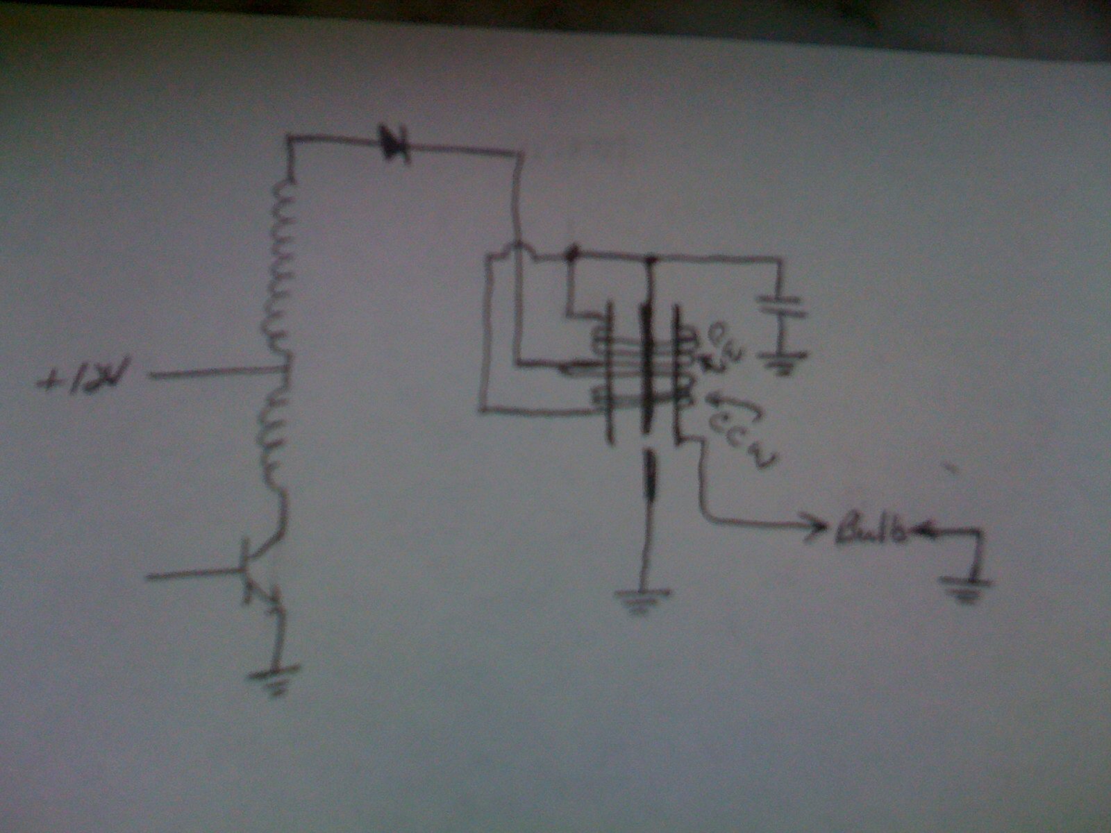

    I know the current drops when I hit the correct freqency, I will have to check the current with and without the fff to see if it's lower.
    The fff is directly connected to the HV supply. In most people's Gray circuit, they connct the HV coil to a rectifier diode, then to a capacitor, and then to the HV rod in the Tube. This fff coil is connected between the HV diode and the Capacitor.
    Freeukpower, thanks for the great info. Do you or anyone you know have an actual schematic of any of Al's work? I see the blueprints and drawings on the some of the pages you describe, but no actual wiring diagram.
    Has anyone seen anybody else got this much continuous output on the grids without arcing? Just curious.
    Also, this goes along with one of the articles I read about Gray's power supply. They said that all the accessories he had attached to the output was wired in series. When I hook two lights up to this in parallel, they "fight" between each other. In other words, they both will not light at the same time. When they're hooked in series, they both light.

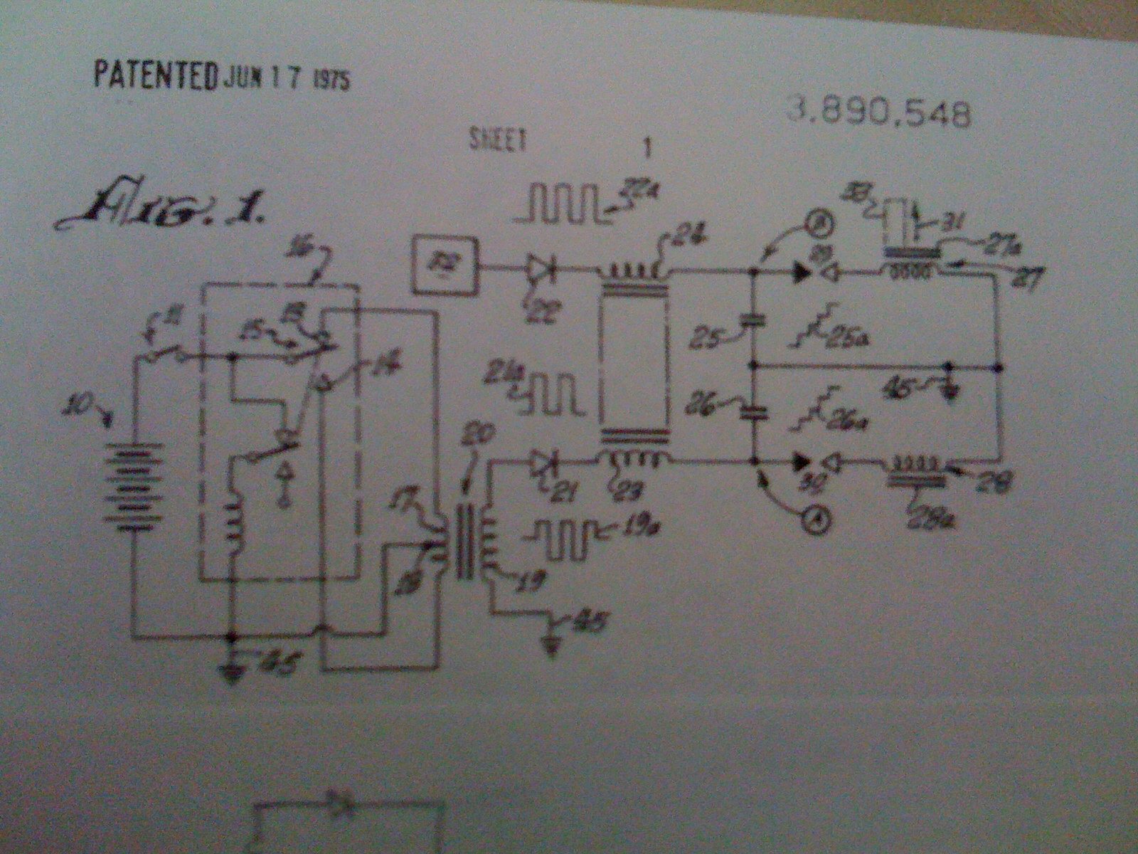

            • plasma ignition patents
              I would recommend that anyone interested in this read all of the content thoroughly. Including how the ignition coils are modified, etc... Basically, secondary has fewer windings than normal. That would bring down the output voltage and allow for higher frequency...no doubt that was what Gray did.
              Also, as far as the concept of the ignition coil being able to spark when there is a cap attached to the output...the whole point of peaking capacitors is that on a single pulse, the cap is charged and the spark jumps the gap. With larger caps, they simply need to be topped off and an ignition coil spark can jump the gap since the cap can't soak up and more and I believe the Gray circuit had to have the caps fully charged to keep up and they only needed to be topped off instead of being fully discharged.

                On the circuit you just posted (002), what do you have driving the power transistor, and how are you adjusting the frequency? I thought you were just driving it with a laser power supply. Doesn't that have a fixed frequency?
                Good job on the flux field idea.

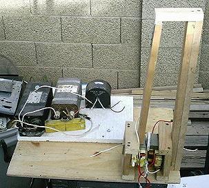

                  I've got a pendulum now, with two MOT coils, so I can try some things. Including my expanded current path in my CSET.
                  • MOT Pendulum
                    Here's a picture of my new setup. The coil on the left weighs 4 pounds. The transformer and cap are 7.5 kV, with the cap at 16.5 uF.

                      Yes, I was until it had a little mishap . If you're going to experiment with different ground potentials, be very careful! I had a big green plasma like arc and somehow got into my power supply and burned the wires up in my soldering iron.
                      Anyway, Gray used ignition coils as well from what Im reading, except they were modified. In his schematic the coil is drawn with a center tapped primary for switching purposes. So I dug around and found an old coil. If I had a spare, Id take it apart and center tap the primary.
                      I looked at my meters on the astron unit, and it says [email protected] amps roughly. The transistor switch Im using is a tip120 darlington from Radio Shack. The source that's driving the transistor is just a 50/50 square wave generator. I can vary the freq from 0 to 100kHz.

                            Thanks. I thought you must have changed something. That's similar to what I'm doing. I'm using 556 into a TIP120 into a 2N3055. But I think we have to get away from the square wave and work towards a short duty cycle pulse. I'm going to run my 556 into a one-shot and see how narrow I can get the pulse and still get a spark. My Radio Shack no longer stocks triacs and mosfets, so I need to look elsewhere.
                            I've tried relays, and they work well but only at low frequencies. I think the tuning of this circuit is very important, and given the low capacitance of the Gray tube, we obviously need relatively high frequency. Sounds like you are in the ball park.

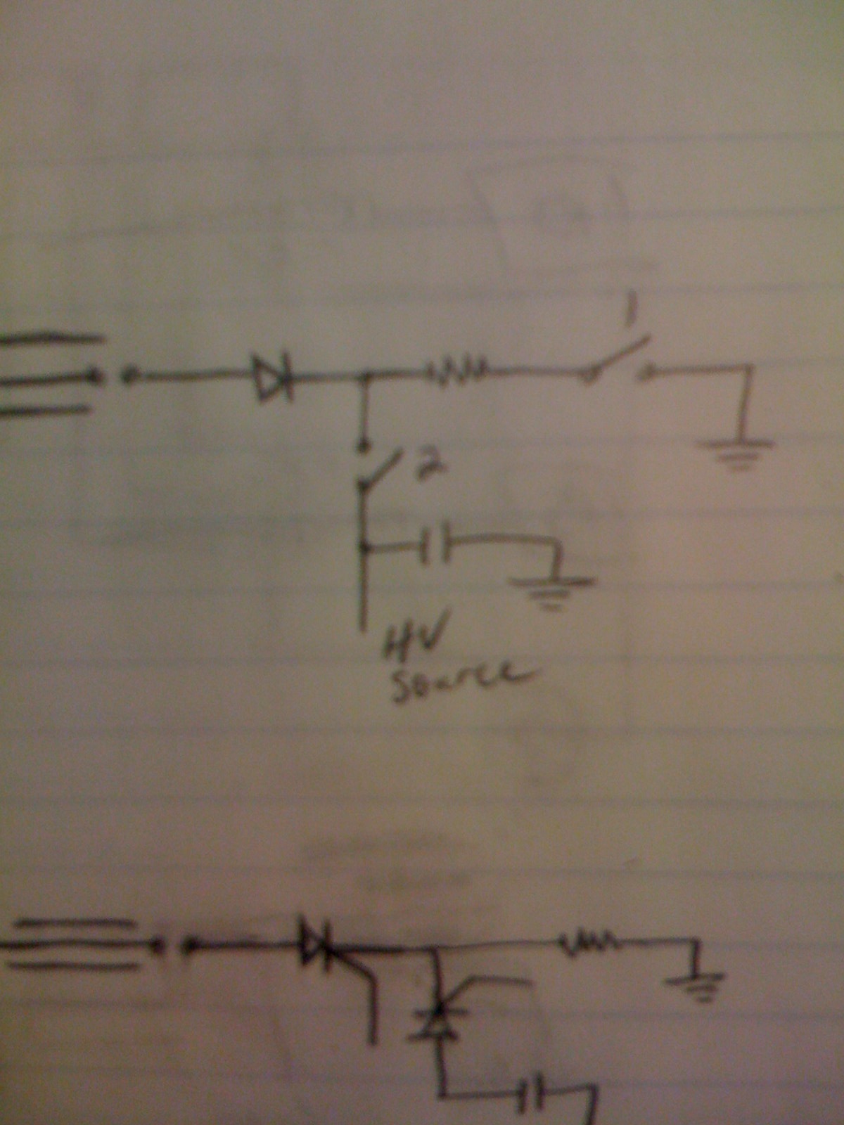

                              I just had an idea, how about something like this circuit. Throw switch #1 to initiate pulse, then "x" amount of time later throw switch #2 with a slight higher voltage to slam and abruptly shut off diode. Theoretically you can control both when and how long the pulse occurs.
                              • i have looked quite closely at the SCR's and they dont switch off very quick. In fact I have already tried an SCR in the circuit a month or so back
