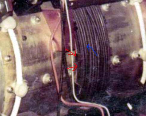

Here is a link to the Motor CSET photo.
Electrotek, yes, according to the patent but that is the only thing that I know of that would bear any resemblance of a cset on the motor. Do you know of anything else that might be a cset that he could be referring to?
