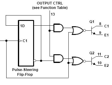

Hi Luc,
Well, you are right on that and I did not really think over the push pull operational needs on the driving signals. What I included in my schematic was a normal inverter stage (as poynt99 also drew it).
I attached a schematic plan that includes two AND and two OR gates and a D flip-flop, all exist in normal CMOS IC types. I took this schematic from the TL494 data sheet, it is part of its inner circuit, named pulse-steering control flip-flop.
If you wish to build this circuit and need help on pin connections and CMOS IC types then I can later do a specific schematic on it, ok?
One question: Among other setups, will you drive also a H-bridge with this LMC555 pulse generator where push-pull drive is also needed?
rgds, Gyula
rgds, Gyula

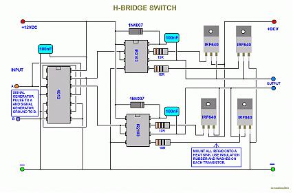

and not because of amps being pulled through since I never needed heat sinks on the mosfet's! I think it was the voltage buildup of the resonating coil (well over 400vpp) coming back in and burning the IR2103's
... any coil will resonate and that was the reason I used the speaker wire to demonstrate that you don't need a special coil as even a roll of clear lamp wire (speaker wire) will resonate.
