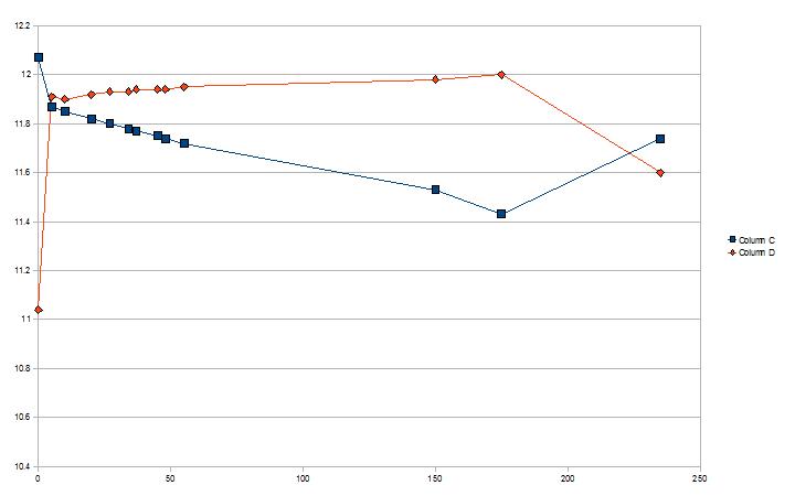

Anyway here's the results of my latest test, check out the graph ive attached:
Time----Run Battery----Charge Battery
0--------12.07--------------11.04 Sitting Voltage
5--------11.87--------------11.91 Start
10-------11.85--------------11.9
25-------11.82--------------11.92
27-------11.80--------------11.93
34-------11.79--------------11.93
37-------11.77--------------11.94
45-------11.75--------------11.94
48-------11.74--------------11.94
55-------11.72--------------11.95
150------11.53--------------11.98
175------11.43--------------12 Stop
235------11.74--------------11.6 Voltage Test 1 hour later
In the graph the Red line is the charge battery, the Blue is the run.
Charge Battery rose 0.56V
Run Battery dropped 0.33V
It seems we got more volts out than we put in, plus a lot of heat and noise was created in the circuit. Promising results for OU so far! will have to do proper load tests..
