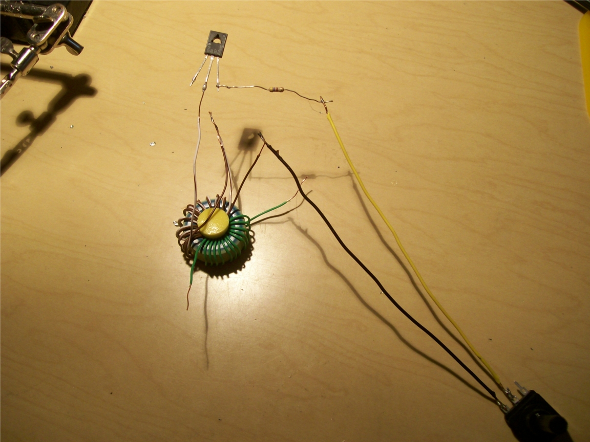

I can't get this one joule thief circuit working, and the other three are working fine.
I have the same number of wraps as my other toroid, but the only difference is I'm using a to126 package transistor instead of a 2n2222 and the toroid is larger than the other one. The to126 package transistor works fine on my others as well. The green coil is for later tests, and the yellow thing in the toroid is a new ear plug to keep the wires in shape.
The potentiometer is a 22k in series with a 470 ohm resistor. Could someone help me out again?

I thought that it might be my other circuit components so I swapped out the coil with my big trifilar that I used in the 'Big Joule Thief'. Everything was ok and the circuit ran fine. Soooo-- I got mad.
The thing should have worked if the theory about WHY it works was correct. I started trying different transistors, resistors and LEDs----the shot gun approach. Just fire a bunch of stuff at it and force it to work!! It finally did but the amp draw was higher than if should be and I fried two transistors. I really don't know why it started working. Sucahyo's ideas are good ones about what to do to get it running. In my case I think that twisting the wires was a mistake and the iron core needed to pickup some kind of field before it would start up. Also I was using clip leads on the long ends of the coil wire. You are right I think that the coil leads should be short and firmly attached somehow. If all else fails, just build another one. About 30% of what I build never works.
