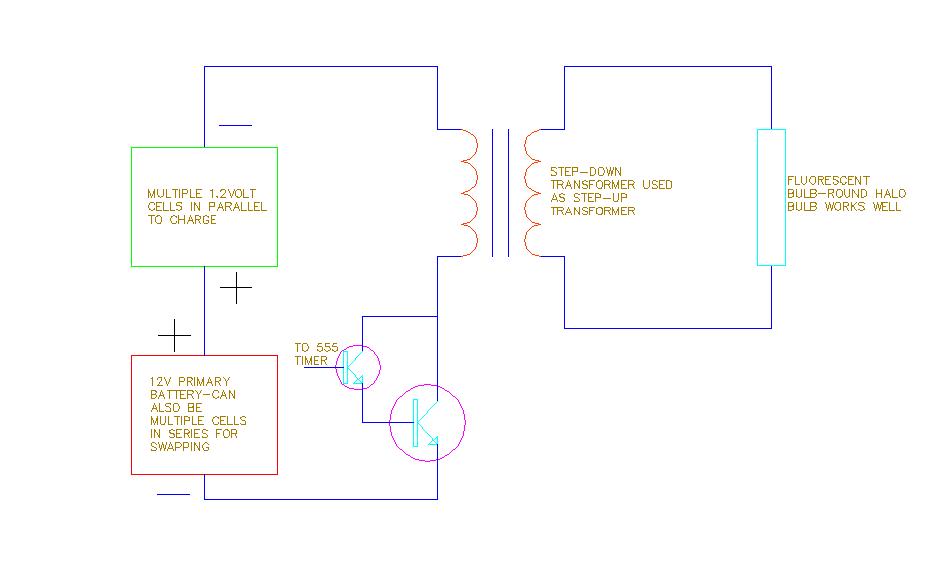

Hi again folks, I was wondering if anyone noticed if the joule thief with typical bifilar wind and secondary high voltage pickup was able to light damaged filament fluoro's as well. I'm currently winding that type because what I've been testing with is the bifilar choke config. with secondary wrapped on outside which I don't think is as efficient. Though also wondering has anyone tried the standard type coil configuration with high voltage secondary pickup wound on a ferrite rod core first then the bifilar JT wind on outside, let me know please. Thanks
