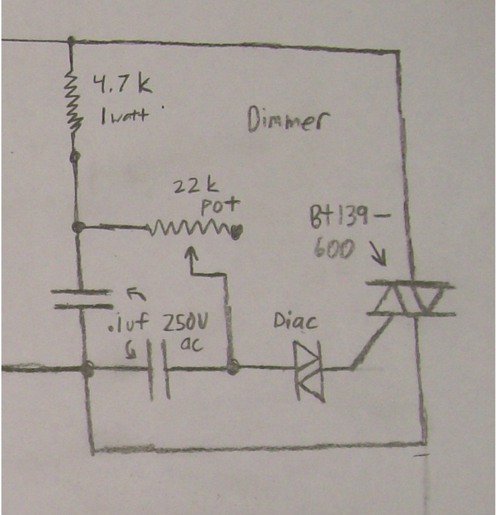

Here is the one I made from scratch, but it doesn't work below 120 watts.
I would like to build one that could run at under 100 watts of current.
(It uses regular 115vac house current at 60hz) I'm also planning on using 220vac with this dimmer as well.
Does this circuit pass for this kind of voltage?

It seems that right when the reaction is at its peak, the power drops off to a point where the dimmer can't run because of the low amp draw.
If it were to function under low current conditions, I think the reaction could be better.

Is this an unfixable trait of triacs? Or can there be a workaround.
