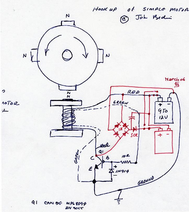

    Scr dump from cap with neon trigger
    I used a circuit with neon to trigger scr to dump from cap into battery but only tried using it with radiant detector circuit. In my case, the radiant just kept flowing without any detectable pulse or triggering of scr? I've been meaning to go back to the circuit, but haven't. Here's a drawing of schematic:

      Hi Ray,
      Ive hooked up like this before. Make sure you check your connections, as it is a little unconventional. The Bridges negative hooks up to the negative of the Running Battery. The positive goes to the capacitor (Use HV low uF, preferably non polar, or Lower Voltage High uF). The other terminal of the capacitor goes to the Negative of the Charging battery AND the positive of the running battery. So essentially the batteries are still hooked up the same but the capacitor stores/converts the spike.
      You will have to look around at your local shop/spot for a suitable scr. If you are going to place an order for something just match Erwins specs, 16 amp 800v SCR. It should have a gate, anode and cathode.
      Your third winding can go straight to the bridge if you llike and you can totally remove your output diode off the transistor. Or there are other ways it could be configured.
