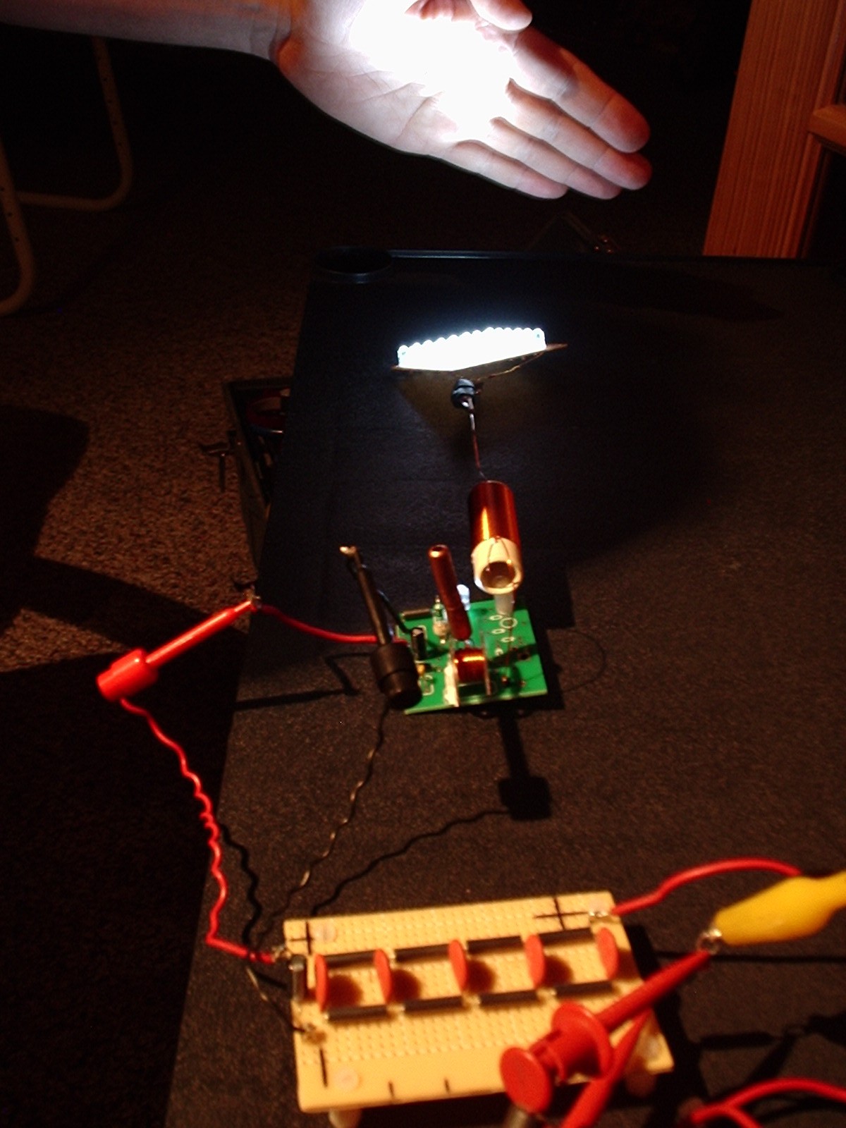

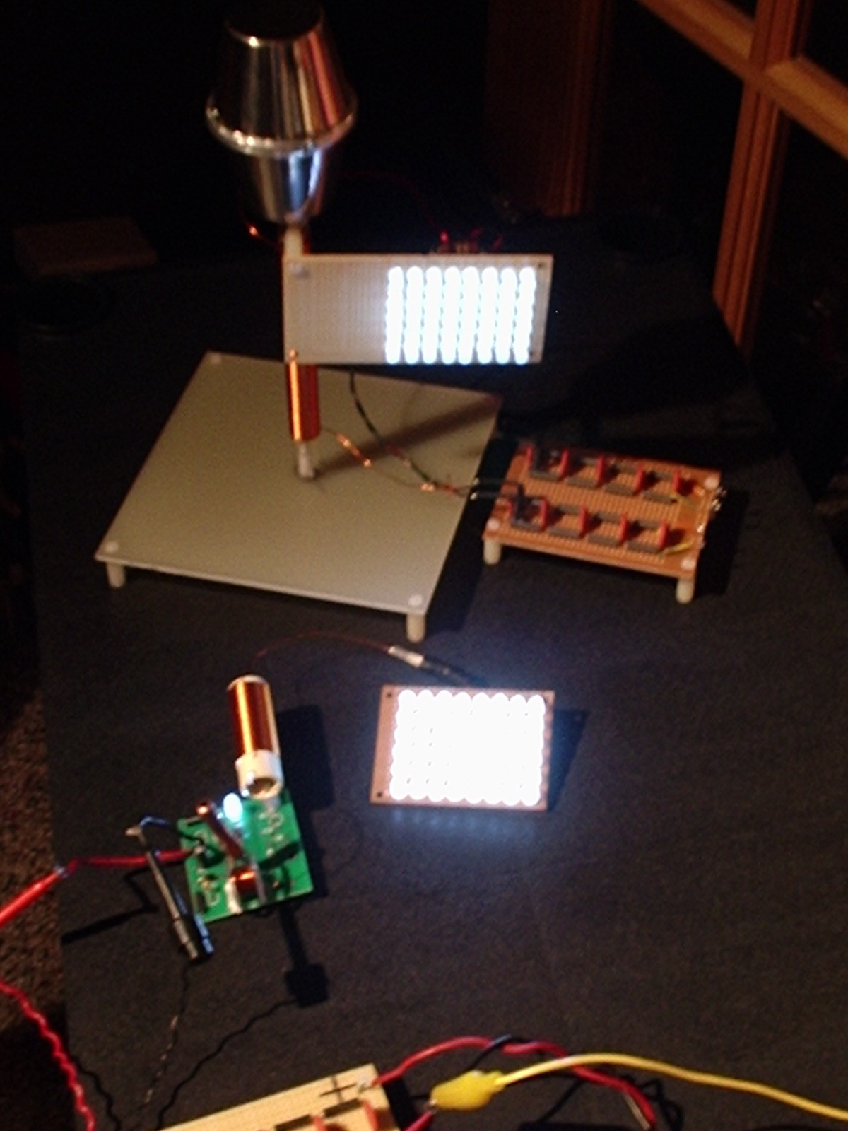

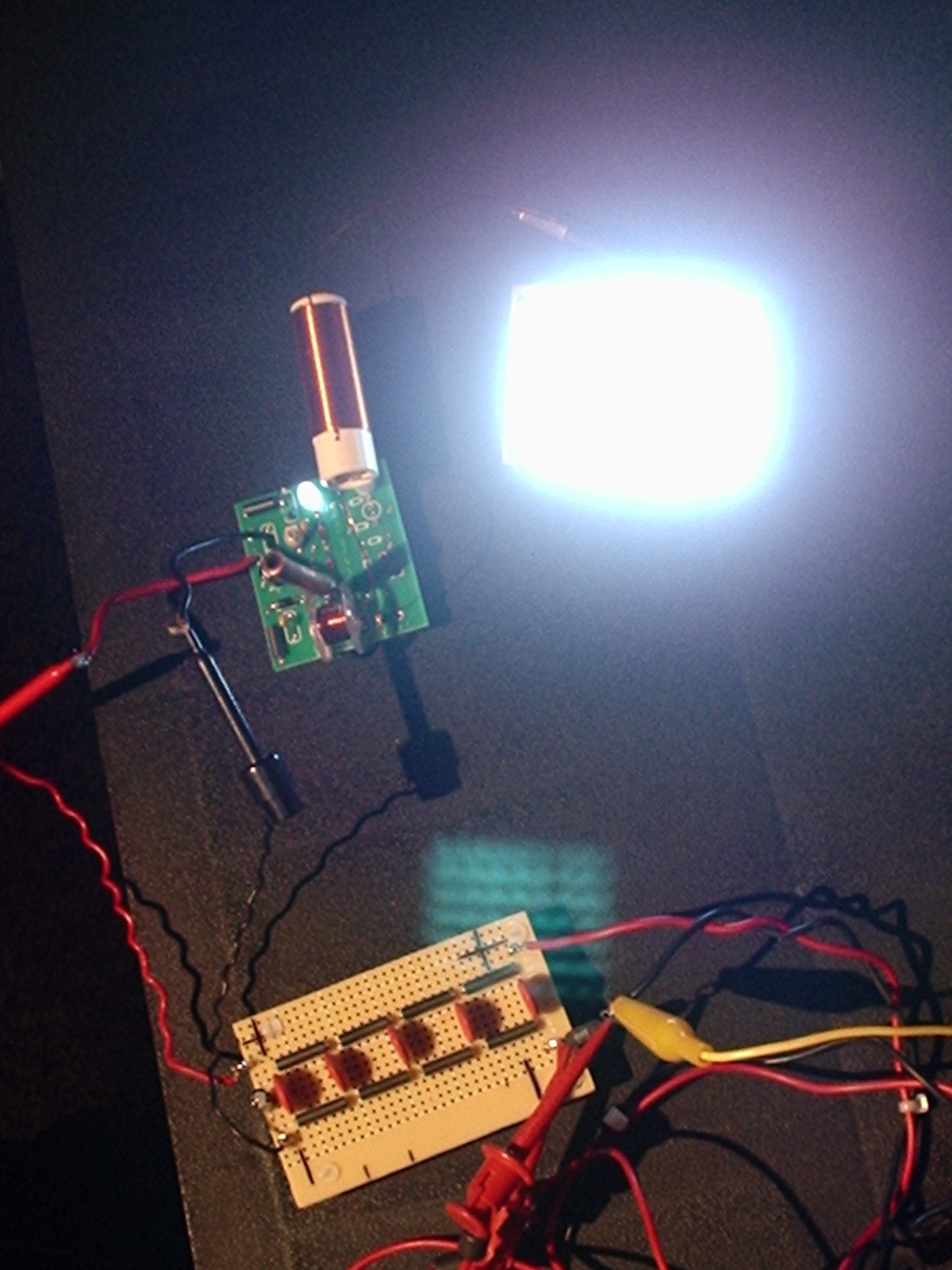

                • I just got my SEC 18-1's and had to fire one up......
                  It didn't take much to get it running and just a very slight tweak of the tuning capacitor and BLINDED BY THE LIGHT!
                  I'm going to try for the self runner............
                  And THEN get number 3 in there......................

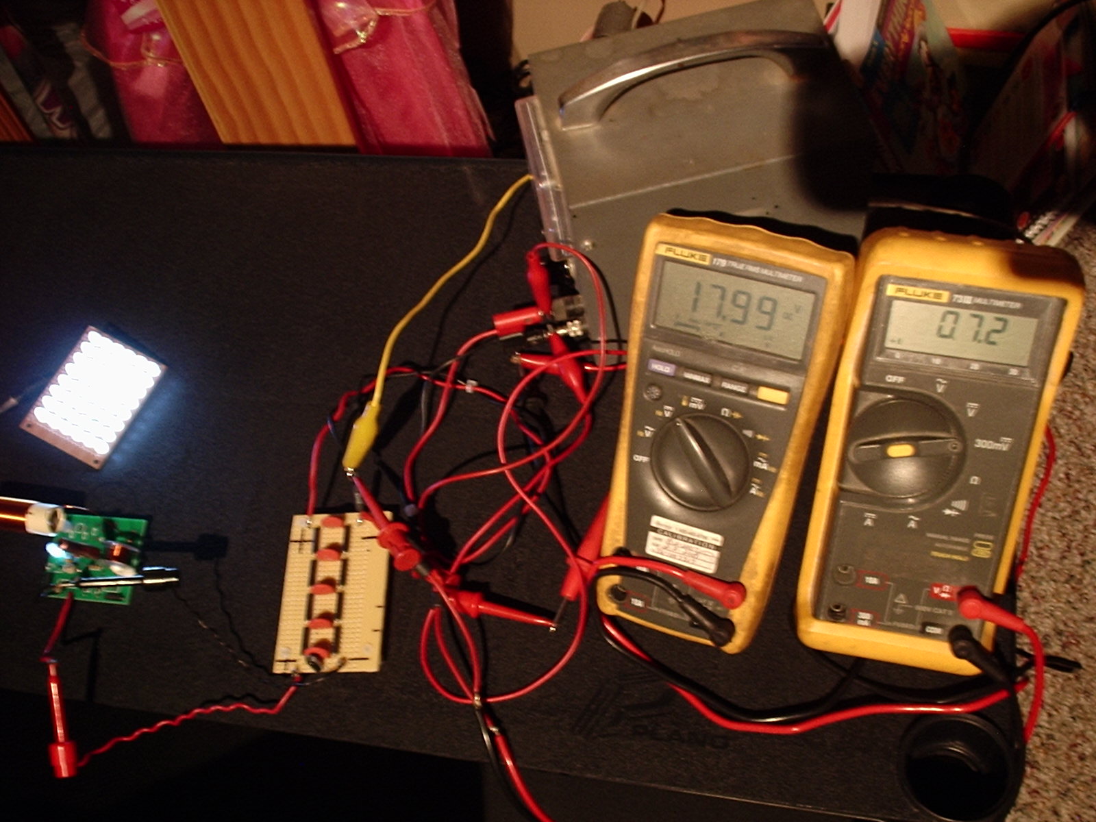

                  In the picture showing the meters 7.2mv is being measured across a 0.2 ohm current sensing resistor in the negative rail of the PS. (7.2E-3 / 0.2) = 0.036 amps. 36 mils at 17.99 volts is 648 mw input power.
                  So we just set the reciever tower on the table and it sat there for awhile then it fired up too.............. I had to shut it down because I HAVE TO GET SOME SLEEP TONIGHT!
                  More to follow,
                  Jim
