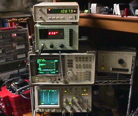

                      • For Loki (Jim)
                        Just wanted to help make your day so thought I would give you a shot of the RF stack
