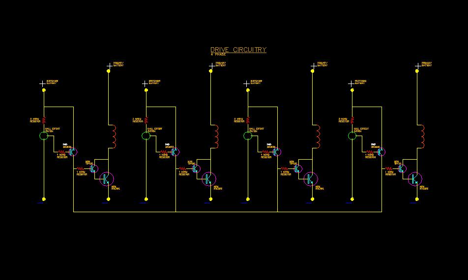

          drive circuit
          Hi folks, heres the 4 phase drive circuit i will be using if anyone is interested.
          1) hall effect-a1101
          2) pnp 2n3906
          3) npn tip120
          4) npn nte392
          peace love light

              Hi Matthew, Nice setup you have there, based on what i can see from pics and graphic pic you are using the odd-even principle by cancelling attraction, so if repulsing when one magnet is repulsed departing another magnet is approaching a coil so no input is needed to remove magnet from core. like the design im building now although it seems youve taken an even simpler route as far as switching goes it seems. So you had 1hp from 250 watts, is it the motor in the pics with the grinding wheel rotors that achieved those results and if so did you use the same fish scale prony method to measure it.
