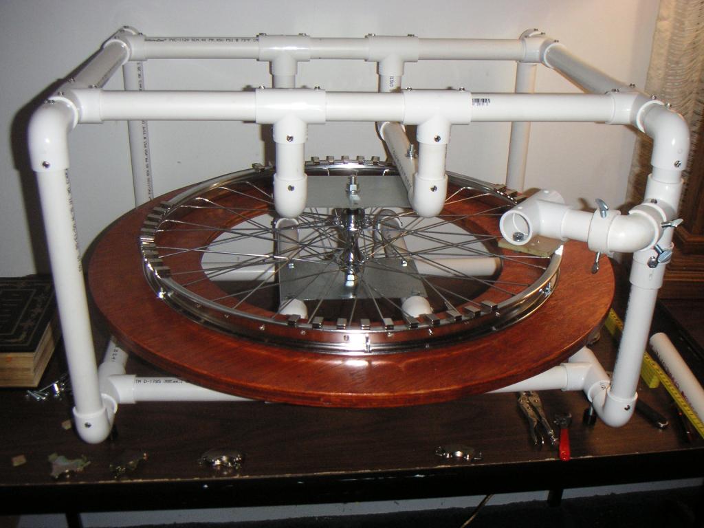

                            • Update and more questions
                              Hi Rick,
                              I will try to include an updated pic of my unit.
                              Questions and problems . First, what are the part #'s or some type of positive ID for the track and rollers that you are trying to use. I spent an hour at Lowes today and didn't find anything made of polyethylene.
                              Second: Stator magnet problem. I have the identical BC62 rim magnets from K&J Magnetics that you purchased for my NEW 26" (22 3/4") wheel. I added a solid 3/4" pine plywood circular flywheel to the bicycle wheel with a 28" diameter and about a six inch width. I have made four groups of ten magnets each spaced evenly at approx. 5/8" around the wheel which gives me a five inch or so space between each group using double magnets for each place. AFAIK, that part is identical to your setup. The gotcha is the stator magnet. Mine was removed from a multi platter SCSI hard drive and measures 3/16" thick and 1 & 3/4" at the furthest points. I also purchased a large lot of sixty HD magnets from ebay and so far have failed to come up with your particular combination of 1/4" thick by 1 & 1/2" end to end.
                              The reason that I state this as a problem is that I am unable to get the rotation that you are attaining. Mine will not move the wheel at all or very slightly at 1 & 3/4" above the rim magnets. When I lower it to and inch or so, it will rotate through a group or two before slowing down and stopping unless I give it a push to get it going, but even then it will slow and stop in less than two or three revolutions when moving the stator. I have changed the spacing from around a half inch up to over an inch, but same result. I feel like the bearing on the new wheel is not as loose as the old wheel although I have loosened it till it's almost sloppy. I may have to remove the grease and add Lubrilon to the bearings, but I can't get that until I get back home in a week or so. The old wheel without the flywheel would move at 1 & 3/4" above the magnets, but not very well. This is very frustrating after watching yours move so easily .
                              If you know where I might find an identical stator magnet to yours I would appreciate it. I bought a couple of special curved magnets that have not arrived yet that may or may not behave better. At some point we will have to be able to find a standardized magnet for the stator.
                              Later,
                              Carl
                              [IMG]c:\UpdRPD01.jpg[/IMG]

                                Hi Carl,
                                Flywheel looks good
                                I didn't include the part numbers yet because I thought I should try out these materials first before recommending that people install them. I purchased everything from McMasterCarr except the rollers, which I found at a local hardware store. The rollers are made by SLIDE-CO and are part # 19507 (comes as a pair). See page 1 of SLIDE-CO catalog at http://www.slide-co.com/scatalog/SC_M.pdf#page=1
                                The polyethelene track material is part # 8702K72 (two 5 ft pieces)
                                McMaster-Carr
                                As to rotor movement, while looking at your photo I began to wonder if you have the stator magnet oriented as shown in the photo while attempting to operate. If so, that's why it doesn't work well. The length of the stator magnet needs to be oriented across the rim rather than in line with it, and the 4 magnet groups must be N-S-N-S. If all of that is right and the rotor still doesn't move well then try attaching a BC62 near each end of the HD magnet. Angle them as if they were the ends of a solid C shape, and place them so the long edge is 3/16" in from the HD magnet ends. This should result in strength centers 1" apart, like with my
                                HD magnet. You can test the repulsion/attraction strength centers by setting up as in my videos 10 through 12, where I had the paper sheet with the alignment markings behind the stator. If they don't work out to be 1" center-to-center, adjust the magnets accordingly and try again. When you get it right, it will work great.
                                BTW, I think your space between magnet groups is more than 5", as mine is a bit more than 8" measured straight-line between the outer corners of the end rotor magnets.
                                Best wishes,
                                Rick
