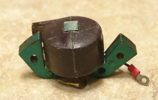

                        • Outboard coil.
                          @Woopy,
                          I pulled an old outboad engine magneto ignition coil from my junk pile, and bench tested it for polarity, jumping a ceramic ring magnet off the stator ends. The coil stator is E shaped with a shared south pole in the middle, that's twice the strength of the two norths on the forked ends. This coil has only two leads like you MO job. I'm going to try and get it to spin a rotor, to see if I can get your flyback circuit to work.

                            • Picture.
                              Here's a picture of the coil.
