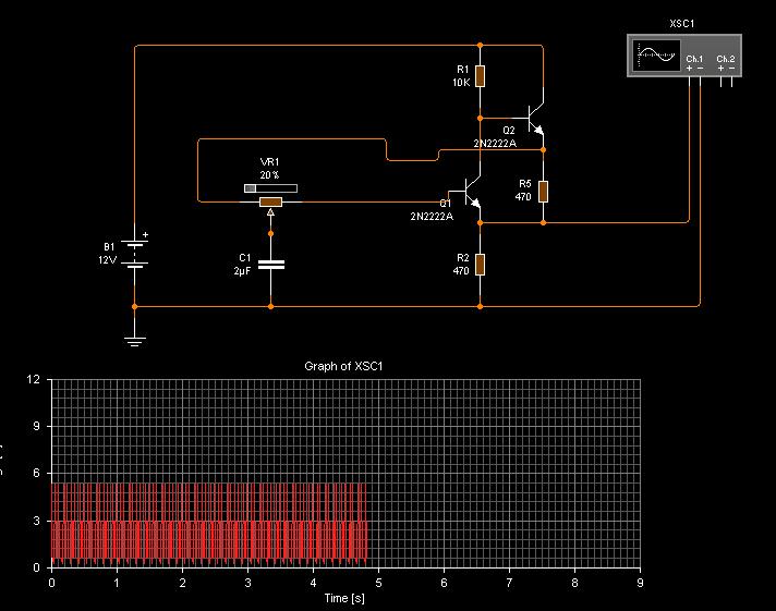

                      Let me correct some. I think inductance on bulbs is not critical for me now, I've remembered some about oscillators with transitors, and yes is possible make a oscilator transistored with capacitors only without coils, but if you want test without bulbs I thinks is possible replace them with graphite rods (pencils), somes normal resistors can be inductives too.
                      Let me show you a schematics that explains how it works a simple transitorized oscillator non inductive only capacitive. You can see how only when current pass throught first transistor (Q2 on sch) cap is charged and when reach the level necessary activates the second transistor and is discharged by B-E of Q1.
                      Steve Jobs. Apple CEO
