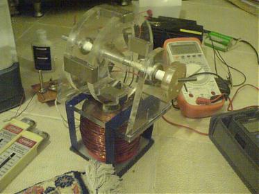

        • #34
          Hello,
          I have managed to build my new SSG with some larger coils than I used to build, and I have got some interesting results, My coil is about 700 turns of #18 wire and are rather big and means alot of copper (to be precise my coil weighs about 3kg, which is a lot more than what most of us use for SSG), but not as big as Newman says. I also used Neo magnets for my rotor, with about 2cm spacing between my coil and magnets. (See the attached photo)
          The interesting result is the mechanical efficiency of the device. As most of you know Bedini motors do not have more that 30% mechanical efficiency and the main drawback is that, but I am happy to announce that my SSG has about 60% efficiency as I measured it yesterday, and That was amazing for me, Because I think that this proves the point Newman is trying to make.
          This is the details:
          Torque rotor diameter: 4.5 cm
          Newton-meter deflection : about 1 N
          RPM: 20 Hz or 1200 min^-1
          Current Draw: about 200mA
          Voltage: about 24V
          W_input = V * I = 4.8 w
          W_ouput = F * d * frequency = 1 * pi * 0.045 * 20 = 2.83 w
          Efficiency = W_output / W_input = 2.83 / 4.8 = 58.9 %
          Please note that I am not using 300 volts as Newman points out.
          But I am getting double the efficiency most people report for SSG, now can you imagine the efficiency if I double or truple the coil size and the input voltage?
          I also tried an experiment lately, which confirms Newman: I used two coils with same wire diameter with one having 300 turns and the other having 600 turns, I applied the same voltage, to both coils, and both of them could exert the same force to a piece of magnet hanging from a Newton-meter. And in fact the second coil consumed two times less power.
          Elias
          http://blog.hexaheart.org
