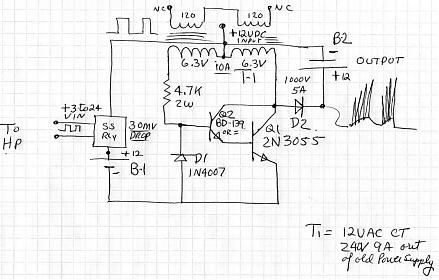

              have taken a lot of efforts to build this charger,, try this one out and i am sure u'll like it.....
              for coils, its much easier to use a center tap 5 amp 12-0-12v transformer,so that u wont need to wind up ur own coils,,,
              and use a 50k 3watt potentiometer with a 100 ohms 1 watt resistor in series....
              and let me know your results...
              thanks

                    Originally posted by dllabarre View Post
                    Please post the schematic here.
                    I can't deal with all the popup ads (BS) from the site you used.
                    Thank you,
                    Copied - at last - below
