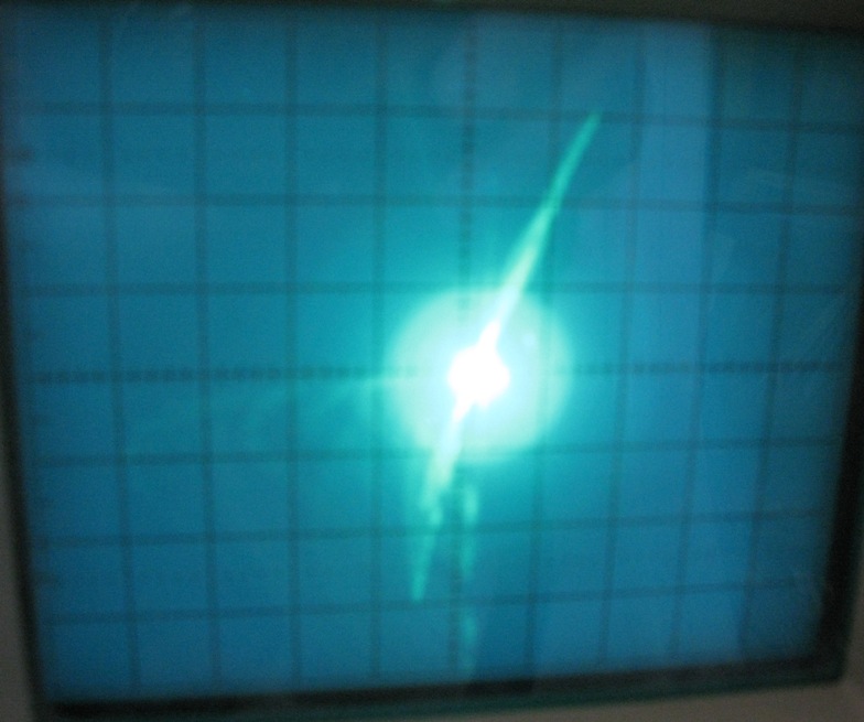

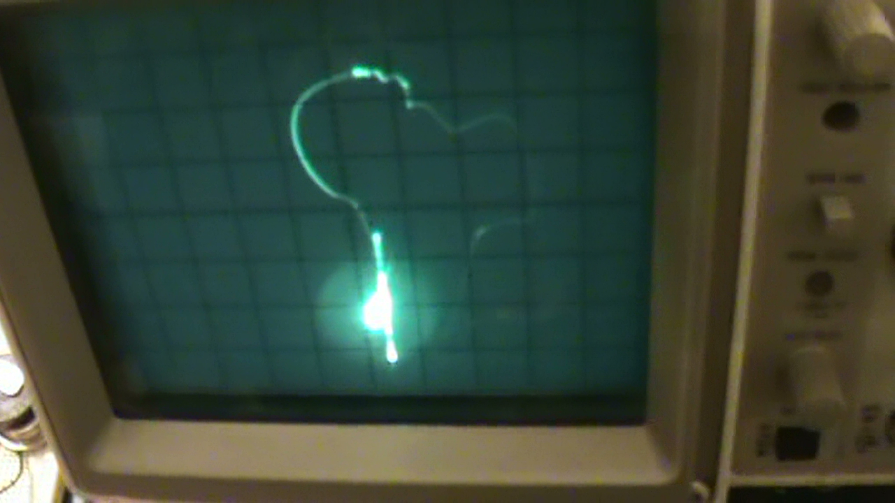

                  • #24
                    Some X-Y screenshots from last-nite
                    These X-Y screen shots show the relationship of the waveform pulsing L2
                    (on X-axis) and the waveform arriving to the bridge-rectifier load (y-axis).
                    One pattern looks like Africa.

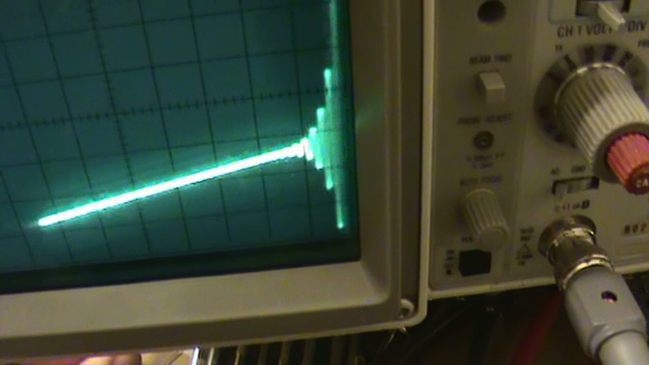

                            • #29
                              source: 1.5V D cell, Load: 2 LEDs
                              Here is a demonstration of running a 12VDC relay and 2 LEDs using the Hendershot-like circuit I'm experimenting with. The power source is a 1.5V D cell and the current draw is less than 30 mA.
                              The relay is 160 ohms, has a pull-in voltage is 9V min, nominal current rating is 75mA. I'm amazed that I can make the relay buzz and drive the 2 LED load using this Hendershot circuit, a D cell and some magnets.
                              YouTube - "Hendershot Fuelless Generator" - 2 LED, 1.5V
                              These results are not unlike what can be obtained with a Joule Thief
                              circuit ... yet this Hendershot circuit is also driving a buzzer with
                              less than 30mA from 1.5v ... that is less than 45mWatts.

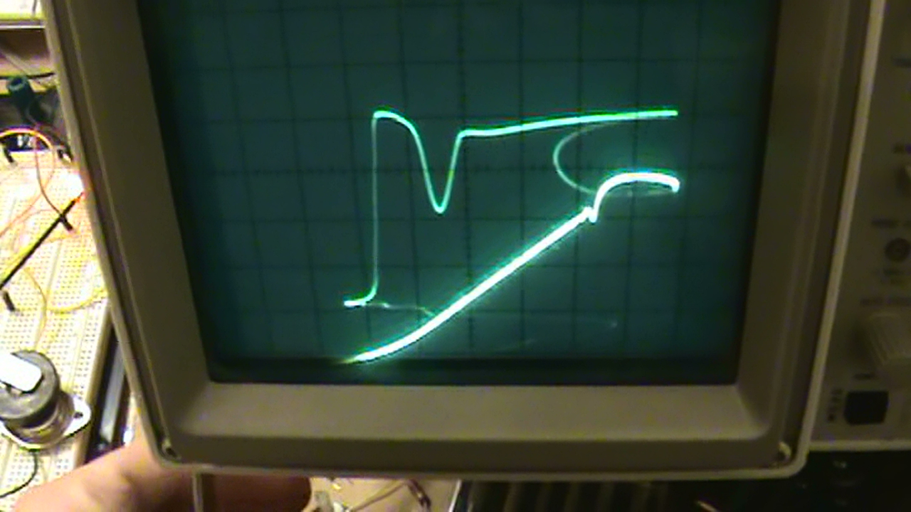

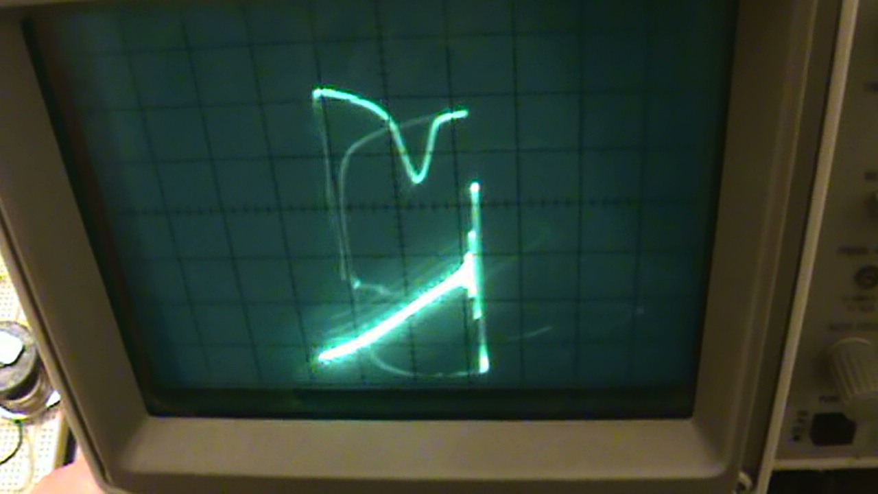

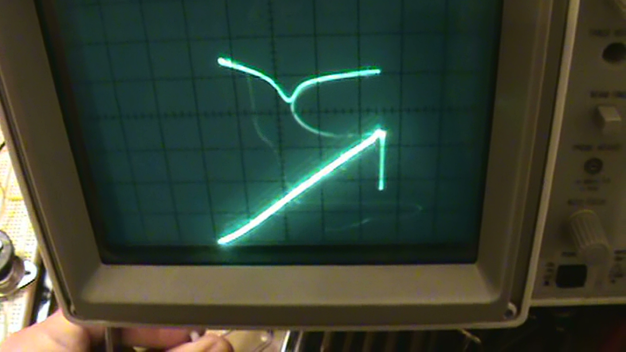

                              • #30
                                X-Y shot when buzzer drives the circuit
                                With the 2-LED load, and the 12VDC relay with magnets attached to the Hendershot circuit, I thought it would be interesting to look at the X-Y plot
                                of L2 relative to L1. On this screenshot of the scope we see L2 on the x-axis at 10 Volts/div. L1 (the tank circuit) is on y-axis at 2 Volts/div.
                                L2 and L1 have a turn ratio that is about 5:1.
                                Notice that the positive x and y quadrant is mostly a straight line
                                as would be expected with a transformer.
                                The negative x and y quadrant, however, is a swirly series of
                                ringing curves, taking up that quadrant.
                                This is a very interesting observation ... which I can't quite understand.
                                The back EMF from the coil as the relay pulls the lever down, disconnecting
                                the 1.5V battery from the solenoid, enters the Hendershot circuit as a negative SPIKE ... subject to lots and lots of jitter. So the energy, and its response on the tank circuit, will jitter around in that quadrant.
                                I would have predicted a fuzzy line ... but this looks very different.
                                It is possible the scope cannot handle this sort of comparison.
                                I read somewhere that the X-Y feature of a scope only
                                functions properly when the waves are sinusoidal.
                                I'm no expert on analog Oscilloscopes so I have no insight
                                if this is so or not.
