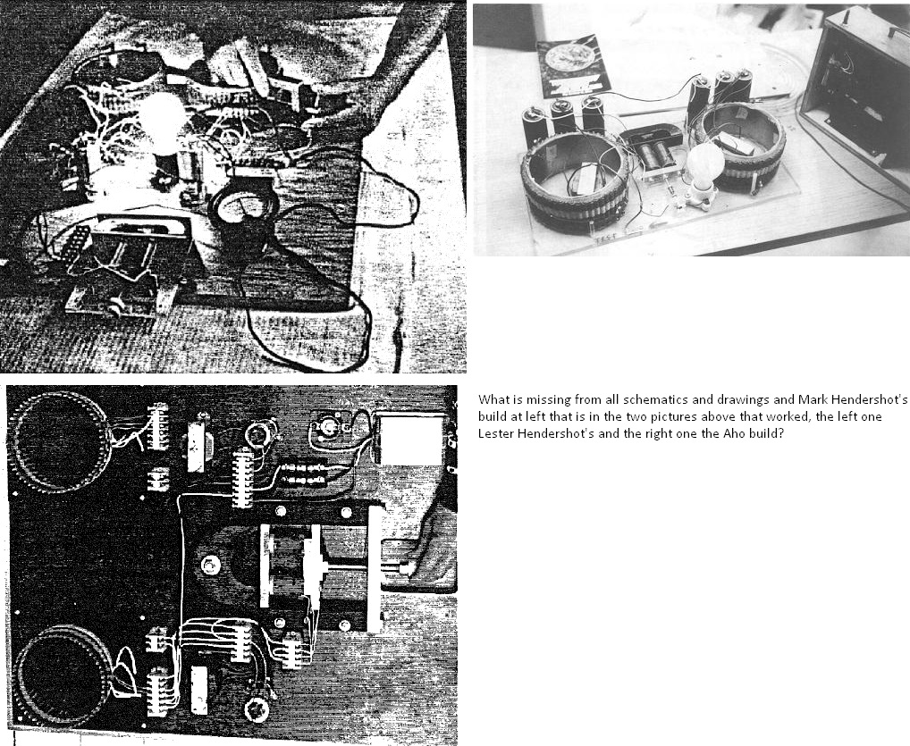

      • What's missing?
        What is missing from all of the schematics and drawings and the builds that don't work that is in the builds of Lester Hendershot and the Aho build that did work? Look at the attached paste up and see if you can see it.
        Then check out the video at the link from 18:30 to 26:00 paying particular attention to what is said at 25:25.

          thx1138,
          Thankyou for the video on the Primer Fields, most excellent material.
          Have had a look at your pictures but unable to see what is missing.
          The top left pic is new to me and unable to see what he has in his hands that he appears to be adjusting.
          The only thing I do see is very sloppy wiring being just all over the place but no distinct or exact organisation in the basic layout.
          My replication is still here waiting on a solution but nothing coming at this point in time.
          Working on the Steven Mark TPU at this time but my version relating to the RCA colour TV implosion and have TV Neck Ferrites which are very similar to the dome magnets in the Primer Fields sitting on the bench.
          Working on pulse drivers at this time using Vacuum Tubes and Delay Lines.
          Would be interested in knowing what it is that you think is missing.

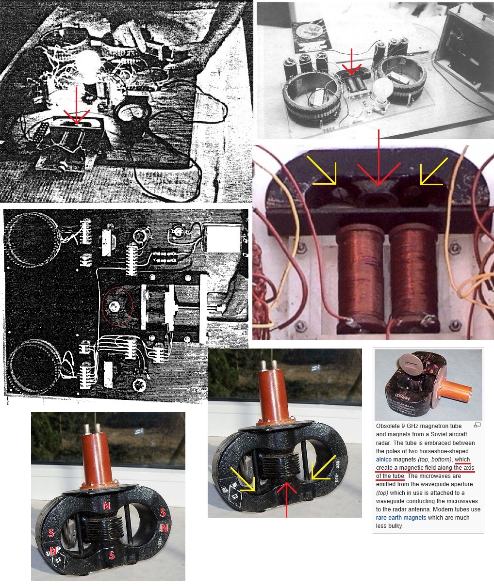

          • Not so much "missing" in as much as placement of components...
            • Not misarranged, but missing all together is the hole and structure around that hole in the center of the magnet. See attachment.
              The reason I mentioned 25:25 in the video is that he says, "The (pulsed) structure of HH 111 does not fit what we would find in an externally electrically driven plasma jet. So I must conclude that the (pulsed) jet of HH 111 is not externally electrically driven." That means the the pulsed jet of HH 111 is driven by the "relief valve chatter" mechanism of the magnetic confinement dome he describes around 22:10.
              The connection regarding the Hendershot device is that the magnet is the only energy source in the device. Granted, the radar magnetron magnets shown below are not bowls but they are somewhat close. If the magentic field of the magnet in the Hendershot device can me made to use that "relief valve chatter" mechanism of the magnetic confinement dome, that would be the source of the alternating electrical field in Hendershot's device. The rest of the electrical circuit is an amplifier and storage device.
              The important question about the "Primer Fields" videos is, how are the bowl shaped magnets magnetized? He never says other than to say they are "specially prepared". The fact that they are painted red and blue does not, however, mean they are monopoles although that works well for his demonstration purposes.
              I remember seeing in one of the Hendershot documents that it was said the magnet was a radar magnet. The magentron shown in the attachment are from a Russian aircraft radar and are slightly different than the Aho magnet around the center. But do note how closely they resemble the Aho magnet and, I suspect, the Lester Hendershot build.
              I have no clue how radar magnetron magnets are magnetized. So the bottom, left image in the attachment is just a guess. They could just as well be polarized with one pole on the outside perimeter and the other on the inside perimeter.
              Another interesting thing in the Wikipedia photo in the attachment is that it says the magnetron magnet is AlNiCo. I don't know if that was ever settled or not - the magnet material.
              So if I am right about this, the reason all the replicaion attempts fail is that everyone is jumping to the conclusion that a normally polarized horseshoe magnet should work. That might not be the case.

                  thx1138,
                  Excellent work and I follow you perfectly after having looked at several of the 'Primer Fields' videos and particularly with respect to the HH 111 pulse stream.
                  Basically a magnet with equal outer Poles the same and the inner the opposite polarity and somewhat shortened in length.
                  This would suggest that the resonator bar across the face of the twin electromagnets would be in a state where balance could be easily upset as the central Pole is not in contact but some distance away - a specific distance might I also add.
                  Wonder now if the iron bar is at the 'flip' distance as shown in the magnet dome experiments and this being from the central Pole.
                  Have not considered this as a 'resonator' feature and might be of help to build a magnet having the features of the 3 Pole and see what we can obtain.
                  Have all the bits here and will set up a Magnet or Ferrite arrangement that might model what you see here and see if we can't get an auto response that will give us some magnet and bar 'chatter'.
