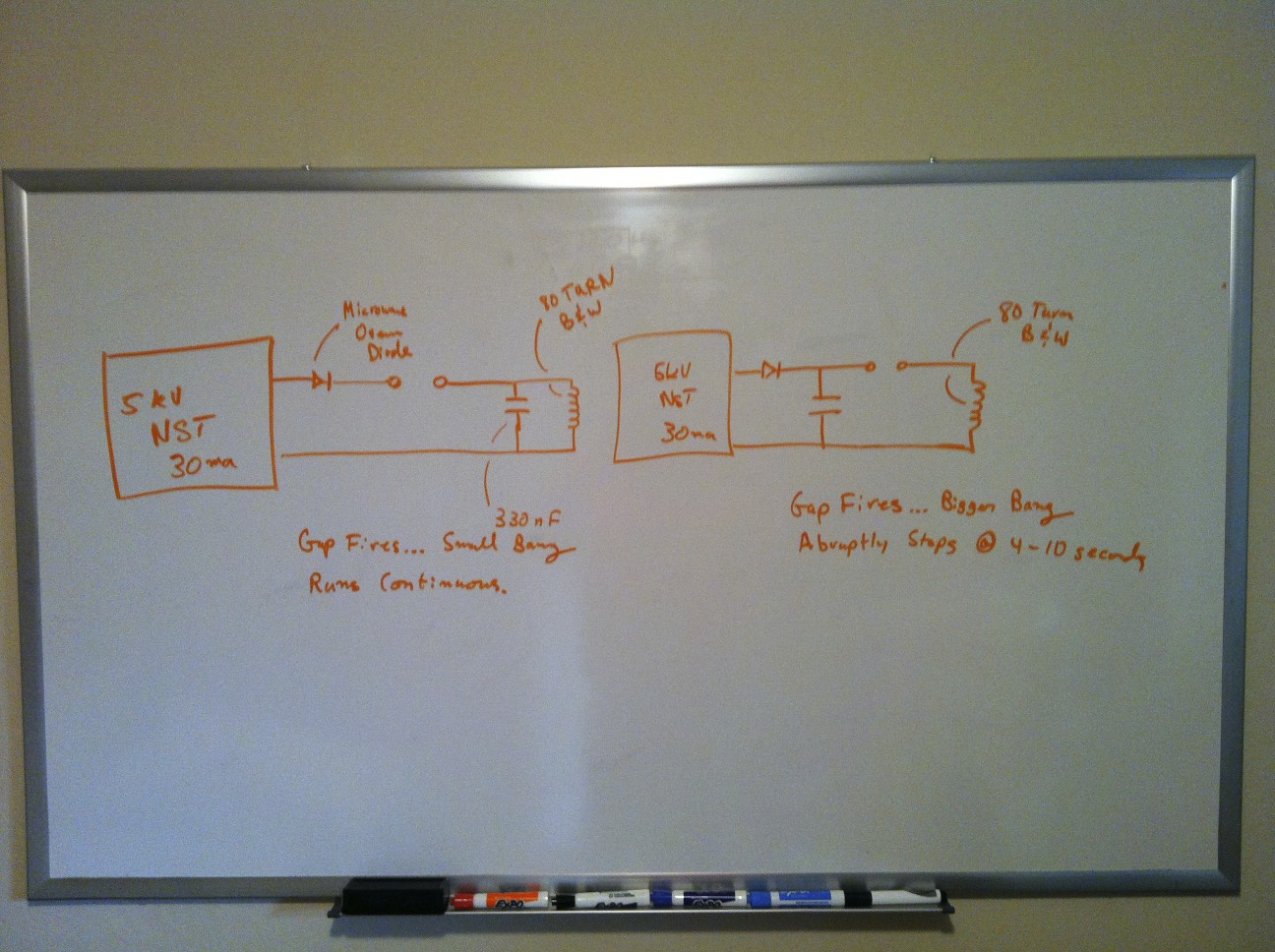

          • Zigging and Zagging
            Hi everyone,
            Just wanted to let you know what I've been up to. I had some success driving my gap / coil combination with a 60Hz 120V:4000V Neon Sign Transformer, so I decided to move further in that direction.
            I got a 10amp RF filter to protect the wall socket and then built a Terry filter and safety gap to protect the NST.
            I got to the point of hooking it all up and realized that the Terry filter needed a good RF ground. So I did some research on RF Grounds.
            I could theoretically put a copper rod in the yard at my apartment complex, but I would need to run a long strip of wide aluminum flashing out to it. All this to protect my crumby iron-cored NST.
            My options were to go back to my flyback transformer, knowing that I needed to improve the efficiency of the driver circuit cause the transistor was overheating, or mess around with a Neon Power Supply again.
            I decided to give the Neon Power Supply another chance.
            It worked. Frankly, I'm baffled. Here is a picture of the two circuits that *worked*.
            I can see that both would send the coil into oscillations, but the one on the right is a "tesla" coil exciter circuit.
            I believe it was drawing more power off of the Neon Power Supply, because after about 10seconds of continuous operation, the circuit stopped. Much like my flyback driver stopped when the transistor overheated.
            So I'm guessing that's what's happening here.
            So, anyway... I've ordered a 60ma Neon Power Supply. It's one of these really fancy ones that has open circuit, open circuit, and GFI protection... so it's just about guaranteed not to work.
            But I was surprised that my NPS actually worked this time. Perhaps I had some bad hookups before that looked like a ground fault to the NPS.
            We'll see. Will keep you in the loop.
            Once I can get this to fire consistently, I'm going to look at the RF coming off the coils on the scope and hopefully tune them up a bit better.
